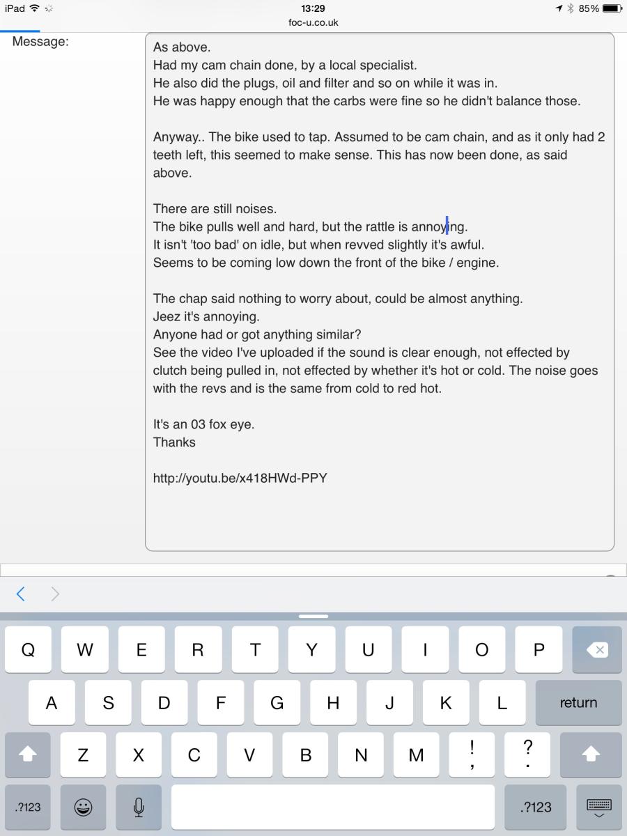

Had my cam chain done but... - davidkent - 17-03-15 Update today: clutch issues? More videos http://youtu.be/x418HWd-PPY Had my cam chain done due a rattle. Seemed obvious as the tensioner was almost near the end. Had a service at the same time all done by a specialist local to me. The bike still taps, I've been told it definitely isn't the chain, it's a more frontal noise low down. Hot or cold makes no odds. It's not that bad on idle, anything more and you can hear it, hopefully it can be heard In the video link. Anyone had anything similar at all? Thanks **excuse the original thread being on an attached picture. This stupid ipad wouldn't submit it and I kept re typing and it wouldn't work so I've posted that, and edited this post to say almost the same thing now. I love technology. Re: Had my cam chain done but... - rhinoeli - 17-03-15 Can't watch your youtube vid. It is private. Re: Had my cam chain done but... - Paulfzs - 17-03-15 as above private video. frontal tick? check header pipes. Re: Had my cam chain done but... - davidkent - 17-03-15 I'll look into that now re video. Check down pipes? I did tighten the nuts up a bit but don't really know what to check for? Cheers Re: Had my cam chain done but... - davidkent - 17-03-15 Video fixed Re: Had my cam chain done but... - Paulfzs - 17-03-15 that sounds like bearings to me :/ Re: Had my cam chain done but... - davidkent - 17-03-15 Bearings? Re: Had my cam chain done but... - davidkent - 17-03-15 The noise started suddenly also, no gentle happening. Just happened one day I started it and it seemed rattly like this Re: Had my cam chain done but... - Paulfzs - 17-03-15 cam chain changed and rattling still, im no mechanic but it sounds bad, the cam chain issue is usually a clicking at tickover then pretty much goes when the throttles open. Re: Had my cam chain done but... - davidkent - 17-03-15 Probably never needed a chain then lol though it was nearing the end of its adjustment. Bummer. Well thats done now, but hopefully this isn't major even though it sounds tobe lol Re: Had my cam chain done but... - Paulfzs - 17-03-15 could be anything, it may go away. im sure someone with more knowledge will post soon Re: Had my cam chain done but... - rhinoeli - 17-03-15 Is it worse or better than before cam chain service? Cam chain fitted properly on camshaft gears? Cam chain length correct? Has the tensioner been cleaned and reset? Anything dropped inside the crankcase? If everything seems ok, maybe you should give it a few redlines and see if it settles. Re: Had my cam chain done but... - davidkent - 17-03-15 It's no worse or no better. No different really. I assumed it was the chain needing doing, and that was the noise. Clearly I was wrong. I didn't do the job but a specialist did. He didn't encounter any problems or nothing that he mentioned. I'd imagine the length is right, though how do you know? How could I even tell this now it's in? I've cleaned and reset the tensioner a few times myself personally. I'd like to think he did it again while he had it out. But even if he hasn't, I did it 100 odd miles previous anyway I redline it regularly, it hasn't settled, and didn't settle when I last rode the bike last summer, before the chain was done only last week Thanks Re: Had my cam chain done but... - rhinoeli - 17-03-15 How many miles on the clock? Re: Had my cam chain done but... - davidkent - 17-03-15 28720 as of today Re: Had my cam chain done but... - rhinoeli - 17-03-15 Any change when clutch is engaged/disengaged? Re: Had my cam chain done but... - davidkent - 17-03-15 No, clutch makes no odds. Originally I thought perhaps related with having the clutch and gubbins apart a while ago, though I'm pretty sure I put it all together fine. When I take the oil cap off with the bike running I can't make out if the noise gets louder or not, it seems to if I'm leaning over the bike and am above, but if knelt next to it I'm not so sure. Re: Had my cam chain done but... - andybesy - 18-03-15 A screwdriver to the engine (in various places) and to the ear may help you track down where it's coming from. Loose valve? A pump? It sounds very regular, where as I thought cam chain tends to be kind of occasional tick mostly when coming off the revs or on idle. Andy Re: Had my cam chain done but... - johnakay - 18-03-15 I know its a long shot.. have you fitted an aftermarket down pipe? I had one on my thundercat and that made a tapping noise which wouldn't go away. it turned out that the shock waves or what ever was hitting the thin walled s/steel pipes making it sound like a tapping noise. had that bike 4 years after the tapping noise was notice. and the bike is still on the road. Re: Had my cam chain done but... - davidkent - 18-03-15 Well Trybthe screwdriver later ![]() It has stainless downpipes which were on it when I bought it however it didn't make the noise for the first year of ownership :/ |
