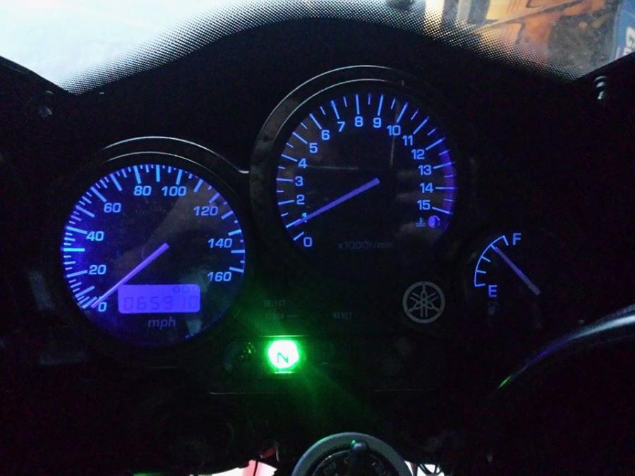

clock lights - h7thl - 10-02-15 how easy/hard is it to change the bulbs in the clocks of a fazer 5dm Re: clock lights - RMT1983 - 10-02-15 Very!!! Re: clock lights - emjaydee - 10-02-15 Very nice and bright. I've got blue LEDs but they are not that bright. What bulbs did you use? Re: clock lights - RMT1983 - 11-02-15 http://www.ebay.co.uk/itm/10-X-Car-T5-73-74-286-Dashboard-LED-Blue-Light-Bulb-Lamp-12V-Replacement-/150883080891?pt=LH_DefaultDomain_3&hash=item2321551abb Re: clock lights - the cueball - 17-02-15 (10-02-15, 10:00 PM)h7thl link Wrote:how easy/hard is it to change the bulbs in the clocks of a fazer 5dm it's quite easy, there are 3 bolts at the back of the into to take off, then unplug it from the bike. after that, 8 screws take apart the actual housing and the 4 bulbs are in there, all with a yellow dot on them. twist to remove, change over, then put it all back together again. The bulbs I got off ebay are 'sided' so I needed to test them and change a few around... but they look good! the only issue I have now, is my speedo has stopped working! :'( :'(
