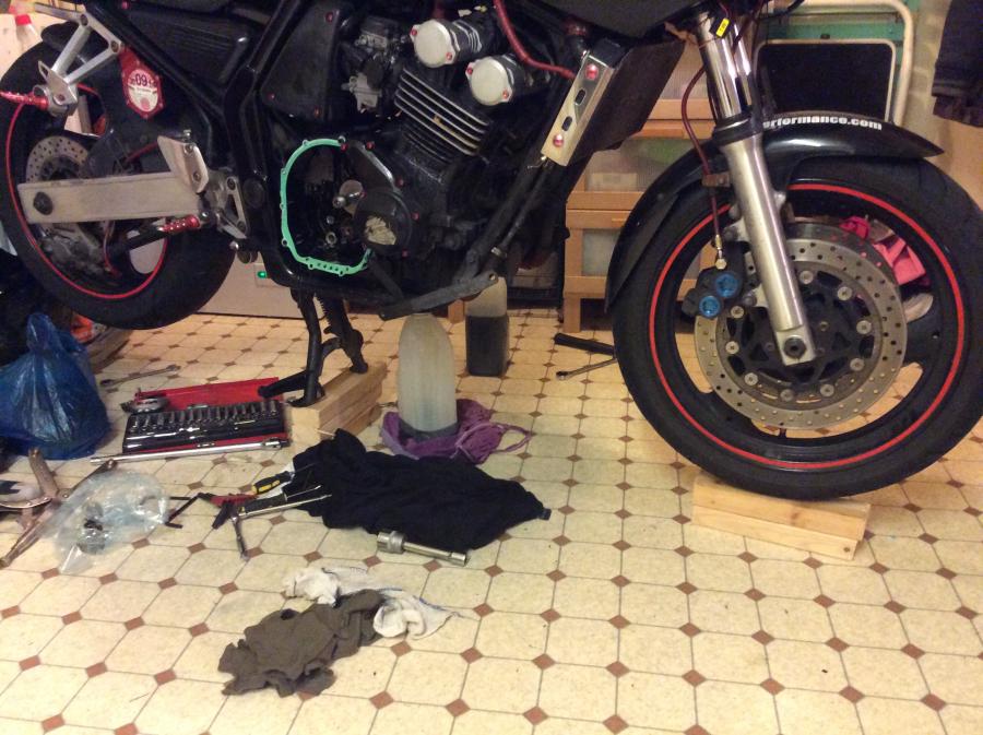

Right I'm finally tackling it! Due to being really skint I couldn't just fork out (forgive the pun) for a whole gear box to get my selector forks but I spotted a set of all three off eBay for a tenner and the drum I had bought already for around the same so for around £50 including gaskets and oil I should be all sorted.
I didn't want to have my engine open over night in the damp which has been another thing slowing me down so I brought the bike into my kitchen lol, girlfriend not bothered oddly....
So far it's all going well so I've stopped for some spaghetti bolognaise and a glass of wine or two, getting the bike up was a bit unnerving and I'm not going to enjoy being under it but sod it I'm sick of my Citroen berlingo and this was my only solution.

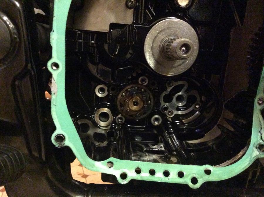

I've got a query for anyone who's done this before and that is how do I get the drum out? I've been wiggling and everything but it won't budge, is it accessed from underneath once the sump's off?

Yes, the drum slides out of the side once you've got the selector forks out, to do that you'll need the sump off.

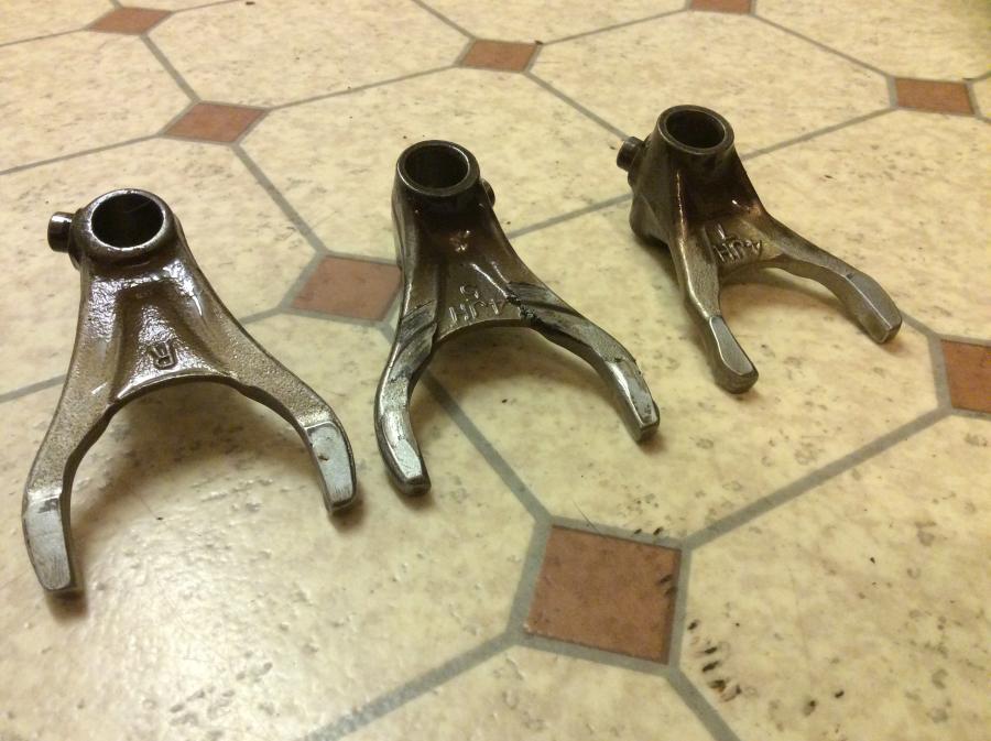

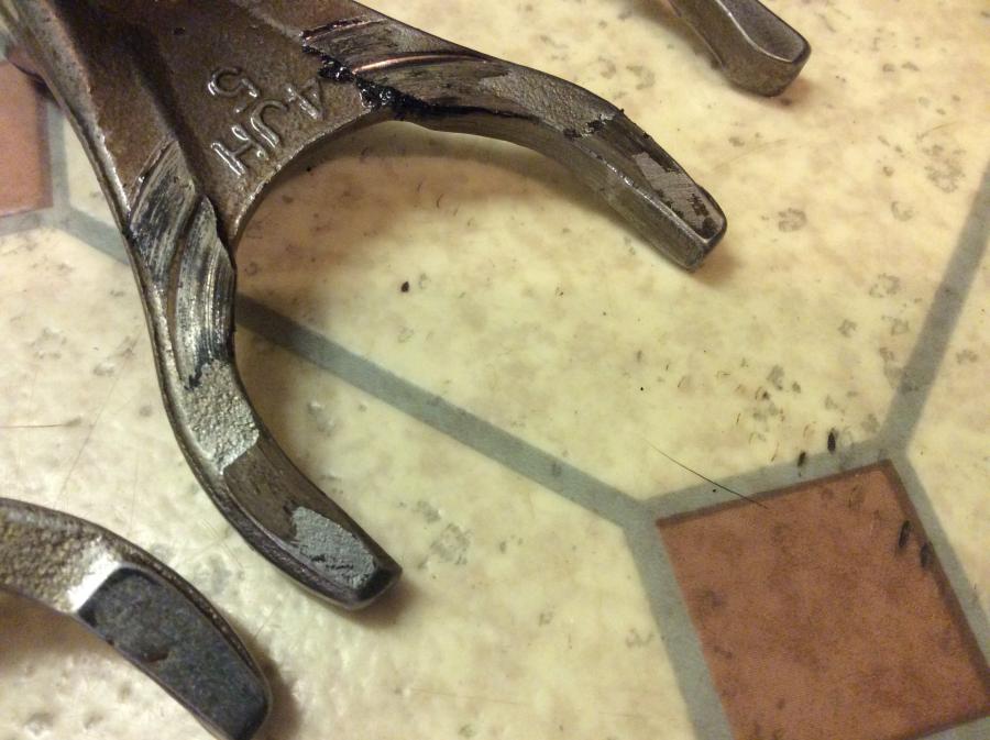

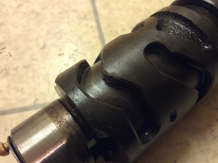

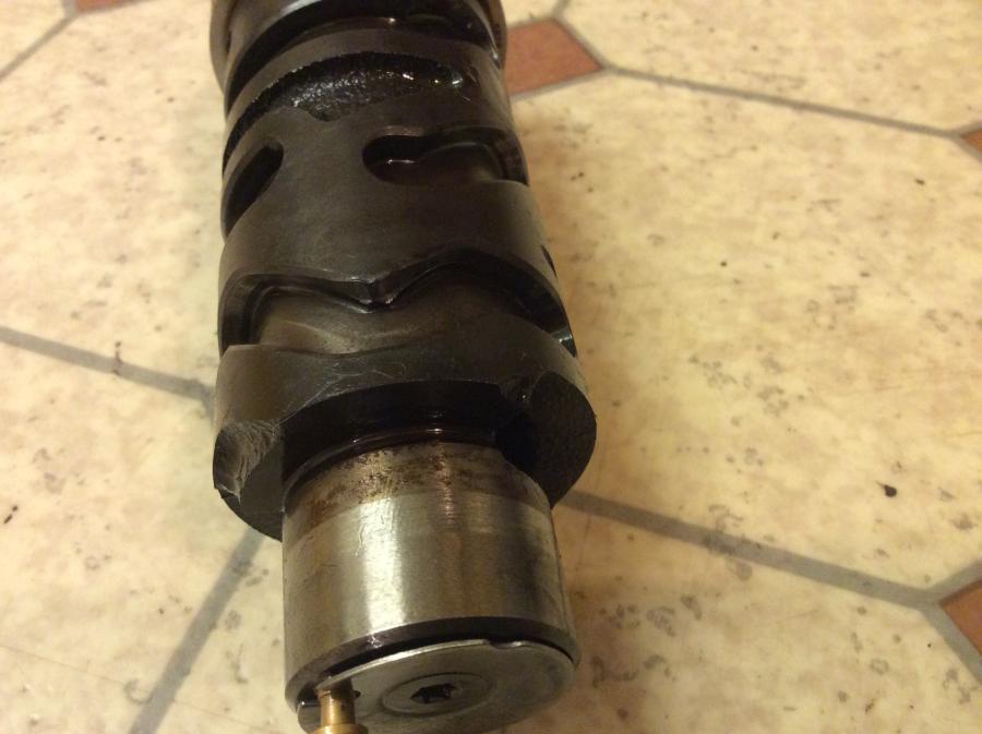

Ok so I got the forks and drum out, both look foc'd so that's good, is the damage on the track of the drum the track which relates to 2nd gear and the left fork? I didn't pay attention which fork was where (Oooopppps) and I broke the oil senser in the sump trying to put it out, lucky I'm off to fowlers in the morning for a gasket anyway. Putting it all back together looks bloody impossible in terms of getting the forks and drum in place, might leave it till tomorrow when the light is better. More wine now needed as my chest deflates from being so ace lol. Can't wait to get back on the road! Did my chain and sproket yesterday so after this just fork seals and the thing works again!
