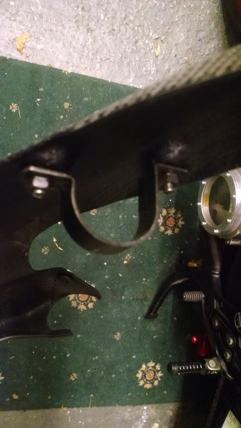

Re: Genuine Yamaha fazer 1000 fzs 1000 silver storm belly pan - Mick-H - 17-01-15

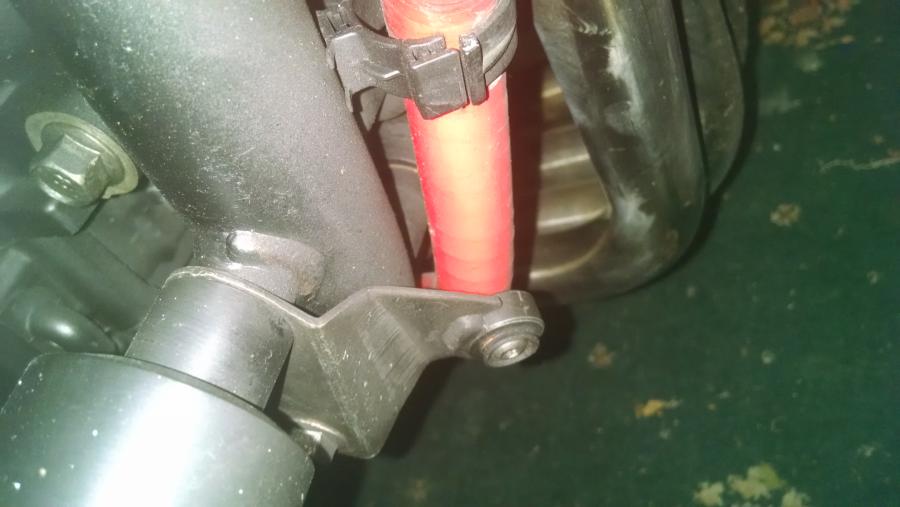

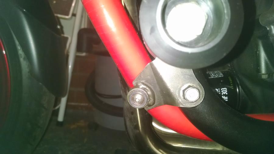

Just done these, give rough idea if nowt else.
Re: Genuine Yamaha fazer 1000 fzs 1000 silver storm belly pan - Tuckerhauser - 17-01-15
Thanks for images of the mounts, I'll be making some soon once my pan arrives:-)

Re: Genuine Yamaha fazer 1000 fzs 1000 silver storm belly pan - b1k3rdude - 22-01-15
@MickH, spot-on mister. But I would advise anyone fitting a gen BP to place some thin rubber strips under the brackets that bolt to the frame tubes to prevent chaffing.
