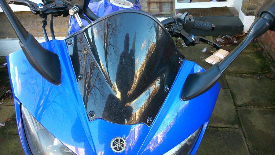

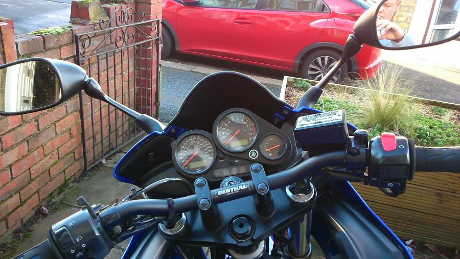

streetfighter screen - jimmyjimjims - 24-10-14 Quite lije the look of these but cant seem to find anywhere that swlls them Does anyone have a link or something to help me find one Cheers Re: streetfighter screen - stevierst - 24-10-14 There's various screens you can put on a fighter, it all depends on what your going to mount it to. Headlight, or forks, bars or top yoke? To start off have a shop around on eBay for universal screens, there's loads. Re: streetfighter screen - jimmyjimjims - 24-10-14 [smg id=2317 type=preview align=center caption="19112011192a"]i think you've misunderstood stevierst mine is still standard i mean the actual screen itself. Apparently there is a "streetfighter" screen available that is shorter. Re: streetfighter screen - Tmation - 24-10-14 If you can't find a street fighter screen, get a second hand standard one from eBay and cut it down with a dremel or similar. (thats what I did) Take your time otherwise the plastic melts instead of cutting, Halfords sell screen trim to finish it off, you can also spray the inside of the screen black. If you don't spend long periods above 70 mph or do long motorway journeys it's a very good screen with very little noise. Re: streetfighter screen - jimmyjimjims - 24-10-14 Thanks tnation thats exactly what I was thinking. Only problem i have now is my screen is a puig double bubble and it'll look odd so its gonna have to be a standard item Re: streetfighter screen - BMCfaz - 24-10-14 I cut down a d/b screen and it works for me. The remains of the bubble deflects the air up, and i don't notice much difference from a standard screen. BTW, I do quite a few motorway runs and it's fine, depends how tall you are. Re: streetfighter screen - stevierst - 24-10-14 (24-10-14, 01:28 PM)jimmyjimjims link Wrote: [smg id=2317 type=preview align=center caption="19112011192a"]i think you've misunderstood stevierst mine is still standard i mean the actual screen itself. Apparently there is a "streetfighter" screen available that is shorter. Aah, right. I thought they were normally called stubby screens. Had one on my gen II until I sold it. A streetfighter to me is a customised bike with no fairing, but then I'm old school. My last screen I chopped down was a d/b and didn't look too bad. (speed up the cutting process by using a wood saw. I Shit ye not!!!) [ can't post photo for some reason;D ] Re: streetfighter screen - stevierst - 24-10-14 There we go. Re: streetfighter screen - jimmyjimjims - 24-10-14 Oooo the db doesnt look too bad does it. Looks like I'll be butchering mine tomorrow. Thanks for the replies Re: streetfighter screen - clanadam - 25-10-14 Is no one else asking WTF is going on with the polar bear? :eek Re: streetfighter screen - robin78842 - 25-10-14 Not sure. I think Polar bear is riding a Sheep or may be a Donkey.. Re: streetfighter screen - jimmyjimjims - 25-10-14 BMCfaz how did you get the right radius on the curve? I was thinking maybe a steel or plastic ruler? Re: streetfighter screen - stevierst - 25-10-14 You can draw it on a paper template, then stick it to your screen. Or measure it out in the screen from a known datum point using a makeshift compass (string and marker pen). Or use a decorators profile tool. Done a few of them now in different forms, shapes and curvatures. Just make sure you measure twice, cut once. And don't be afraid to get the wood saw out. I'm deadly serious, as long as your gentle, it leaves a cleaner cut than hack saws or rotary blades as it doesn't heat up the material to melting point. Re: streetfighter screen - red98 - 25-10-14 make a paper template,fold the paper in half and draw the shape required,just half of it and when you open it up it will be symmertrical,transfer this to the screen.....as stevierst....measure twice cut once.....make a few out of an old cereal box or similar untill your happy with the shape ... Re: streetfighter screen - jimmyjimjims - 25-10-14 [smg id=2319 type=preview align=center caption="20141025 134359"] [smg id=2318 type=preview align=center caption="20141025 134412"] Right then.......... i used a peice of string and a marker pen to get the same radius from the bottom/centre of the screen. Then used a grinder to cut/melt away the upper portion and tidy up towards the uppermost part of the mark pen line. Then a sharp knife scraped along the edges to bevel and tidy the new edge........20 mins ![]() Re: streetfighter screen - stevierst - 25-10-14 Good work 8) Re: streetfighter screen - jimmyjimjims - 25-10-14 [smg id=2321 type=preview align=center caption="20141016 142636"] [smg id=2320 type=preview align=center caption="20141025 165320"] Re: streetfighter screen - jimmyjimjims - 25-10-14 Why upside down?? Lol Re: streetfighter screen - BMCfaz - 26-10-14 I fitted the screen and marked out the shape I wanted with masking tape, took the screen off and cut it using a Dremel-type tool. I used the line of the fairing for the initial line on the screen, then developed the curve from that. No measuring as such, and dead simple. A bit of screen trim finished it off. Re: streetfighter screen - R1FSR - 31-10-14 I did the same with mine many months ago but I used the original screen I had as a template . its slightly taller the 'fighter screen but shorter than the standard. P.S Just got another blue screen from hong kong £13 delivered ..bargain. ![]() ![]()
