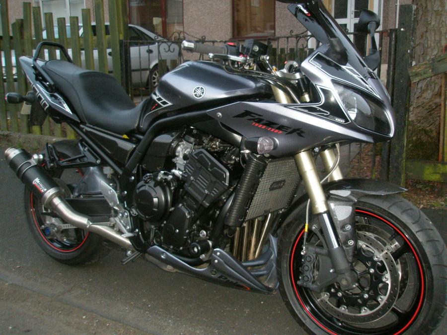

Re: R1 Front End Cost Estimates - nickodemon - 25-10-14 I will look out the total costs for my 4c8 front end, but i remember most of the costs.. So i should only be out a max of £50 4C8 forks and yokes £300, radial calipers £100, wheel and discs £120, steering stem made in America $100 + shipping and import duties worked out abot £100,steering head bearings £35, Lsl top yoke rl 2002/3) £120, Bottom yoke (r1 2002/3) £30,R1 carbon front mudguard £70. Total £875. I sold the R1 yokes to get some money back And i sill have the original front end i could sell if i needed to. Here is a pic Re: R1 Front End Cost Estimates - Stupid Luke - 25-10-14 Thanks Nick, That looks great and I would be happy to spend that sort of money on mine. Once it starts getting up over a grand though I tend to favour using the early R1 forks to keep costs down. I guess I will have to keep watching e bay for suitable yokes and haggle hard on the rest. Is the the guy that did your steering stem still around and does he do them to order. It may be that I could get that made now so that it is one less thing to wait for when I start getting bits together. Re: R1 Front End Cost Estimates - nickodemon - 25-10-14 Hi Luke, here is the thread for the steering stem. The guy you want to contact is brian g (who makes them) There are several pages on how it was made and how to fit. http://www.yamahafz1oa.com/forum/showthread.php?t=131607&highlight=steering+stem Re: R1 Front End Cost Estimates - nick crisp - 25-10-14 (25-10-14, 11:37 AM)nickodemon link Wrote: I will look out the total costs for my 4c8 front end, but i remember most of the costs.. So i should only be out a max of £50 4C8 forks and yokes £300, radial calipers £100, wheel and discs £120, steering stem made in America $100 + shipping and import duties worked out abot £100,steering head bearings £35, Lsl top yoke rl 2002/3) £120, Bottom yoke (r1 2002/3) £30,R1 carbon front mudguard £70. Total £875. I sold the R1 yokes to get some money back And i sill have the original front end i could sell if i needed to. Here is a pic Looks great Nick :thumbup The gold on the forks lifts the look of yours nicely, but would look terrible with the bright yellow paint on mine. Very pleased to say I have bought some black 2003 forks (with K-Tech internals, don't know yet whether that's gonna be a good thing as I don't know if they're parts more suitable for R1 use, but can always change them) from Luke - bloody good man as always! ![]() Have you any kind of ride-height compensation on there, or wasn't it necessary with the later set-up? I'm a little concerned that having the lower ride height of uncompensated forks might throw a bit more weight on my dodgy shoulder. Dropping the bike 10mm on the standard forks hasn't caused me any grief though. Got to let Luke know if I want the adjusters. Re: R1 Front End Cost Estimates - nickodemon - 25-10-14 my bike has an r6 rear shock with dog bones to match the original ride height and the front end is slightly lower (Not Too Much tho) The 2007-8 R1 forks are shorter than the fazers but the steering angle is steeper to compensate a little. Handling is sublime. Gets better the faster you go it has completely changed my fazer into a very modern handling and braking bike. Well worth doing the R1 front end mod no matter, which model of R1 front end you use. (The later the better, but more expensive)
