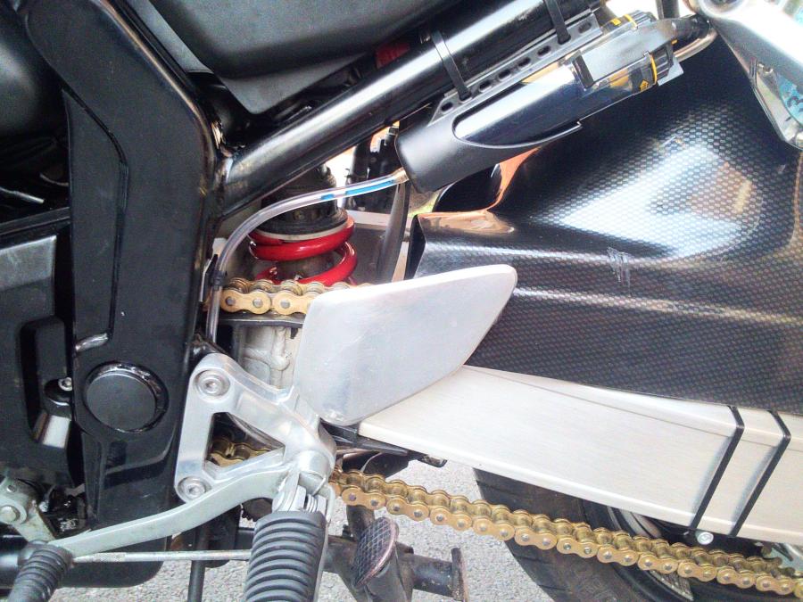

Re: tutoro / Scott oilers and rusty outside links - stevierst - 28-08-14 Double yep. Been using it for donkeys years. Never had to adjust a chain apart from changing the tyre since using it. Re: tutoro / Scott oilers and rusty outside links - MC680x0 - 28-08-14 Aww that's great guys. Many thanks for your tips and help Re: tutoro / Scott oilers and rusty outside links - dcurzon - 28-08-14 I had to make a slight adjustment to my chain last week after 8000 miles. Scottoiler, single side rear sprocket. Re: tutoro / Scott oilers and rusty outside links - stevierst - 28-08-14 8k!!! If only my rear tyre lasted that long Re: tutoro / Scott oilers and rusty outside links - MC680x0 - 29-08-14 Scottoiler V + Dual Injector arrived today £62 for both ! OEM ! Wil fit this wk/end Is there a point / value of me doing a 101 on the install with pics , or has it been covered many times? Re: tutoro / Scott oilers and rusty outside links - stevierst - 30-08-14 I don't see why not, there's always guys asking about specific installation, and a picture paints a thousand words etc..... Re: tutoro / Scott oilers and rusty outside links - MC680x0 - 04-09-14 ok so here is a pic of the scottoiler installed today. I will do a writeup but for now I have a query for anyone who uses on of these please. I went for a 5 minute trip to the petrol station today, and 5 minutes back. Then let the bike idle for 10 minds. The oil has gone about 5 cm into the delivery tube. A long way off the chain nibs. I checked the flow by allowing the engine to run and sucking on the other end of the delivery tube without the injector nib connected; I was able to pull a bit of oil - the 5cm or so of oil in the tube. Although nothing happens if I dont suck - the oil stays where it is. So the pump is open and oil can flow. When I reconnect the delivery tube to the nib , and sit there, the oil isnt moving. The RMV is set to PRIME and the vaccum is good because I can see the pump moved to the top of the RMV and drops when I kill the engine. Is this normal and is more time needed?? You can see the RMV top tight and the dual injector bottom right - you can just see the nib on the silver (new) sprocket . The pipework is routed down the frame , behind the kick plate, under the swingarm. not a lot of pipework and I've heard plenty of guys installing their RMV at this location Re: tutoro / Scott oilers and rusty outside links - darrsi - 04-09-14 No point in constantly abbreviating unless you explain what it means? What's an RMV? Re: tutoro / Scott oilers and rusty outside links - MC680x0 - 04-09-14 (04-09-14, 08:37 PM)darrsi link Wrote: No point in constantly abbreviating unless you explain what it means? you what!? if you has a scottoiler then you'd know - and as I asked for help from someone who owns a scottoiler it stands to reason that you would therefore know what a RMV is   anyway mate, for your eduction :lol - Remote Metering Valve , to use scottoilers vernacular . Its where you store the oil and has a pump builtin that works from the vacuum offa the carb. the idea is that the vacuum holds the valve open allowing oil to flow and gravity does its job in getting oil to the nib above the chain Re: tutoro / Scott oilers and rusty outside links - darrsi - 04-09-14 (04-09-14, 08:39 PM)tweetytek link Wrote: [quote author=darrsi link=topic=14501.msg164956#msg164956 date=1409859431] you what!? if you has a scottoiler then you'd know - and as I asked for help from someone who owns a scottoiler it stands to reason that you would therefore know what a RMV is   anyway mate, for your eduction :lol - Remote Metering Valve , to use scottoilers vernacular . Its where you store the oil and has a pump builtin that works from the vacuum offa the carb. the idea is that the vacuum holds the valve open allowing oil to flow and gravity does its job in getting oil to the nib above the chain [/quote] Oh, that RMV......... Re: tutoro / Scott oilers and rusty outside links - MC680x0 - 04-09-14 :lol been a right twat of of a job this; I had to fettle the dual injector because the chain is a new DID 530VX and sprocket kit, which is too wide for the injector so I had to do a bit of messing about. Took about two hours - should have been a half hour job. The dual injector - as the name suggests - has two nibs that deliver drops of oil onto the sprocket and chain. one each side of the sprocket. too narrow for this chain kit.  |
