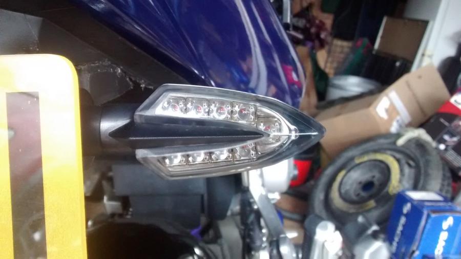

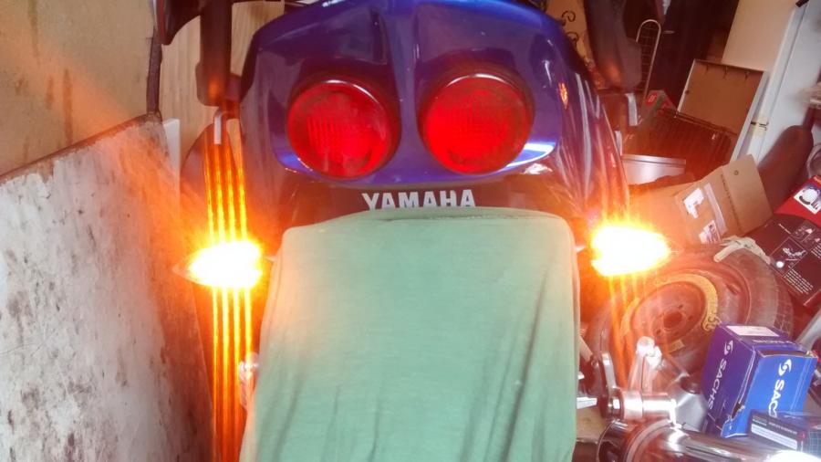

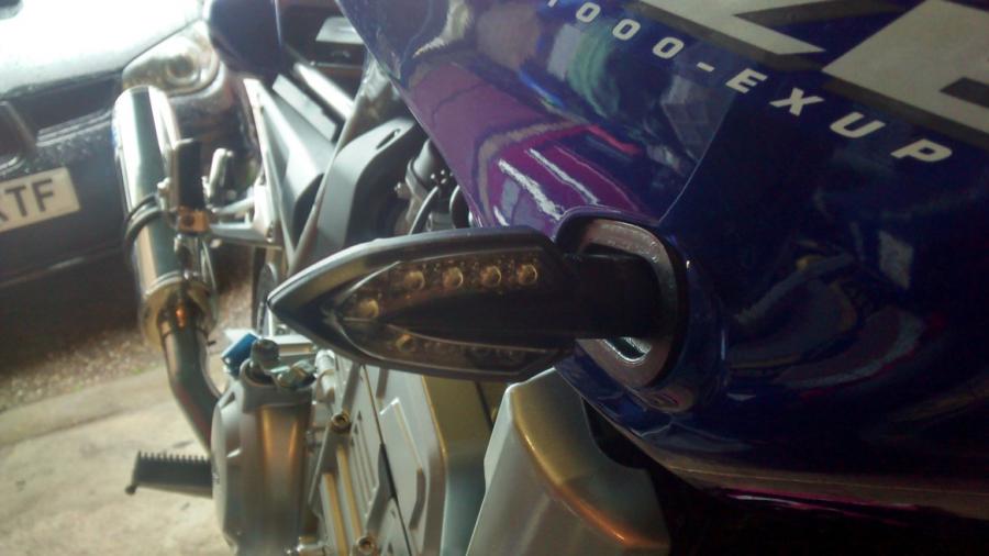

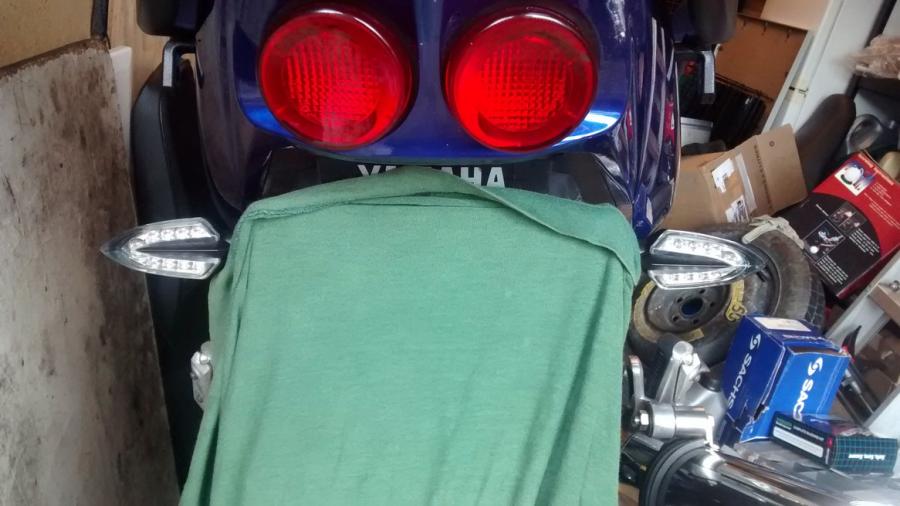

please ignore the state of my garage that is today's mission lol.

(24-05-14, 10:22 AM)FuZzBoM link Wrote: please ignore the state of my garage that is today's mission lol.
They look wicked!! looks like im making a purchase this arvo!! Cheers for the advice FuZzBoM!!  Confusedmokin
Re: Is an LED flasher relay unit on a Gen 1 required? - Krezi - 24-05-14
those look great. I've been about changing mine as well. Fazer 1000 looks modern even by today's standards apart from the indicators! those are straight swap? No fairing cutting needed etc

Re: Is an LED flasher relay unit on a Gen 1 required? - FuZzBoM - 25-05-14
No fairing cutting but you will need adapter plates to fill the hole up a little.
http://www.ebay.co.uk/itm/YAMAHA-MOTORCYCLE-INDICATOR-SPACERS-FIT-YZF600-YZF-R6-FZ600-FZ1000-YZF-R1-Y01-/321210124629?pt=UK_Motorcycle_Parts&hash=item4ac99d8955
You do get in the indicator kit from Yam resistors and some adapter plates, but the supplied ones are too small for the Gen1.
