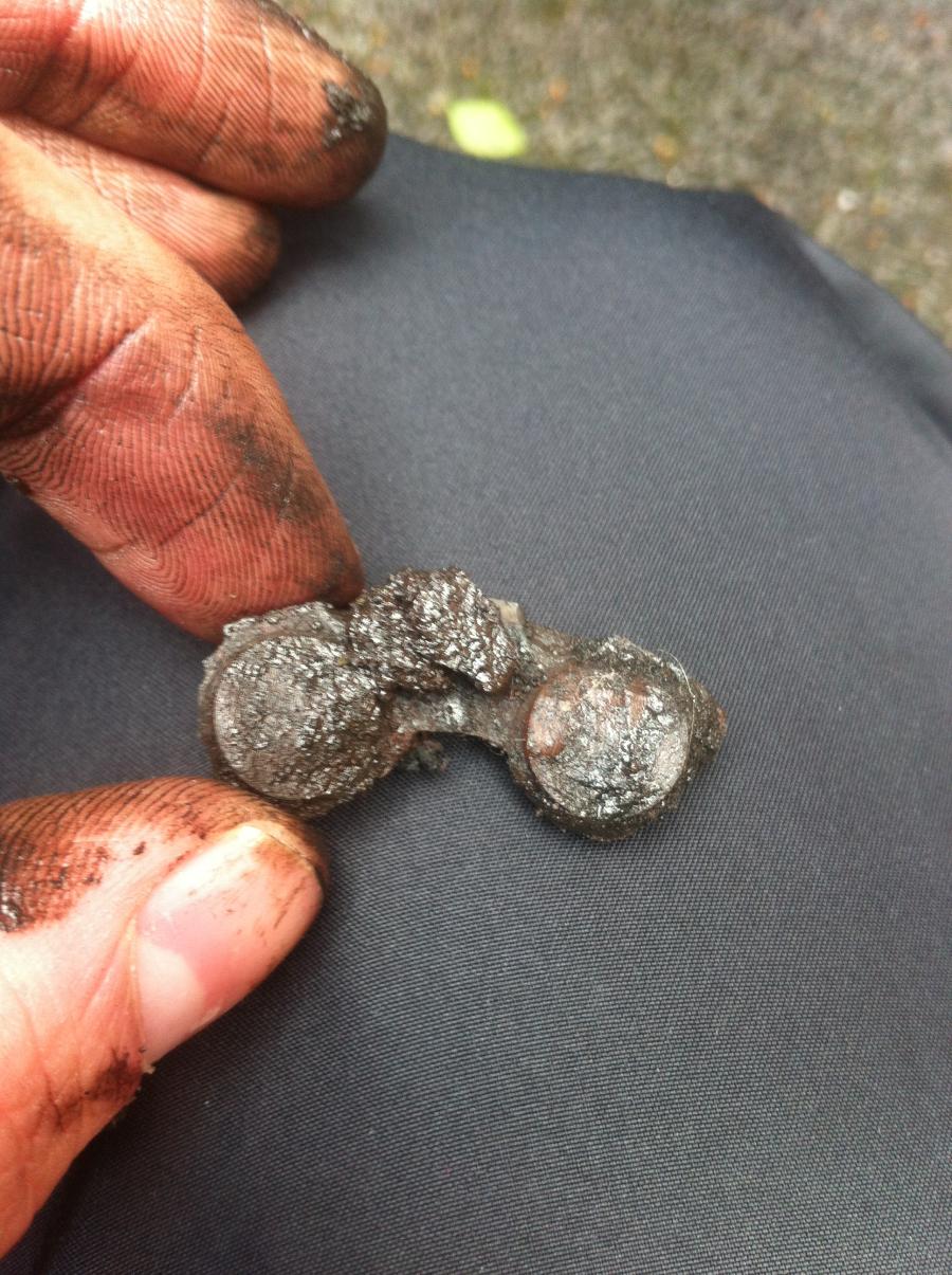

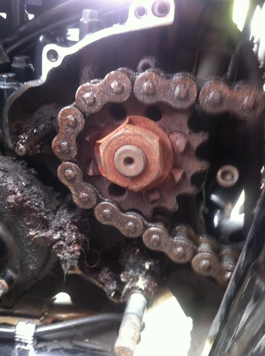

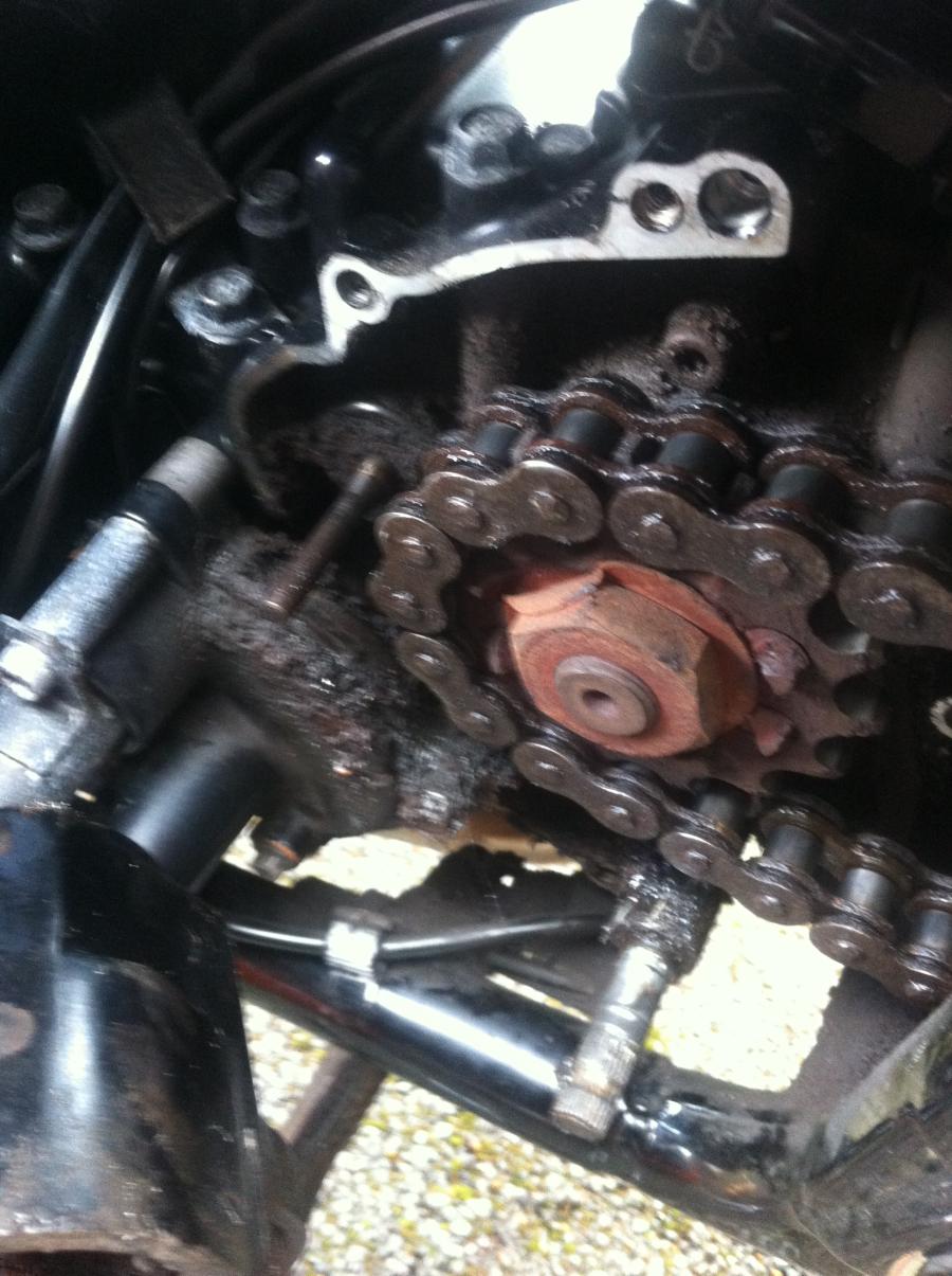

Next, there are nine (i think) holes in the sprocket, some have something in, some dont. In the midst of all the road gunk that was stuck everywhere, i kept finding pieces of plastic that look like theyve sheared off something, i have no idea whats going on or where these parts have come from! Pics attached.

Hi MF92, first of all your tab washer is meant to be bent over like that, it prevents the nut from coming loose. With regards to your front brake light  switch I bet you have been replacing it with the cheap pattern ones off of ebay, don't, buy a genuine Yamaha one. I've had the same problem, the last one didn't even last a month.

Like Dazza says, the front sprocket tab washer is meant to be bent like that so that's not an issue. I have never seen a front sprocket with the holes in like yours and its definitely not a Yamaha part.

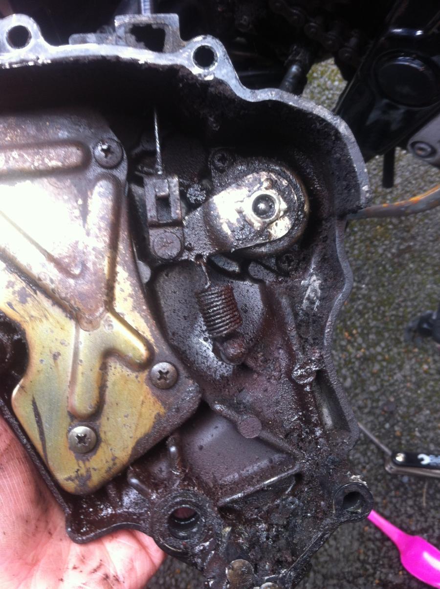

In order to try and solve the problem, the first thing I would do is totally degrease and clean inside the sprocket cover and around the front sprocket area so you have a bit better chance of seeing if anything has been rubbing or has sheared. If everything looks ok I would then order the upgraded front sprocket nut kit and a new front sprocket from Yamaha. You will then need to remove your front sprocket by bending the tab washer flat so that you can remove the nut holding the sprocket in place. Show them the nearest bin and fit the new parts which will be a reversal of the removal process. Ideally you should fit a complete chain and sprocket kit as it can generally be false economy to do it any other way. The only reason I say this is your front sprocket looks pretty worn and I'm guessing the chain may have a few tight spots.
If the noises your bike is making are being caused by a worn chain and sprocket set (which sounds likely) you will be surprised how smooth it is if new parts are fitted and adjusted correctly.

Here is what an origional (clean ) one looks like, I wonder if those bits on yours are the origional red plastic you see here

A clean cover

I'm with Fazersharp on this one regarding the plastic bits - if you clean and degrease the sprocket, around it and the inside of the cover, you should be able to make out the pieces as parts of the plastic on the sprocket.
The plastic section breaking up might be one of the causes of the some of the noises you're hearing. It might just be the pictures, but your sprocket teeth look hooked (shagged) and both the chain and sprocket look rusty - ie not well lubed and likely worm out.
I'd replace both - and the rear sprocket at the same time.

Mine look a little bit worn in my picture but if you look athe them in real life and straight on they dont. The picture is at 16k miles
On MF92s picture of the bits do I see a hint of the same red/orange colour

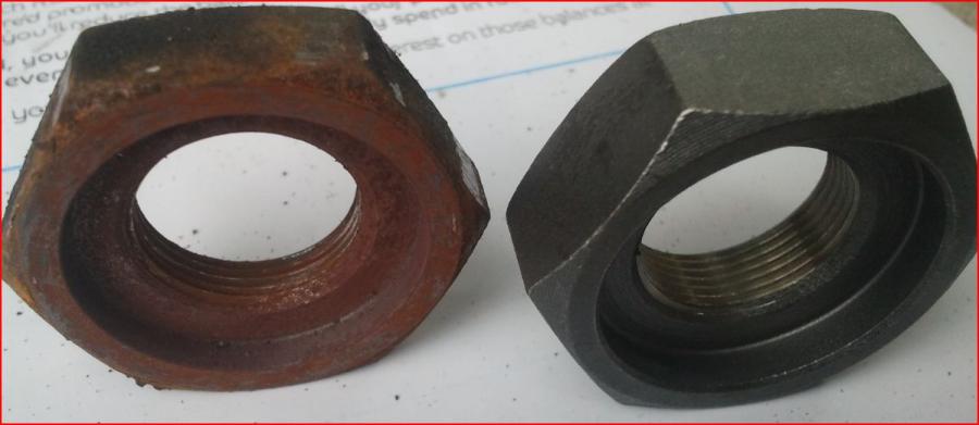

Just to add my bit to the good info already given. The nut you need when replacing the sprocket is part number 90891-10124 and comes as a kit that includes the lock-washer. The nut is 12mm thick. The one in both sets of photo's (MF92 and fazersharps)  is the old 9mm thick nut. Do not let a Yamaha dealer sell you part number 90215-21290 just because it is still listed!

old vs new

I would still like to know what those broken bits were and if they were the red plastic thing, go any pictures now its clean
