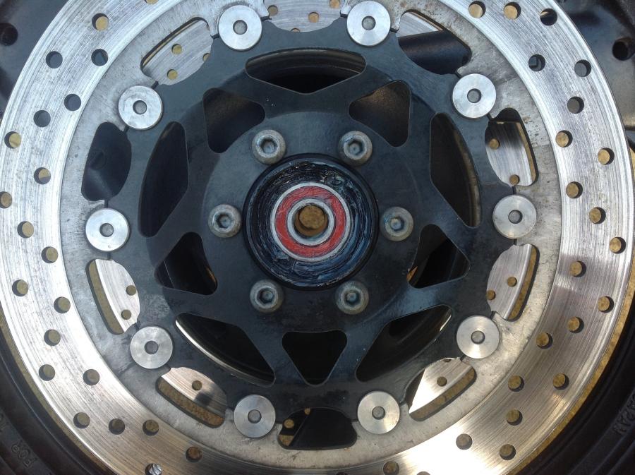

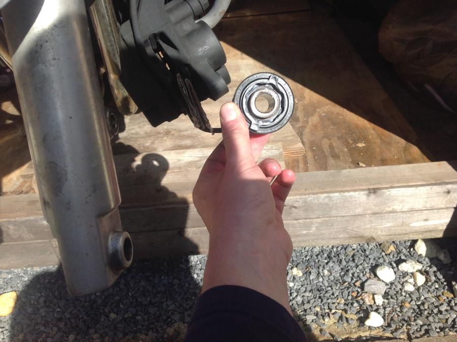

Whipped my wheel off....checked the speedo sensor dog...all looking good........took the wheel to the garage & they reckon the bearings in the wheel look good...the bike freewheels fine with no obvious brake binding & no indication either on the discs....the steering smoothely moves from lock to lock....basically the bike seems fine apart from this annoying noise.

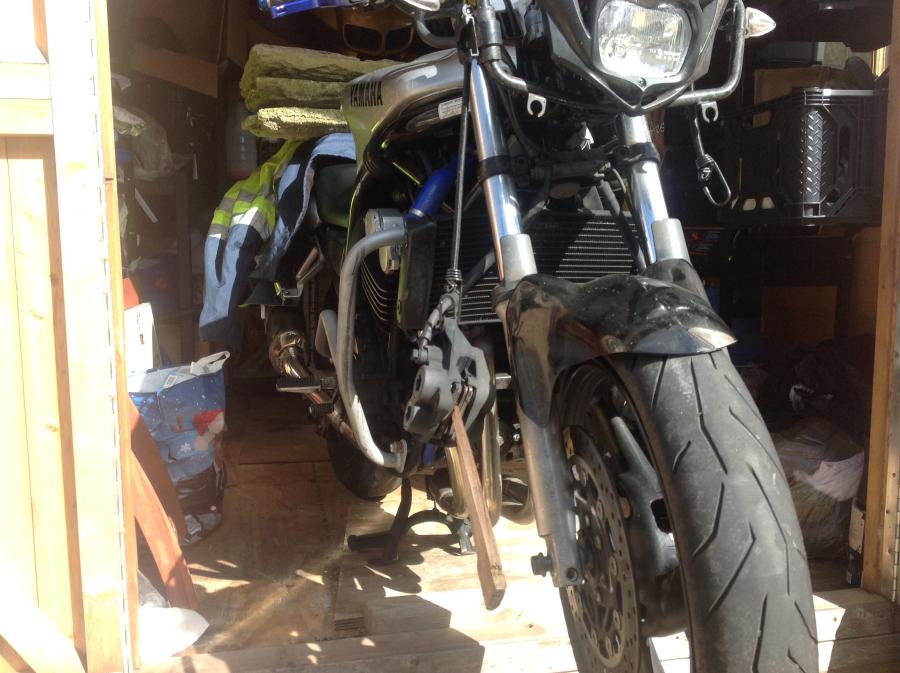

Got a feeling the fender might just be catching on the tyre sometimes...it is very close.....see pic.....& maybe it needs my weight on it to do so as it doesn't do it while pushing the bike.....no obvious marks on the tyre...or the fender though.

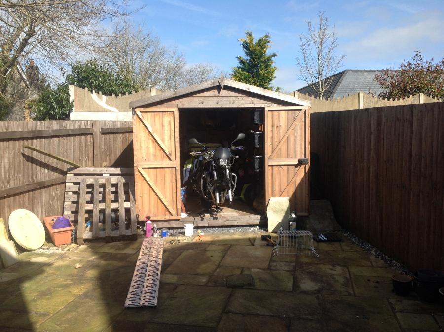

Anyway....still a good day learning some more  :faz  Stuff.....garden slabs came in handy.

As you ride off then any little stones under your wheel will sometimes stick to the surface of the tyre and get rubbed off by the mudguard. could just be that buddy as the mudguard does look pretty close.

Chris could be right Noggy, ever since i fitted the front extended mudguard I began to wonder what the weird noises I kept hearing were, then I realised it was stones hitting it.
Re: Diagnosing a noise. - Doddsie - 18-03-14
Id take it for a spin with the mudguard off, If it still pings, its not that. If it stops pinging, it almost certainly is the mudguard.
Re: Diagnosing a noise. - noggythenog - 18-03-14
(18-03-14, 07:37 PM)Doddsie link Wrote: Id take it for a spin with the mudguard off, If it still pings, its not that. If it stops pinging, it almost certainly is the mudguard.
Ye i was gonna do that Doddsie....until i remembered the new fender is bolted on from the inside out......so i need the wheel off again.. :wall
