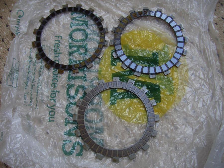

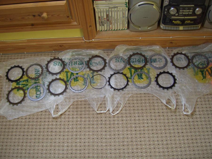

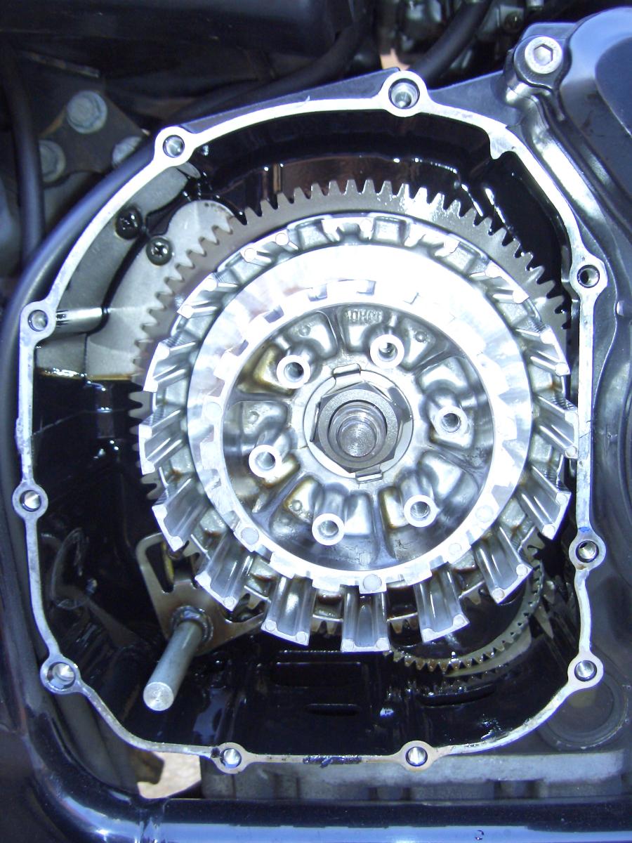

Got my clutch cover opened up today and took out my friction plates. All very clean in there which I was happy with, no emulsion etc and basket bearing felt very smooth and had no damage.
As for the plates, I am not confident to really say as I have never taken a clutch apart before nor seen what a brand new clutch plate looks like. On first inspection, the actual plates don't seem too bad. There is quite a lot of the friction material on most of them and they aren't flat. The steel plates aren't blued at all for the most part, only one of them had some slight marking. However, strangely there were 2 black friction plates in there. One was right at the front so the first one I removed and one right at the back. These to me felt a lot more worn than the rest of the plates, the larger internal diameter plate where the judder spring sits inside is also a black one and feels more worn than the other brown coloured ones. I checked the haynes manual and apparently thundercat clutches have a black first and last plate, but so do FZS 600 02-03 models which mine isn't. So, is this normal? It says if any are worn, the whole lot need replacing as one whole set and to me these black plates feel worn or at least a fair bit more worn than the others.

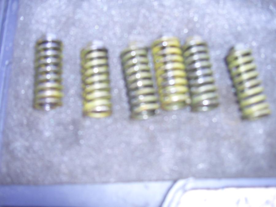

One last thing, apologies for the terrible photo but are these the standard clutch springs? They had a lot of yellow on them so not sure what thats about. May just replace them as well as I don't have a vernier caliper to check if they are still within tolerance. They could be what's making it feel a bit "weak" at pull away and slow to retract on some gear changes if im not careful. If anyone can fill me in with any of the above I would be very happy, thank you. Some pics:

Looks ok to me. If you've got a vernier measure their thicknesses but if the clutch isn't slipping they should be ok

Fair enough, now that I have the plates out though I'm looking at these black ones and don't like the look of them as they're definitely more worn. Not sure why, perhaps a previous owner replaced the plates and for some reason has left those ones in from the old clutch? I've seen this on ebay, normally I try and go for OEM but cant find them and they're very expensive on aj sutton. For £25 I would definitely just be up for replacing the plates as a matter of course. http://www.ebay.co.uk/itm/Clutch-Plates-Kit-Set-Yamaha-FZS600-Fazer-SP-00-03-/141126129318?pt=UK_Motorcycle_Parts_13&hash=item20dbc5d6a6
I will get some new springs as well, rules out those 2 variables then. If it still rattles a little then I will live with that but its the pull away weakness that is annoying me and the great care I have to take with gear changing using the clutch sometimes. Definitely not the gearbox as on the rare occasion I clutch less change its totally smooth. New gasket I will go OEM though just to be sure. Before I buy those plates, anyone had any experience with them? Or should I go for something else like the EBC or whatever, I dont want any heavy duty ones though as I've heard they make matters I'm describing worse.

The noise is mostly likely from the Thrust bearing which has bedded in and it sounds like you have the classic across the frame 4 with a wet multi plate clutch rumble. Is the thrust plate nut loose??? Everything looks fine and normal in the pictures
How can you tell the black plates are worn without measuring them and at 26K it is unlikely they are worn unless you are constantly slipping the clutch. If it was not slipping put it back together and leave it alone.  Smile
Springs are colour coded and look normal

Did you remove the sprocket cover and check if all is well in there.
I presume you have a torque wrench to tighten the clutch bolts (8Nm), they are easily over tightened and stripped.
When your replacing the pressure plate make sure it seats home and move it around until it does or you will end up breaking it trying to tighten the bolts.

Doesn't seem like anything is amiss... the yellow on the springs is nothing to worry about and I'm fairly sure all the OEM ones had that (mine did)
If you do replace the springs, in my opinion avoid the EBC Heavy Duty ones. Some people get on ok with them and for others they are just too stiff and don't work with the clutch properly.
