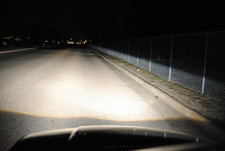

Attached image is a bmw car running the same projectors... although thats like comparing apples to oranges
