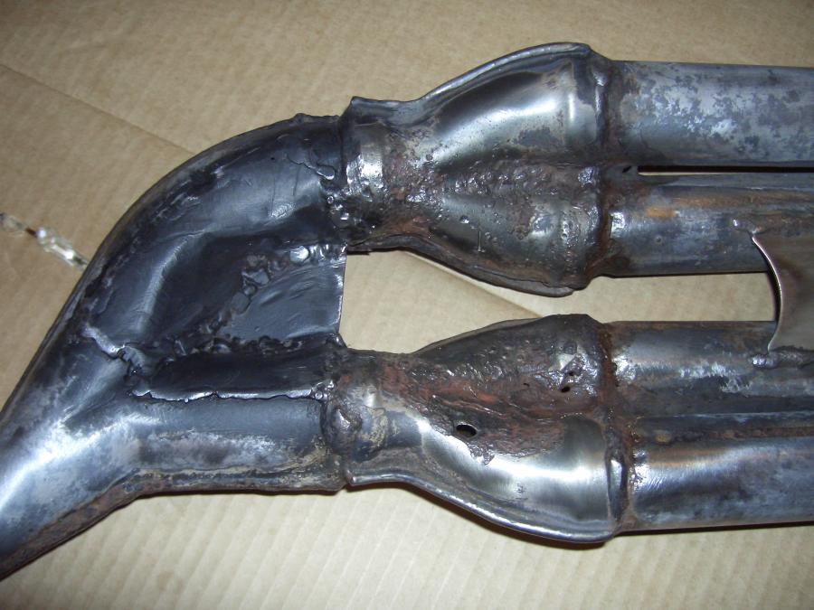

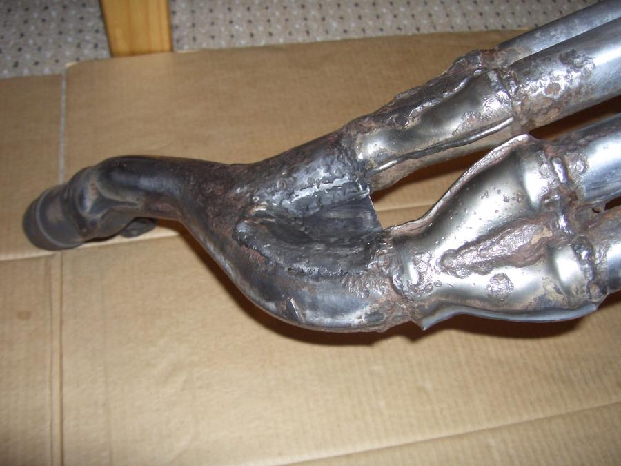

This is one for all of the bored masochists out there. Last weekend I got my old down pipes off nice and easy. They have been blowing for some time so I bit the bullet and got some stainless motads but when they arrived for some reason I just wasn't really that impressed. So I set about refurbing my originals and have left the stainless in my room for now. I took the original pipes to a local garage to get the worst bit welded up which he has done a really good job of and it didn't cost much at all. I then today set about the task of prepping the down pipes for painting:
  1. First I washed them off thoroughly using a pressure washer. Not normally advised but fine as they weren't on the bike, was powerful enough to take a small amount of the paint off.
  2. Sprayed on some muc-off degreaser and let it set for a few minutes, then brushed it in with a stiff brush.
  3. Rinsed off the residue with the pressure washer and left to dry.
  4. Used 80 grit aluminium oxide paper that I got from Halfords and cut it into 8 A5 strips, then sanded like a furious ape for about 2-3 hours.
  5. Halfway through I flipped the pipes over and degreased and pressure washed them again.
  6. More sanding
  7. I then went over the worst bits with a wire brush drill attachment, this created a few more holes but I will take the pipes back down to the garage to be re welded in those areas. At least I exposed them now so that they can be reinforced before putting them on the bike as weak as they were and having them become holes in no time.
All in all it was quite an effort and took a fair few hours of hard work to complete but I feel like it was definitely worth it. I will put up some photos when they are completed after they have been welded and I've finished painting them.
Here is the aluminium oxide paper I used. It comes in 4 A4 sheets which I cut in half. I ended up using it all and just about had enough.
http://www.halfords.com/webapp/wcs/stores/servlet/ProductDisplay?storeId=10001&langId=-1&productId=175468&catalogId=10151

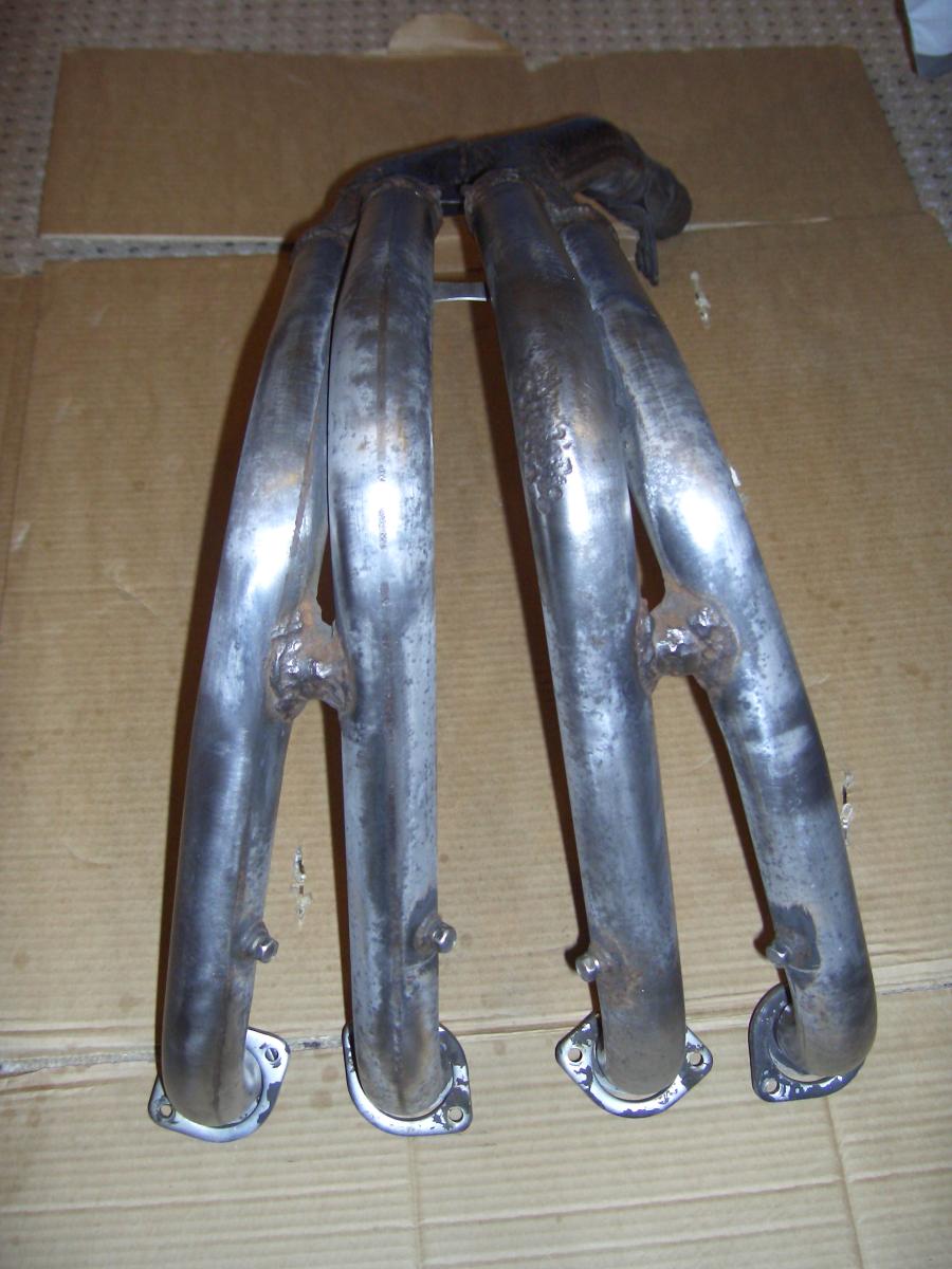

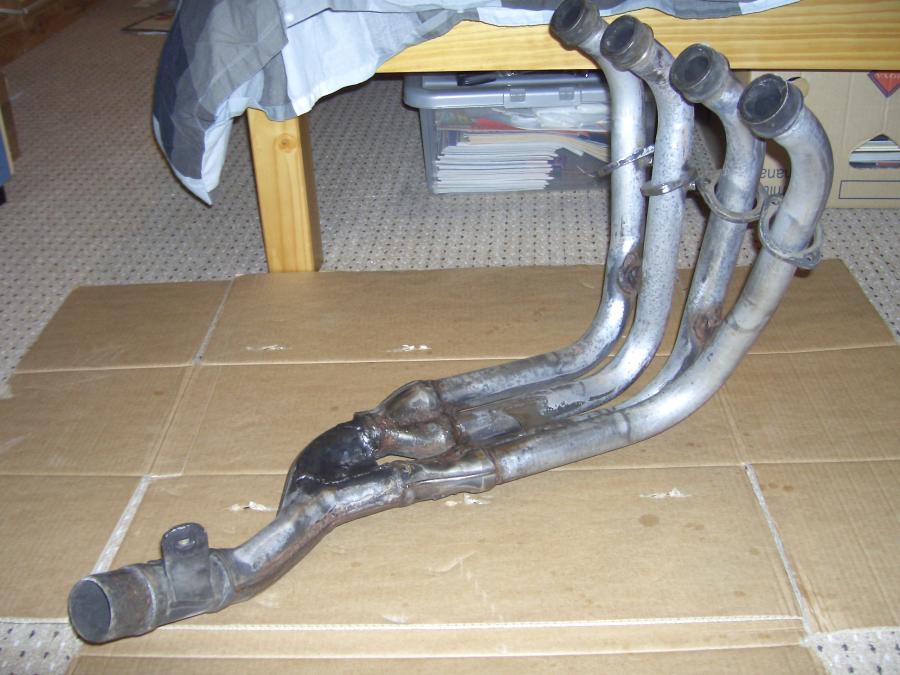

Here are some pics, they look better in the flesh and you can't really see how smooth they are now but it is a huge improvement on what they were like before believe me.

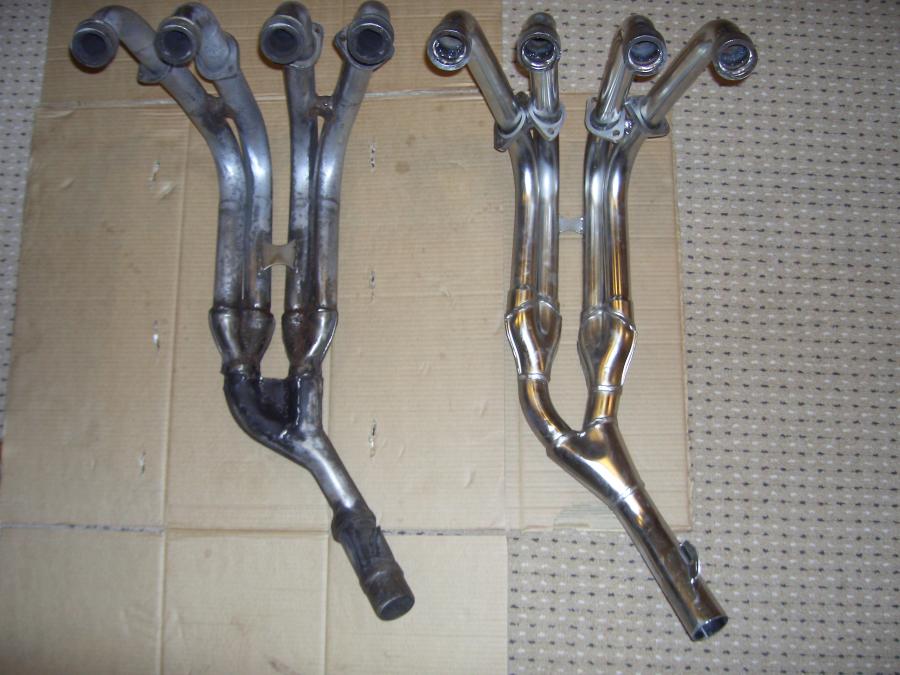

Re: Downpipe Refurbishment - Yamazer-92 - 25-01-14

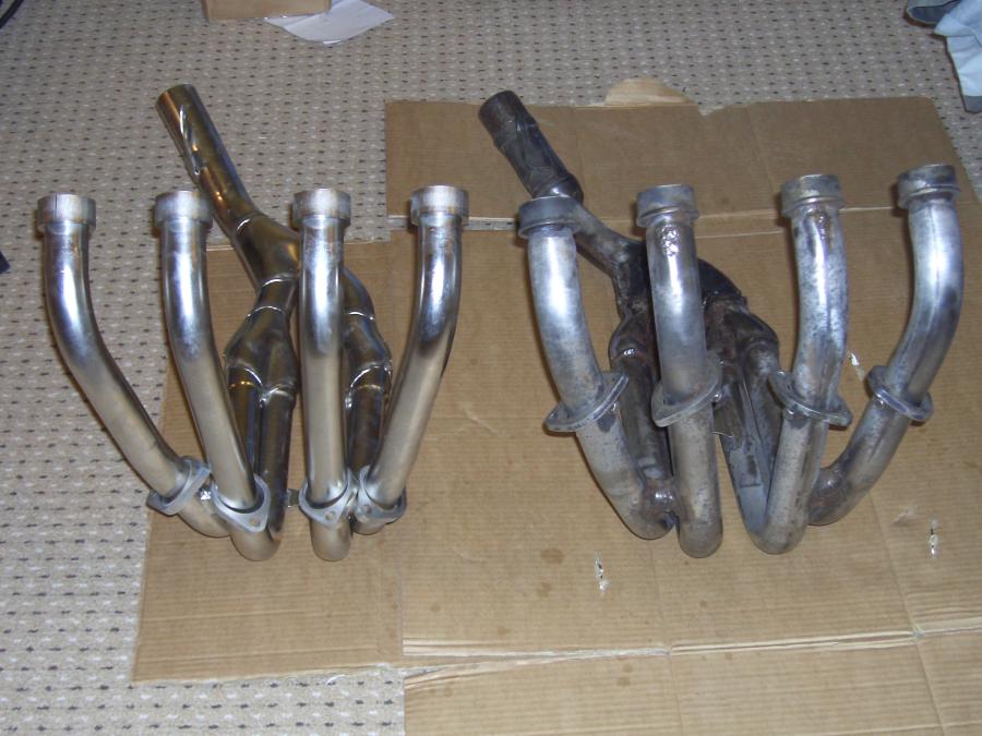

Also for anyone interested here are the original downpipes and Motads right next to each other, they are definitely not identical in several places. Plus something I am very much looking forward to when it is finally all back together on the bike!

I have Motads too. I think the main issue with them is the lack of back pressure in comparison to the oem set. You can see how much narrower the oem pipe is where the 4 pipes collect. I know a couple of people on here have sleeved them down - Paul reported on this in detail. I was just wondering about doing the same soon.

Can't really pin it down to one answer to be honest, I guess I rushed into buying them and when they arrived I just thought in all honesty I don't really need these. I did a lot of research before buying them, went through loads of info and reviews on the old and new forum about what people thought of aftermarket stainless pipes and which to buy. Sorry if this offends anyone but the general consensus I found was that the motads were the best, however there were people who were having issues with fitment or just poor running in comparison to the original pipes. Skilled mechanics were also commenting that dyno readings showed the original pipes offered the best running, especially in the mid range, as they are after all designed by Yamaha for the bike. Obviously the fact they corrode very easily isn't ideal but hopefully this time my preparation and painting will be good enough to keep the rust away for a decent amount of time.
I asked a load of questions to motad who gave me great customer service. When they arrived I compared them side by side with my original pipes. They were not the exact same, especially where the 4 pipes join to 2 then one and go to the outlet pipe which was one of the main questions I asked and was reassured it was all the same as the original. I was quite put off by that, also the fact they weren't as good a finish as I was hoping made me decide to change my mind about scrapping my old pipes which leaves me where I am today. If the remaining holes can be welded which I'm very sure they can be, I am definitely putting my originals back on. Yes it was a ball ache preparing and cleaning them and no doubt painting them will be hassle too but if the bike keeps all of its mid range power then its worth it because revving the tits off of it everywhere isn't my riding style. If I can sell them and get back the £150 I spent I can put that towards braided lines and renthals.

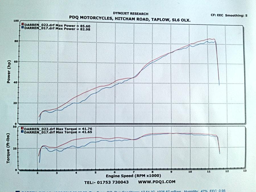

Here's my dyno graph before i had the K&N put in, and although i have replacement shiny downpipes even Nick couldn't tell me what brand they were so i simply don't know?
Re: Downpipe Refurbishment - dcurzon - 26-01-14
What's going on at 7k rpm there?  Get a post k&n run done and see how it compares

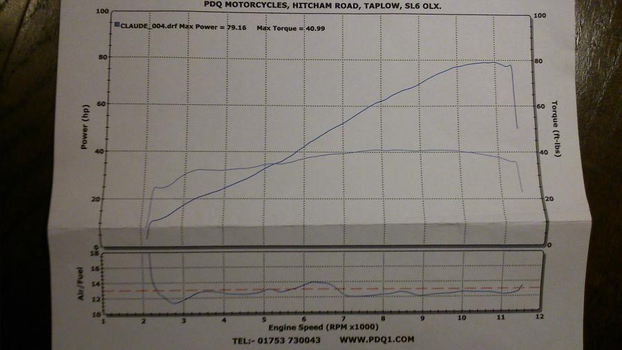

(26-01-14, 02:55 PM)darrsi link Wrote: I have had it done again since but forgot to ask for a print-out.  :rolleyes
I was comparing your dyno results with mine earlier and noticed that dip @ 7K on yours. Mine is down on power in comparison but the curves seem a little smoother. Air/fuel trace was alright too - I was expecting worse tbh but in the end all it needed was a carb balance and a small pilot mixture adjustment.
Despite what I said earlier, having looked at my dyno sheet more closely, I think I probably won't bother with the sleeving down business after all. It looks healthy enough. The mid-range, which is supposed to suffer with aftermarket ss pipes, looks ok. My Motads/Venoms have balance pipes - Darssi, do yours? If not, maybe that would explain your 7k dip.
I'll do another dyno session someday, if the power figures drop further I might start thinking of ways to get it a bit higher.
PS. Interesting - my bike has approx 5hp more than yours @ 7k, and yours has approx 5hp more @ peak. There is definitely more power from your engine after 10k, before that they seem quite similar apart from the dip. All academic of course, conditions incl changes in dyno software can effect results but still interesting!  Smile
