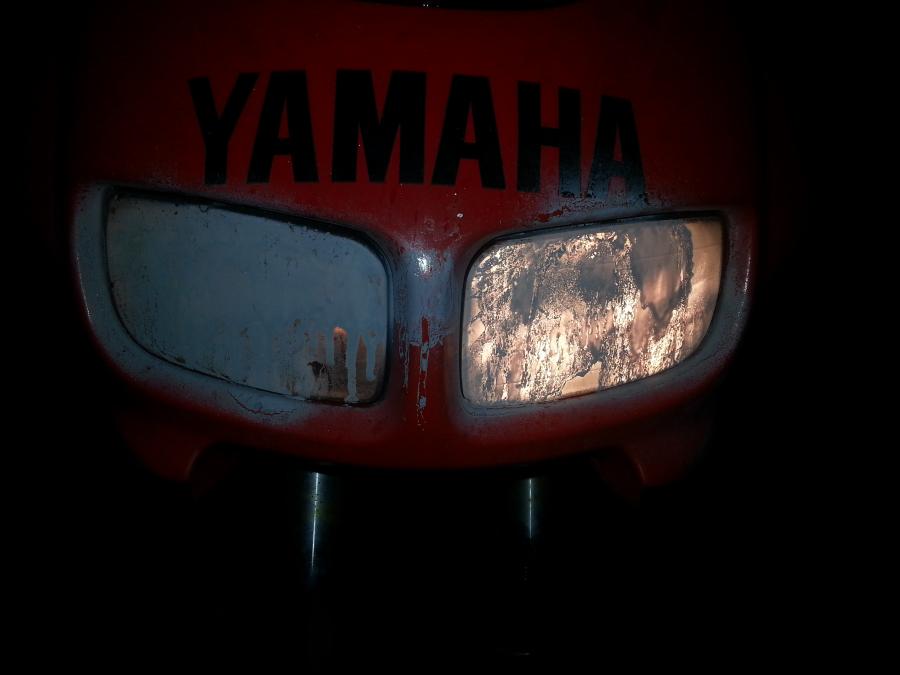

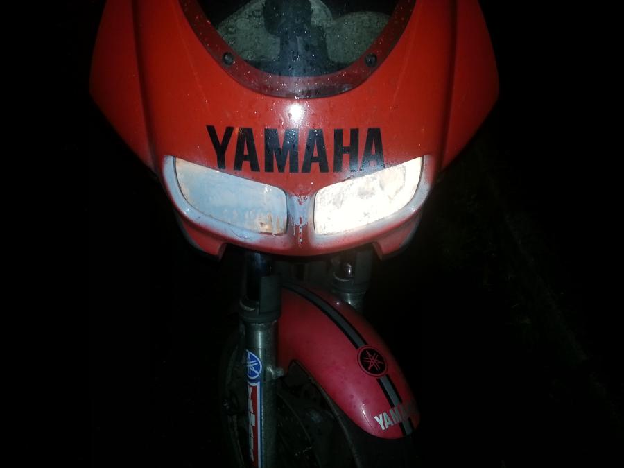

A couple of nights ago, some little shits decided to give my bike a bit of a makeover, in the form of covering my headlights with spray paint (I've attached some images).  They also sprayed the seat, but I'm not particularly worried about that - more concerned by my non functioning light  :'(
So! I was hoping people could offer some (preferably cheap) ways to remove this paint, that won't damage the headlight plastic/fairing.

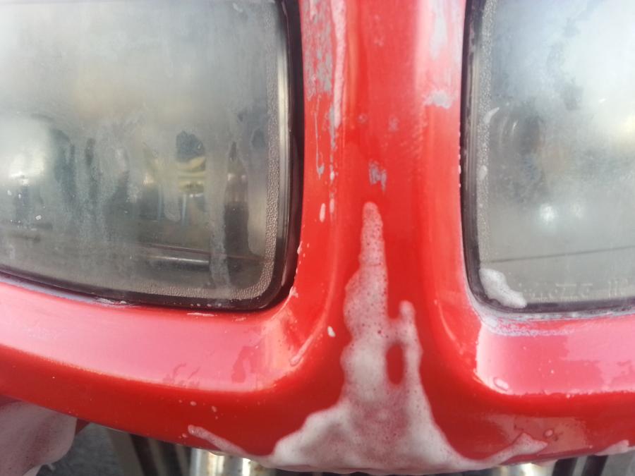

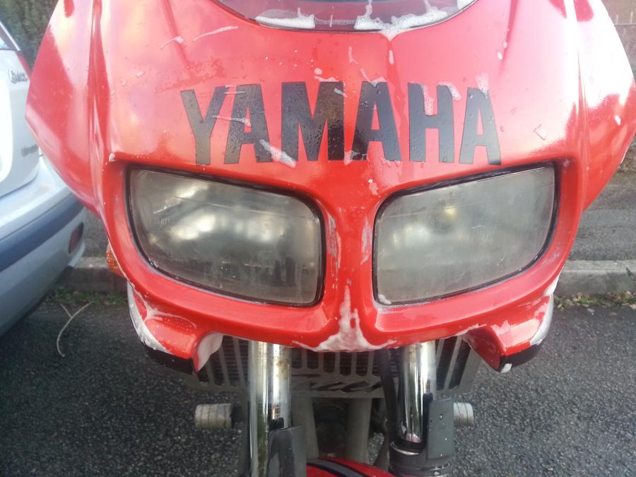

Had a go at it today, and got most of the solid paint off, but it left some hard to remove crap behind.  Pictures attached - think I might need something a bit stronger than soap and water to get this off!
Re: Remove paint from my Fazer headlights :( - mickvp - 10-01-14
thats a thin layr that has already hardened on, it will need polishing off with autoglym SRP/Tcut original/meguiars plastX. should come off with a couple of goes and some elbow grease, and there shouldnt be any fogging afterwards. (be extra careful on the surfaces that are painted i.e. other than the headlights!)
