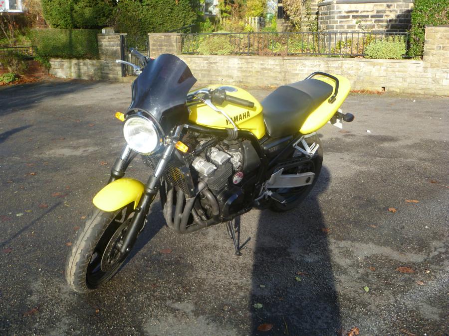

Just finished Headlight Mod. on FZS600 - gryphongryphon - 30-11-13 Just finished this modification today, at least the headlights good now before and after pics.

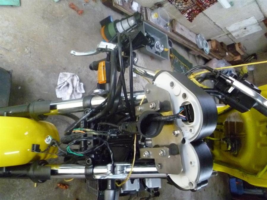

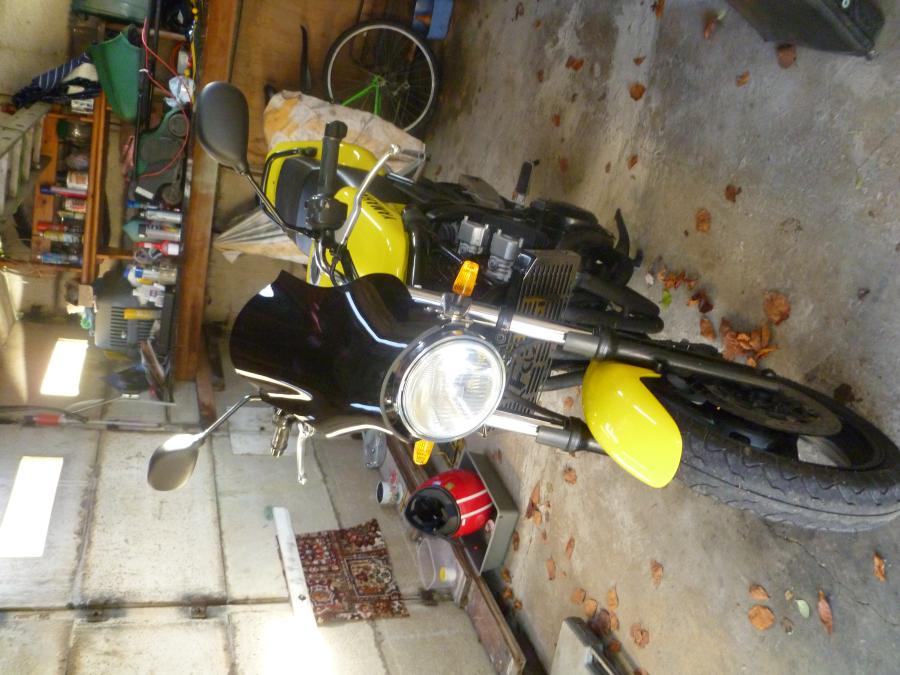

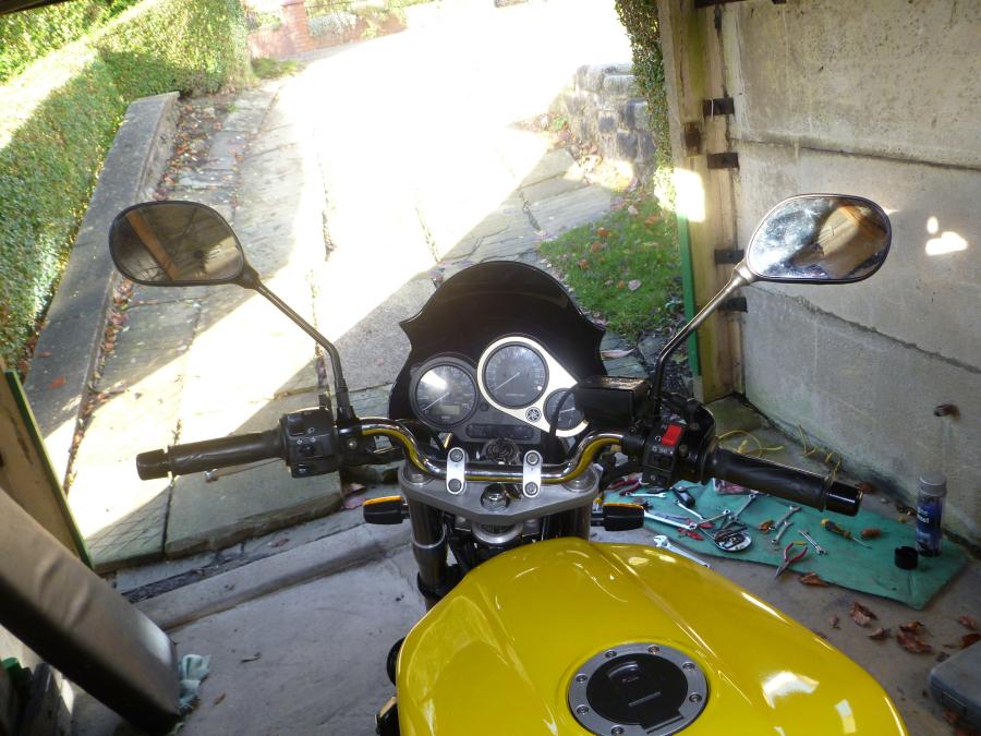

Re: Just finished Headlight Mod. on FZS600 - limax2 - 30-11-13 Nicely done, I like it :thumbup Welcome to the site. Re: Just finished Headlight Mod. on FZS600 - gryphongryphon - 30-11-13 Thanks for your comment, I took bike out for a ride, and I knew something was missing, The Mirrors..... I had bought some new ones to fit in the existing tapped socket holes that already exist in the Fazers, noting I had to buy adapters as the right hand socket has a left hand thread. Here are a couple pics with new mirrors. Also pic showing Stainless steel plate used mount clocks , which is also rubber mounted(4 rubbers) to stop vibration probs. Re: Just finished Headlight Mod. on FZS600 - thunderpantz - 30-11-13 looks awesome. Go on how much and where from Re: Just finished Headlight Mod. on FZS600 - gryphongryphon - 30-11-13 Screen approx £17 dely free http://www.ebay.com/itm/290869774679?item=290869774679&viewitem=&sspagename=ADME:X:eRTM:MOTORS:1123&vxp=mtr Alloy headlight brackets £40 41mm I.D. http://www.ebay.co.uk/itm/Motorcycle-Custom-Cafe-Racer-Bobber-Polished-Alloy-Headlight-Brackets-35-39-41mm-/290942979976?pt=UK_Motorcycle_Parts_13&hash=item43bd8d8f88 Tap m10x1.25 £4.20 metric fine thread to make tapped spacer ,fits on fine thread of handlebar brackets.The Stainless Stl. flat bar fits on bottom of this spacer. Flat bar bent to support clocks, I have positioned rubber mountings between st.stl. bar and st.stl plate at back of clocks. http://www.ebay.co.uk/itm/161123479092?ssPageName=STRK:MEWNX:IT&_trksid=p3984.m1439.l2649 Anti vibration mounts 4 off. £7 inc. dely http://www.ebay.co.uk/itm/251344183571?ssPageName=STRK:MEWNX:IT&_trksid=p3984.m1439.l2649 Cap head bolts M10X1.25 to fix flat bar to spacer. £8 inc dely http://www.ebay.co.uk/itm/251349001210?ssPageName=STRK:MEWNX:IT&_trksid=p3984.m1439.l2649 Hex bar for tapped spacer(mild steel rod easier to tap, alternative) £15 inc.dely http://www.ebay.co.uk/itm/320728507898?ssPageName=STRK:MEWNX:IT&_trksid=p3984.m1439.l2649 Mirrors with LH thread adapter for RH. side £15 inc. dely http://www.ebay.co.uk/itm/250869652927?ssPageName=STRK:MEWNX:IT&_trksid=p3984.m1439.l2649 Stainless Stl. flat bar £5 inc dly. http://www.ebay.co.uk/itm/161106391277 Headlight 8 inch £35 http://www.ebay.co.uk/itm/MOTORCYCLE-8-INCH-ROUND-HALOGEN-HEADLIGHT-12V60-55W-H4-/120877230329 Front indicators.. £1.85 inc. dely http://www.ebay.co.uk/itm/121167382406?ssPageName=STRK:MEWNX:IT&_trksid=p3984.m1439.l2649 Total Approx £150 , maybe a bit more if using Stainless Steel Nuts and Bolts as I did.say +£20 Re: Just finished Headlight Mod. on FZS600 - gryphongryphon - 01-12-13 Theres also cost of a piece of stainless to make back plate wasnt expensive , I think it was 3 mm. thick, a bit over sized probably 2 mm be enough. Re: Just finished Headlight Mod. on FZS600 - fazersharp - 01-12-13 Sorry --- dont like it --each to their own and all that, but (i think) you have just spent all that money and gone backwards Re: Just finished Headlight Mod. on FZS600 - gryphongryphon - 01-12-13 Thats ok like you said everyone to their own, I am a lot happier with it now, I think it looked dated before, where as now it has the classic bike look, I like bikes like the XJR1300 and CB1300. Could be my next addition
