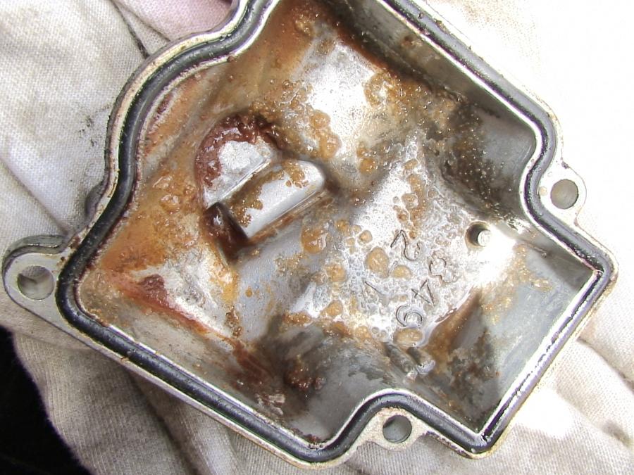

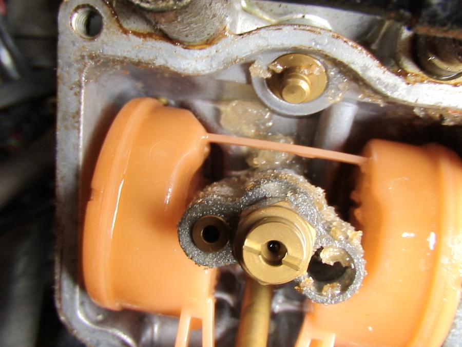

Re: Fuel Stabilizer Recommendations? - Dave48 - 22-11-13 Having read this thread yesterday I asked my local Yamaha dealer today whether they stocked Yamalube brand fuel stabiliser. "No" the guy said but they did have Motorex. I paid £5-99 for a small bottle-(125ml?)-it states this will be sufficient for 30Litre of petrol so will scale down accordingly to suit my tank size. In my experience-old leaded fuels rarely gave problems-other than leaving bike untouched for long periods when the carb float bowls would sometimes get gummed up as the more volatile fractions in petrol evaporate leaving a sticky residue like varnish. From the photos it almost looks like some biological process is happening in the fuel-as said-could be due to the ethanol content. Havent had this happen to me yet and it looks like a right palaver to rectify so am going to try the Motorex-cant hurt can it? Less pain than stripping 4 carbs :lol I have found some bike engines that have had modern unleaded left in for 2 or 3 months reluctant to start-is this due to the more volatile fractions evaporating?-if so we will be resorting to old ways like squirting ether spray into air intakes-the way they used to start old diesels in extreme cold conditions! :eek Re: Fuel Stabilizer Recommendations? - keithfzs1000 - 23-11-13 http://www.ebay.co.uk/itm/1x-DYNO-TAB-Fuel-Stabilizer-Tablets-8-tab-Card-Keep-Petrol-Diesel-Fresh-/111204602355?pt=AU_Car_Parts_Accessories&hash=item19e44f91f3 enough for 2 poss 3 bikes depending on size of tank never had to use it before in 30 years of biking but last year when I was modding the fazer I did notice difficulty in starting as was not run for 3 month and was the same with my wifes bike as if I didnt go out on bike she didnt so might try it :\ :\ Re: Fuel Stabilizer Recommendations? - codgie - 23-11-13 try this ? http://www.lucasoil.co.uk/store_item.php?product=10314 Re: Fuel Stabilizer Recommendations? - Noj - 26-11-13 (22-11-13, 07:51 PM)Captain Haddock link Wrote: With the more common usage of biofuels in petrol I wonder if any of it's microbes similar to the diesel bug causing the problem, that lives at the water/fuel interface absorbing nutrients from the fuel and oxygen from the water, makes a right mess of fuel filters in many boats. Although it's called 'diesel bug' all Fossil fuels suffer. Adding bio fuels make it worse and reduce the 'BTU' of the fuel. There are many other fuel additives made by endless company's. None do what 'Aquasolve' dose, when fuel gets cold and I mean clold, the water drops out of phase ( basically separates). Fuelset is another product, the best it can do is a micro emulation which separate when cold, so dosnt fully work and still allows the slimy growth you see in picture. If not treated it will only re populate when next opportunity arrives. Grate picture of microbial growth in petrol. Another thing Aquasolve is a biocide with biostatic property's so desolves the slime and returning it to fuel. |
