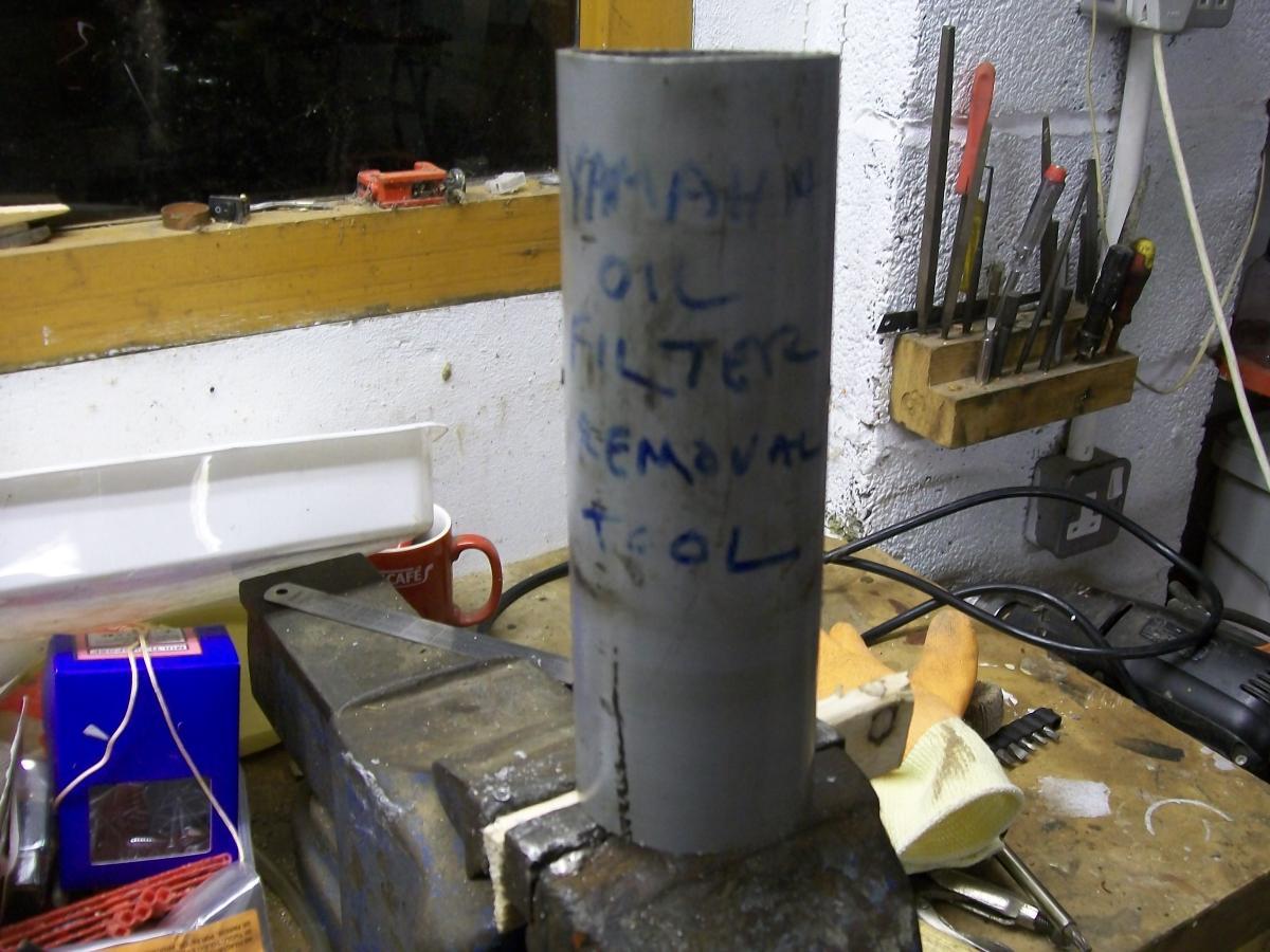

This is the tool I use it's a bit of old plastic fall pipe the I/D is 64/65mm, it has a hole for a tommy bar, which I've never needed to use, It's a tight fit on the filter so hasn't slipped so far but if it did I would put a few self tapping screws through it into the filter, so out you go and take down your fall pipe, as long as its round and the right size, they vary from make to make?

(02-11-13, 11:54 PM)Doddsie link Wrote: does it fit through the downpipes?
the filter on the FZ6 is on the side of the engine the number is 303,  don't know about the FZ600's

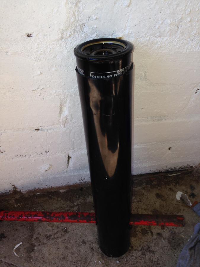

We have success :rollin Oil is changed!
Thanks for everyone's suggestions, but Chaz you are fuckin genius coming up with that idea. Ended up in b&q buying guttering but it worked a treat!  Thanks again
