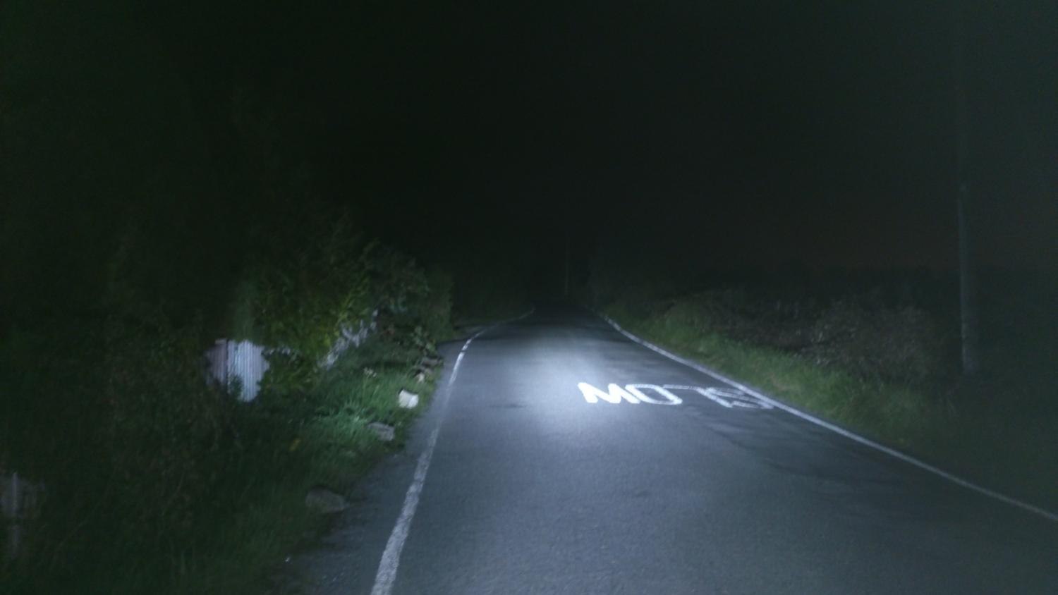

Hello foccers, just fitted a HID conversion kit and am not happy with the way the light is thrown out. On dipped lights there seems to be a dark patch in the middle and main beam seems too low. Has anyone else had these issues and is it just a matter of adjusting the lamps. Don't know if the 50 mm fork drop has compounded  this. What do you think foccers.  Before and after photos attached both showing high beam.

The top pic does not look like HIDs.
The bottom one just looks like you need to adjust the level
Re: HID conversion kit - Fazerider - 30-09-13
I'd guess it's due to the arc not being in exactly the same position as the high beam filament was. Sounds like you need to experiment, it might be possible to improve things by using either a spacer to move the bulb back a bit in the reflector or (if you can think of a way of doing it) trimming the mount so that it's deeper into the reflector. It'd probably be best to optimise the low beam pattern and just hope that high beam turns out OK.

Re: HID conversion kit - dazza - 02-10-13
Well, adjusted the lights and it all seems much better. Only one thing that is on my mind is that I had to extend the power cable so it would reach the battery and used a couple of plastic connector blocks shown in the bottom picture. And  because there is a sticker on the ballasts that says these are AC and run at 23 000 volts  :eek  are there any electrical gurus on here that can tell me these are adequate, or will I need to solder the joints together and insulate with heatshrink. I now have excellent lights but a little feeling it could all end in misery and flames. :lol
