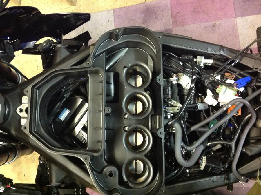

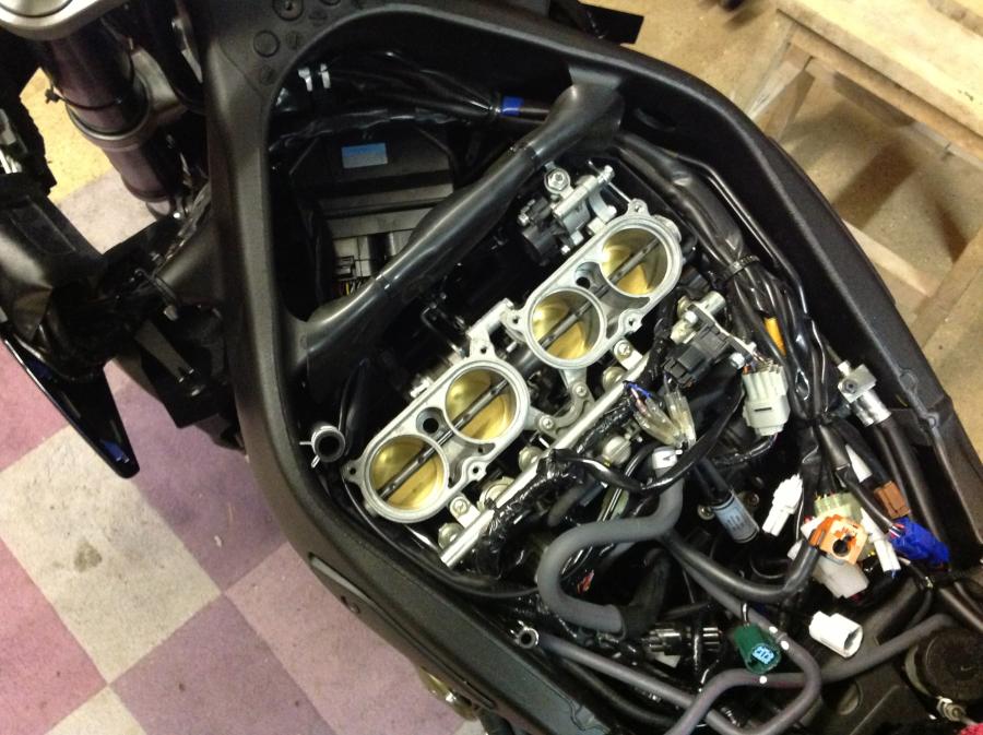

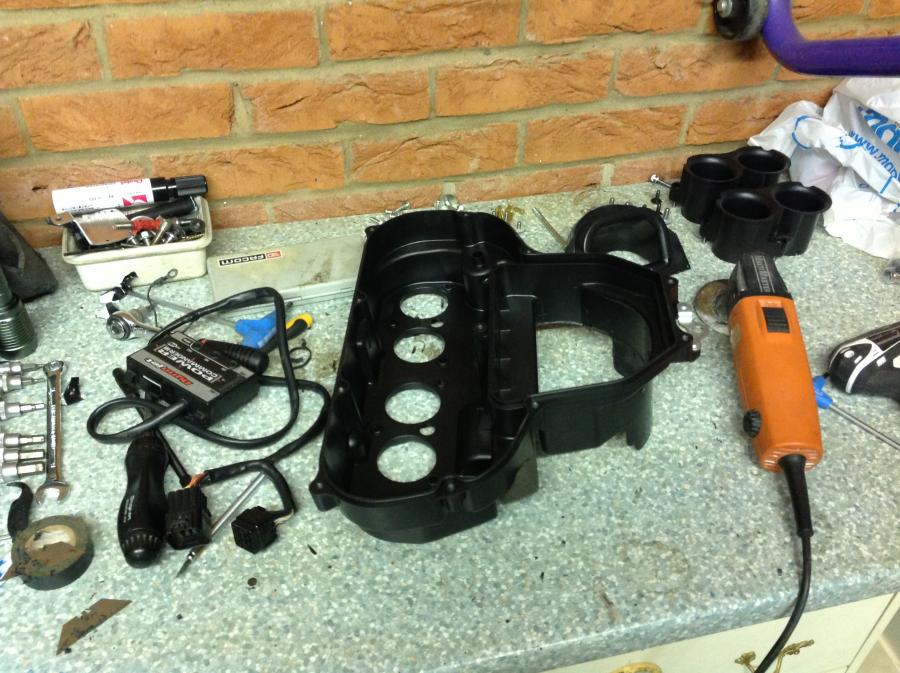

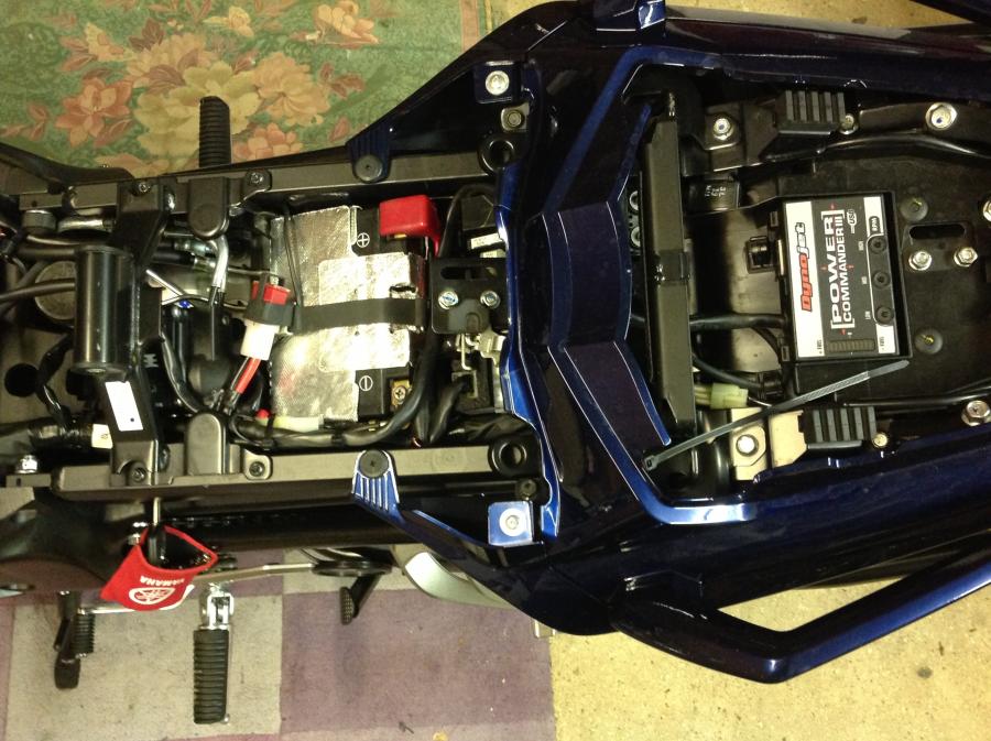

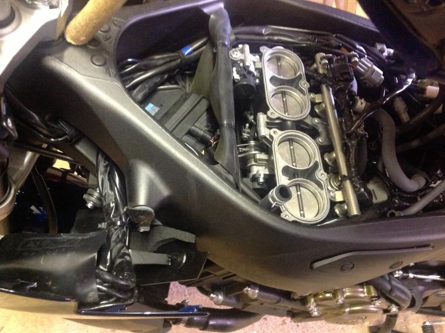

After giving me FCE a week or so to get the feel of it, Had a great evening in the garage on me fz1 tonight....picked up a pc3 the other week for £132 on eBay. Tonight I modded me airbox, disconnected me O2 sensor and removed the secondary butterflies(heard some right horror stories about getting the screws out but a decent right sized driver and plenty of concentrated heat of me leister gun and it was a piece of piss) then fitted the pc3. Yesterday on the bay again I got a carbon bos slip on for £102, ( still want a yoshi but money is tight) hopefully it will be here tomorrow, just gotta de cat the manifold and de cable the exhaust valve before I fit it. Pc3 came of a bike with similar spec so it should be ok, but I'll get brew at BSD to do a custom map, hopefully it will be knocking on the door of 145-150 brake. Couldn't help but try it tonight with just the induction mods and power commander...lovely snarl under the tank and it finally is starting to feel like the flat barred r1 I wanted when I bought it...

Good going, are you leaving the secondries out? i just trimmed mine, also the O2 censor ,i just unplugged as suggested and left the cable off, seems to work a treat.

Cheers guys. Yeah thought about trimming them but brew ( BSD engineering) said whip em out completely, and the bloke I bought the pc3 off had removed his completely too. Doesn't Bog or anything else adverse so seems ok. The induction roar alone was worthnit lol. Itching to take it out but gonna wait for the can. It's a lovely bike to work on innit? Put together like a Swiss watch. I do love yamahas build quality, and the fz1s minimalist approach. Whilst the gen 1 is easily the better all rounder, the fz1 has a purity of purpose and design I'm really coming to love.

I did the same with mine, but trimmed the flies to keep a bit more bottom end torque. The bike is an animal with the right map!
You don't have to go and get a custom map, you can simply download the map pack zip file from the fz1oa site. I've had some good fun playing with the maps, and got about 7 on my juicebox pro that all have slightly different characteristics.

does trimming and re installing the flies make a noticable difference mate? it seems ok low down, but i'll put them back in if it gives it even more grunt.

(17-09-13, 09:35 AM)ogri48 link Wrote: does trimming and re installing the flies make a noticable difference mate? it seems ok low down, but i'll put them back in if it gives it even more grunt.
I did a lot of research for the flies before I made the decision to make some smaller ones or bin them completely. The Americans are the leaders in tuning these bikes, and I looked on both the USA Fazer sites asking the same question. There were quite a few guys who removed the flies, but found out that some of the bikes bog down slightly (probably a poor map). These guys replaced the flies with trimmed ones saying the bike had more usable bottom end, but slightly less top end.
I suppose it depends on your riding style, and what you want from the bike. I prefer to have a bit more bottom end for UK roads, as it's rare I go to the redline. (who the hell does???) If your a track hacker, then bin the flies and get an aggressive map.
If you've a bit of engineering skill, it's an absolute doddle to make your own smaller flies. 2mm aluminium plate, tin snips, a file, and a drill is all you need.
Re: Tuning on the cheap.. - ogri48 - 17-09-13
cheers mate. making them is not a problem, and im no track day hero, so bottom end always wins out over top for me. i guess i'll just make some and give em a try, its all good fun in the garage innit? Smile  it deffo doesnt bog, im guessing as the map is already compensating, but it could once the exhaust mods are done and the gas is flowing that much quicker i suppose. gotta take the tank off again to wire in some heated grips and me exo2 heated vest controller anyhoo(yeah, not summat you need to worry about i know mike... Wink ), so i'll try it then. thanks for the heads up bud

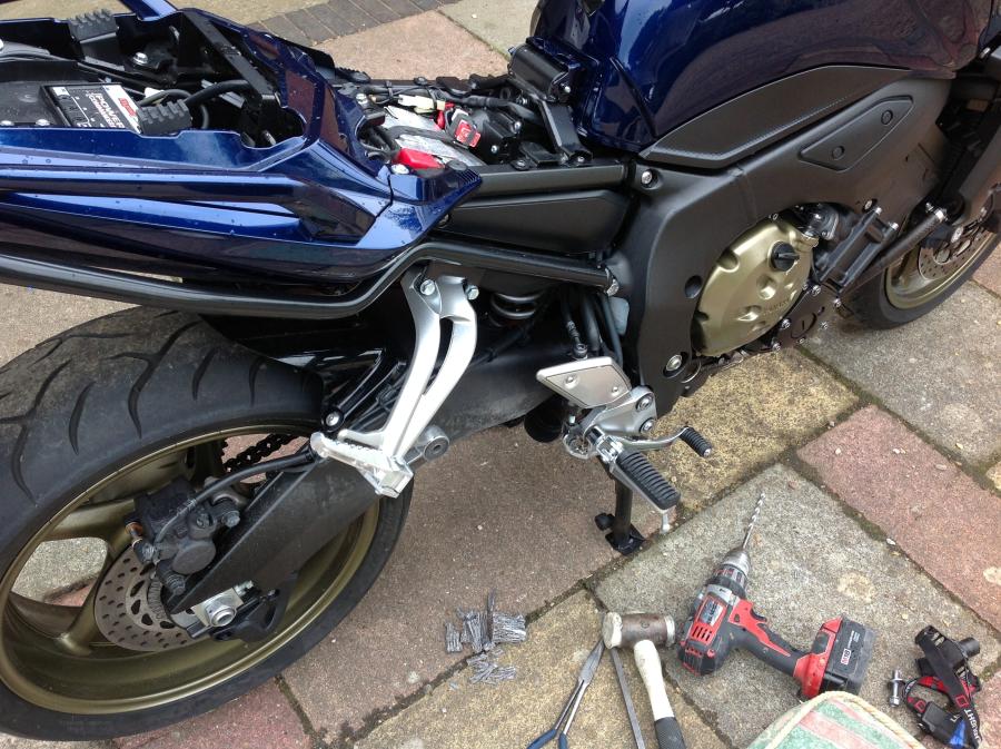

Interestingly, the last photo shows why I gotta tune on the cheap. Them sportsmaxes are the originals, meaning although they have shitloads of tread after just 2k miles, they are totally useless being four years old, it's like they are Teflon coated, I cannot get anywhere near the edge on em and have spent the last few weeks since I got it sliding around norwich like bloody torville and dean...a new set of pirellis is pretty much crucial and well overdue. :eek

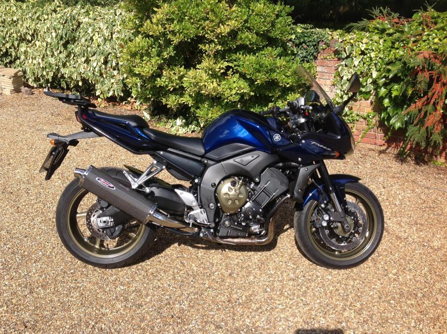

Cheers tim. Mine doesn't bog or fluff but if there's more low/ mid to be had at the sacrifice of top end i never use its gotta be worth a punt, picked up some sheet today gonna make and fit some smaller ones tonight, try em tomorrow. Bos end can turned up, mint condition and looks pukka with the stealth bracket instead of a strap. Absolute Bargain for a carbon slip on..£102, bid on loads of more modern looking angular ones but they keep making stupid money, guess not many people want the old school ovals so much now.Fitted it and anything over tickover bike just fucks off like the millennium falcon now... Smile

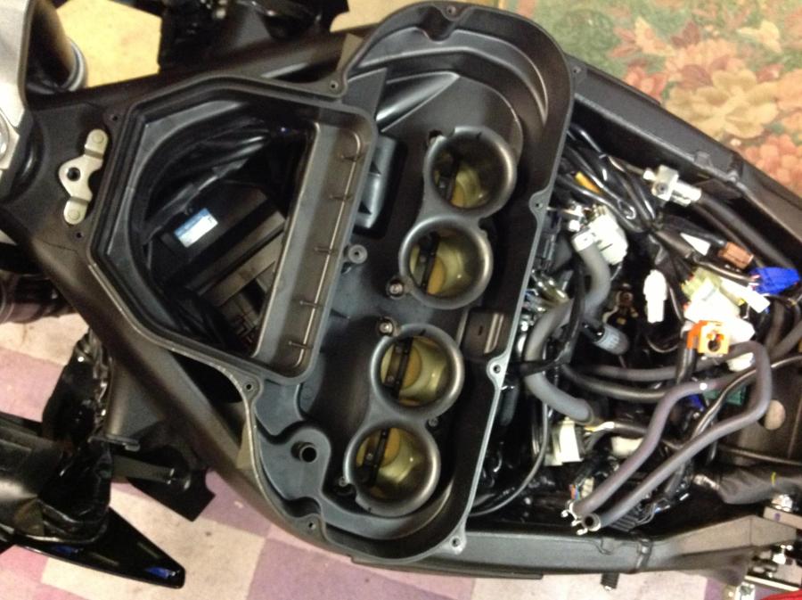

Cheers dude. You gotta get your airbox mod done tim, it's worth it for the induction snarl alone:-) made me smaller secondaries tonight...stock ones were dull and frankly rough as a badgers arse, obviously any part of the motah with air flowing over or through it wants to be smooth so once I'd drilled and cut em I wet and dried em working through 240/400/600/1000/1500 finishing on 2000 so there niiiice and smooth like. Be interesting to see if I can feel a difference tomorrow. No idea if I've took too much off/ left too much on but it worked okay with full ones/none at all so i reckon it's gotta be cushty  Smile
