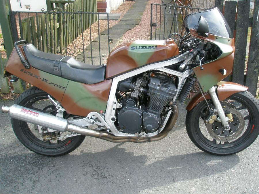

Re: vm 29 semi flatside question - nickodemon - 08-09-13 I have previously done the tube up the side, which shows the level the fuel sits in the float bowl. The carbs are the uk version 29mm semi flat slides. I replaced seal and needle, but not seats, so it's probably them that are causing an issue. I replaced the exhaust years ago with a full stainless micron system. When i went to have it set up on the dyno we couldn't get it to run right no matter what jet kit or needles we used. Ended up cutting open the system and removing an internal baffle just where the downpipes go from 4 into 1. Set up after that was straightforward I still have the dyno read out..98 hp at rear wheel. Doubt it still puts that out now :\ This bike i bought in 1992 with 12000 miles it was mint. I used it for 12 years and sold it to my mate when it was still mint. He used it for 8 years but totally neglected it. He even drove it to Africa! Bought it back last month and replaced fork seals, starter, rear tyre, regreased suspension bushes, repainted 'cheap as chips', stripped carbs and ultrasonically cleaned them, stripped and bled brakes and fitted new seals. Plus loads more....Costing a fortune :'( Here is a recent pic... I have since added bullet hole stickers :lol 99p This paint job is temporary.. any suggestions to the colour i should paint it?
Re: vm 29 semi flatside question - unfazed - 08-09-13 Most likely the seat if the rest was replaced. They would have worn to suit the needles, which is why I always put back the needles into the seat they came from when stripping carburettors. Suitable colour for parts of Africa Why not go back to the original colours? From the picture the roling chassis looks in excelent condition. Notice you have a Tuono, what is it like? I have a 2004 RSV R belonging to a friend in the garage at present, he wants me to set the suspension up for Irish road use. Very different to the set up required for motorway and primary routes. Re: vm 29 semi flatside question - nickodemon - 08-09-13 It was black when it went to Africa. I bought a couple of cans of green & brown paint and did it all in a day . My tuono v4 is utterly bonkers! Brilliant bike, which handles and goes like no other bike i have owned. Really pleased i bought one. Still have my gen 1 fazer thou, as it's the best all rounder you can get.

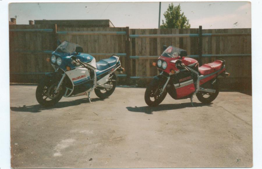

Re: vm 29 semi flatside question - nick crisp - 08-09-13 The red one in the pic was mine, before Suzuki did it in these colours (Dream Machine paint job). I loved this colour and still do. Had a full system by Pete Gibson, direct copy of Yoshi works exhaust from the time (1986) foc it was loud, open carbs and upjetted on the mains only (got the jet sizes from an article in Superbike Magazine who got them from Mick Grant's Superstocker - no chance I can remember what size they were) - it went like a b*****d! Tried NRP for carb repair kits, O-rings etc but they don't list any for this model. Could be worth calling them anyway if you need carb spares. Used to find them really helpful when I worked parts in bike shops. Re: vm 29 semi flatside question - nickodemon - 08-09-13 I got float bowl gaskets from nrp. I have used them many times, as they always have what i'm after. I think red/black might be an option. Probably all red and fit gsxr graphics in black. Re: vm 29 semi flatside question - unfazed - 08-09-13 Are NRP still around :eek I got diaphrams for an XJ500 from Andy over 20 odd years ago. Great fellow to deal with
