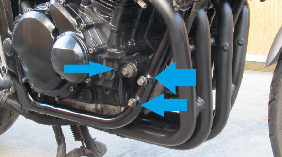

Well I've been getting some nasty vibration through my right footpeg recently at cruising speeds which is getting really annoying and I've read here about people with loose engine bolts. I want to eliminate that theory but I dont know what bolts the manual is on about for the front as it gives 2 figures, 33nm and 55nm but doesnt actually show a pic of which one is which. Here's a pic in case anyone doesn't now what I'm on about. Cheers.

I dont know for certain, but I would have thought the two at the front were the 33nm ones, and the one with the load bearing washer built in would be the 55nm on.
see what torque it takes to loosen two of them/tighten them a wee bit more? should give you an indication?
Re: Engine mounting bolts - Yamazer-92 - 30-07-13
I think you're right there, I'm not amazing with torque wrenches but doing what you said as a gauge it seemed the ones on the frame are the 33nm ones and the big one is the 55. They were all tight anyway, guess its carb balance issue or something which I'll address when my carb tune gets delivered. Cheers for the help.
