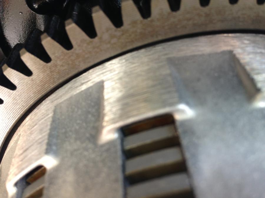

Re previous post of vibration and whine too k this picture of clutch basket , I've not done many clutches over the years but this does not seem right , am I wrong is this normal ? If it isn't WTF caused this ? Also when clutch push rod went back in from sprocket side it reached end if travel and felt harsh like there was broken metal at the end on the side and was catching on something

Not sure quite what to look for - picture maybe too close-up?

Agreed, what are you referring to in the picture? I can't see anything obviously wrong which is a good sign

The side of the basket is scored badly and I can't see why it would be that way ,the rest of it is smooth casting and although the only clutch I've done before was a stroker years ago I don't remember it like that , sounds like I was hoping that was what's wrong and then simple fix ,  the picture maybe doesn't do it justice how scored it is I've attached a couple more pics in the hope it shows up better . My thoughts were as it is a rotating part it must be balanced otherwise vibration would occur ( am I wrong in this thought ) and this may be causing the excessive vibration , also when the pushrods goes in it is catching on the side like a burred edge and it feels line there is grit rubbing it ( it feels abrasive and you can hear the scraping surely as the ball bearing is at the end of the rod it would contact it at the end . Although clutch works ok low speed it's very jerky and quite clunky on release .
Re: Is this clutch basket a basket case - nick crisp - 15-07-13
Hmmm. That's got me stumped. On the first photo it just looked like a machined surface from the factory, but second pic... that's a puzzle. Now looks way too deep and uneven to be that. Strange also how where the "fingers" (yeah I know, crap terminology!) that the clutch plate tabs slide up between don't seem to be marked similarly where they join with the main casing.  :\

It puzzles me what on earth could cause such marking consistently across the whole face of the basket like that - I can't think that it would be something on the inside of the cover, if it was something loose inside the cover you'd think it would gouge here and there (before perhaps causing catastrophic failure) - and again, just on the casing face itself. Maybe it's something a previous owner has tried to do? (tho' god knows what...). If you're not going to keep that motor, I would suggest taking the clutch off and taking it to a reputable mechanic just for an opinion on what caused it?

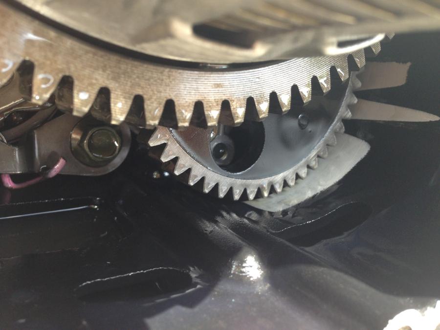

I checked all round and there's nothing I could see or think of that would have caused that , I too thought the previous owner thought but then thought why would you and was stumped at that , although with the speed it rotates it would only take some item ( stumped as what ) to be wedged under bottom of basket for a short while to do it  but seems a but far fetched . Don't know if this is related but when the vibration started gear changes were so hard I had a bruised foot and most times it didn't select and took another go for it to select on up changes but then I changed the oil and that improved a lot , still tough but better , hang on though on bottom of inside casing under basket to right there is no paint just metal silver I thought it was how it is but now maybe something was there , I'm going now to see and post a pic

Ok took off plugs and spun over with case off and clutch visibly off centre when rotated , casing paint worn down under oil pump drive gear (see pic ) but can't see any wearing in side of casing where basket is closest , also all seems tight no excessive play in anything behind casing .
Re: Is this clutch basket a basket case - CRH - 15-07-13
yea looks clean doesnt it?...think if it was me i would remove the clutch and make sure nothings lurking about in or behind?..you may as well now you got cover off!!...not looking good is it? :rolleyes ....

Those marks on the basket look like the normal machining marks, see pic I found on fleabay. I would be surprised if the basket had got warped or anything like that, and the inner part is a floating spring loaded assembly so can all be a bit deceptive on how true it is all running. The bare patch on the casing, I have seen bits like this before, can't explain this one but would guess a bit of post-cast machining, would not worry about it - loads of clearance there.  But if you could put up a video of the bits spinning, sure people will put up thier views..

Tried looking at pictures of basket in manual but they are not clear as to the state of mine being normal re the clean patch on the inside under oil pump gear I thought that is prob oil flow wear as it is smooth .
