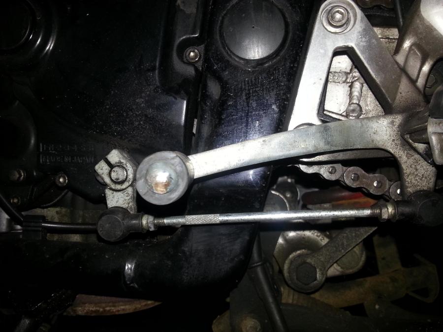

Re: First to Second? - Dead Eye - 11-06-13
There should be two(?) nuts on the bar that goes from the foot lever to the sprocket cover
Or, you can remove the the bolt that clamps it on to the splined bar that goes in to the sprocket cover and move it round for a much larger adjustment (by pulling it off an refitting) - this is what I did. Its a little tough getting it off sometimes so don't be afraid to use a little force

How's about that for a foccing picture ?
Loosen the two nuts, twist rod to adjust and make sure you do the nuts up again. Otherwise you could lose the rod and or find your adjustment changing as you ride.
I couldn't clutchless change up the box until I had adjusted the gear change rod.
Re: First to Second? - Enceladus - 12-06-13
thanks Smile
now for the next daft question.....
shorten or lengthen the rod ?!
(told you i'm thick!)
Re: First to Second? - simonm - 12-06-13
(12-06-13, 09:24 AM)Enceladus link Wrote: thanks Smile
Play around with it until it suits you.  Twisting the rod moves the lever up and down, only trial and error will make it perfect for you.
Re: First to Second? - CRH - 12-06-13
(12-06-13, 09:36 AM)simonm link Wrote: [quote author=Enceladus link=topic=8229.msg81073#msg81073 date=1371025495]
thanks Smile
[/quote]....lowered mine!! made a big diff! Wink
