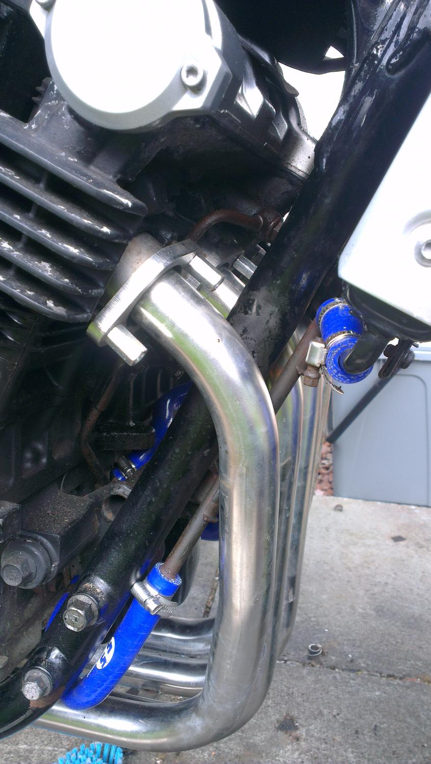

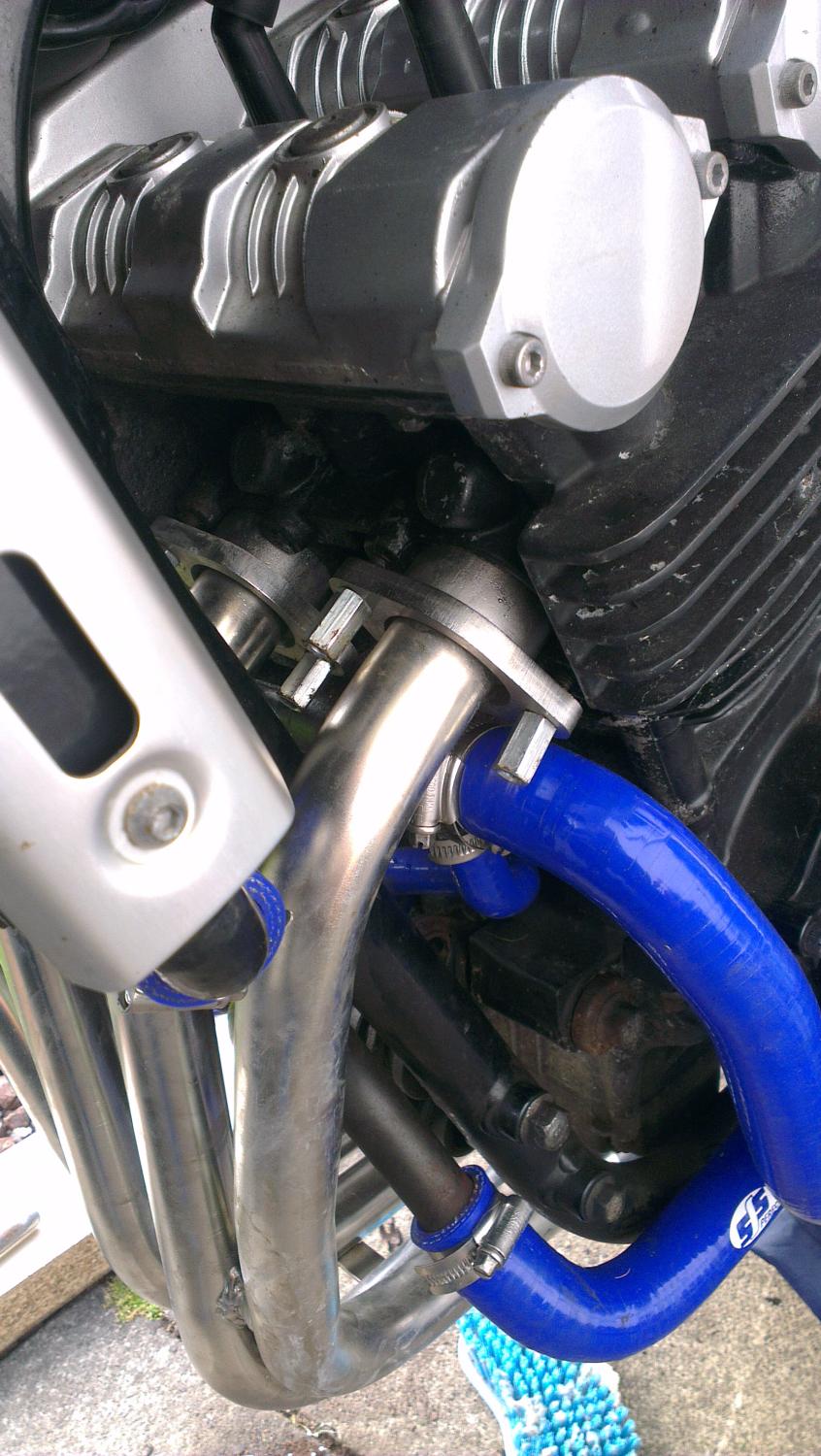

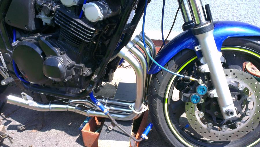

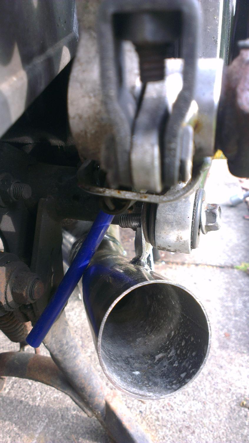

Re: Downpipes.. Old ones off - cant get new Motad ones on - Andy Smith FZS - 10-06-13
Some pics of the downpipes.  don't think the pics of the headers are of much use.
the other on shows the bolt at the back of the exhaust isn't straight.
haven't put the nut on the other side to tighten it but a guess that might pull it into place..
No2
No3
Re: Downpipes.. Old ones off - cant get new Motad ones on - Dead Eye - 10-06-13
The 3rd is nothing to worry about, its just the weight of the pipes pulling on the bolt - gravity is a b!tch Tongue
I do see what you mean about them sticking out a little from the head - have you had her running to see if you have any leaking? If there's no leak from the headers then I wouldn't worry about it Smile
