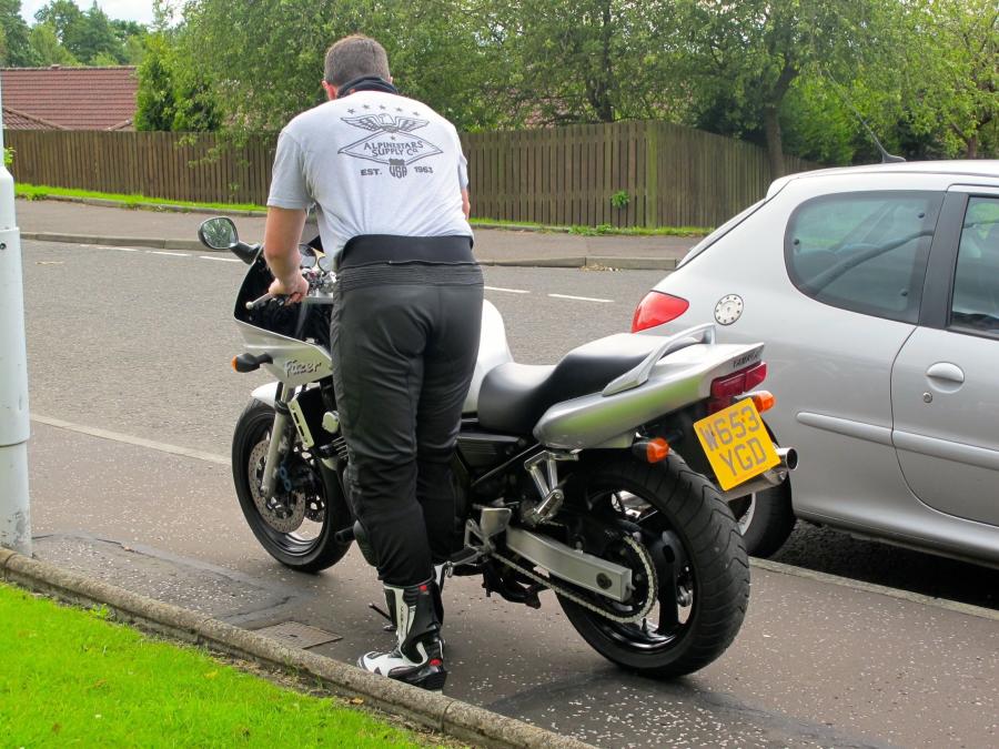

Hey ed heres a pic when i first got it,sorry bout the dodgy photo of my arse :rolleyes  but it shows the seat height quite well compared to me, obviously people are differently proportioned but hey it gives you an idea,like i say im 5 foot 11.
Ill have a rake around for those dogbones but if you want them itll be monday before i post coz im nightshift tonight tomorrow then of course its the weekend.

Thanks noggy i see what you mean, the bike looks small up against you. Don't worry, when your ready and you can for the dogbones, I appreciate it. Just let me know the damage and I'll sort it out with you, thanks.

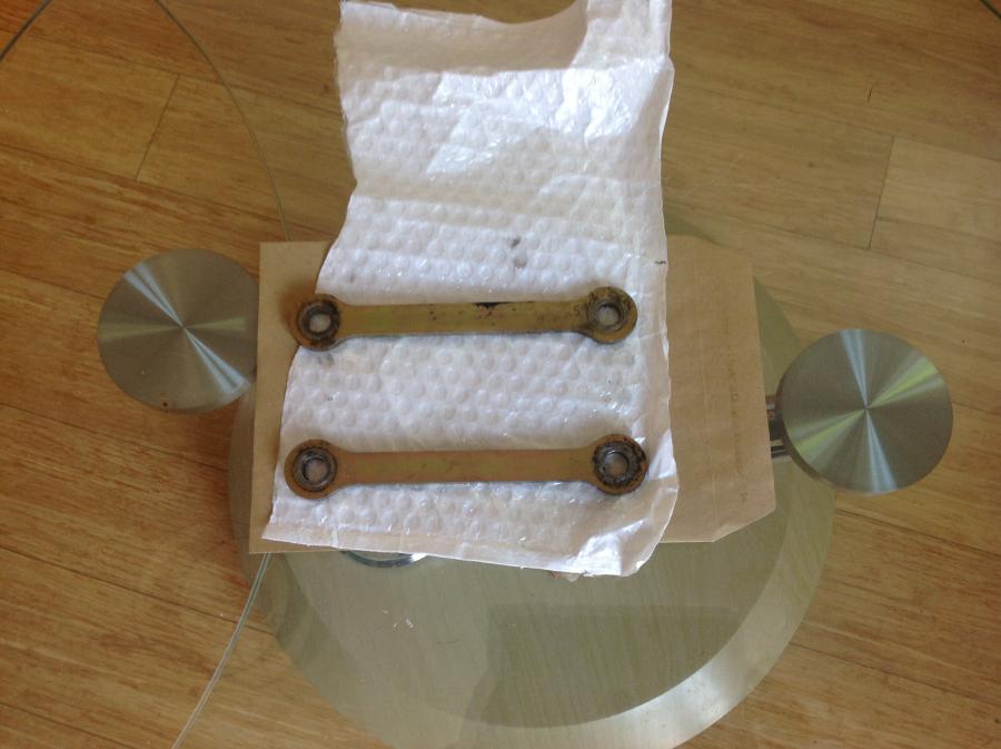

Hey ed, shamone mutha focer :b , look what i found!!!
Before i send them, they are 150mm long centre to centre which should be longer than the ones youve got on therefore lowering the bike but perhaps worth having a quick gander at yours to make sure.
Ill post them on monday by the most economical way, you don't owe me anything for postage, all i ask is that you update on here with a pic & a description of the differences,good or bad so that others can be helped in future.

(06-06-13, 02:14 PM)noggythenog link Wrote: Hey ed heres a pic when i first got it,sorry bout the dodgy photo of my arse :rolleyes  but it shows the seat height quite well compared to me, obviously people are differently proportioned but hey it gives you an idea,like i say im 5 foot 11.
BUT what an arse, :lol  and "hot stuff" just came on the radio!!

(07-06-13, 05:24 PM)Skippernick link Wrote: [quote author=noggythenog link=topic=8174.msg80008#msg80008 date=1370524461]
ahoy sailor!!!! :lol

Standard dogbones should be 140mm centre hole to centre hole. Even a few mm will make a difference to the bike.

Re: Lowering an FZS 600 2002 - darrsi - 10-06-13
Just get a ruler out and quickly measure centre hole to centre hole of the dogbone, if it's not 140mm then it's been modded!
It'll take you a few seconds to do and give you a clue as to what needs doing!
