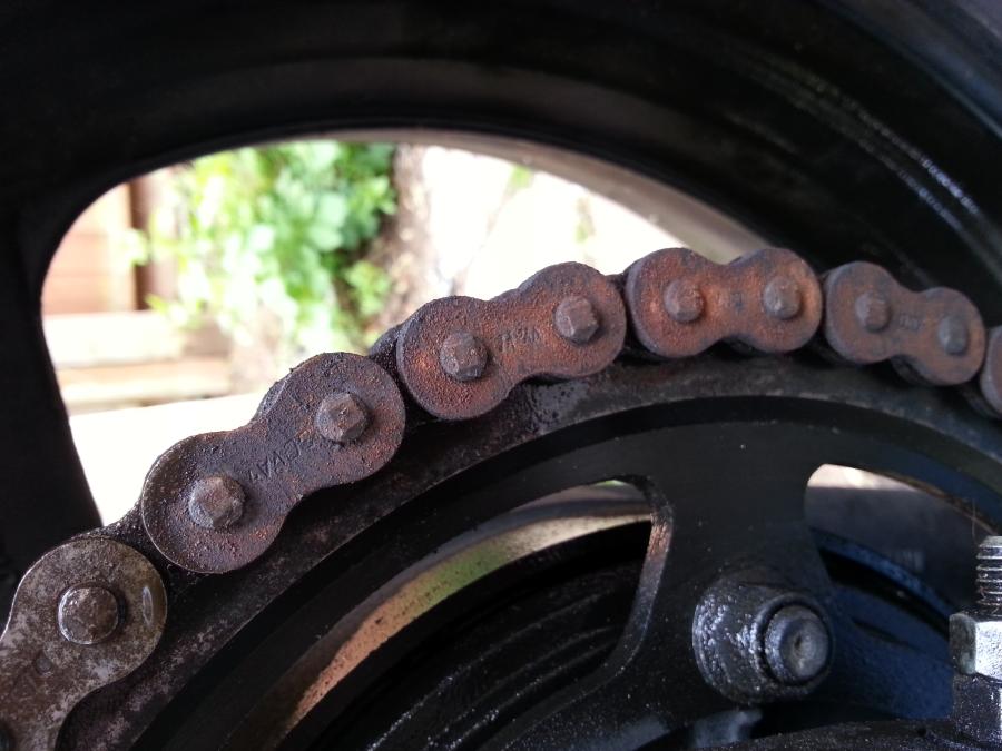

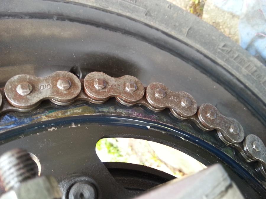

I know nothing about bikes except that the copper on my bikesafe course said my chain was minging.  A small amount of research later and a slightly squashed finger and it's done.  I used paraffin, a rag and toothbrush and used some scottoil afterwards to relube.
Two pictures, before and after. Was there any point ? Any tips ?  How do you clean the side of the chain you can't see ?
Cheers
Re: chain cleaning - Dead Eye - 16-05-13
Looks cleaner, but in both pics it looks too dry - need to get some more oil / lube on it Big Grin

Re: chain cleaning - simonm - 16-05-13
(16-05-13, 01:54 PM)stevierst link Wrote: Fit a chain oiler, then you won't need to clean/ lube it any more:Smile
It has a scottoiler ! It wasn't doing its job though.  The controller only seems to oil the inside of the links/sprocket rather than preventing rust on the outside ?
I've only had the bike 4 months or so and I may need to check the instructions.  I put the controller on prime a week or so back to check it was working and reset the drip rate so hopefully it'll improve.
I figured if the controller hadn't been working for a while (the bike had been left standing for a couple of years so the rust may have come from there) it was best to do some manual maintenance.

Re: chain cleaning - Slaninar - 16-05-13
(16-05-13, 11:53 AM)simonm link Wrote: I know nothing about bikes except that the copper on my bikesafe course said my chain was minging.  A small amount of research later and a slightly squashed finger and it's done.  I used paraffin, a rag and toothbrush and used some scottoil afterwards to relube.
Cheers
Here's what I'd do:
1) remove that rust
This will help:
http://en.wikipedia.org/wiki/Ballistol
But you can use any other rust removing oil - even WD40.
2) Put some oil to prevent rust from occuring
Put some engine oil on a rug and wipe the chain with it - to make the outside of the chain a bit oily, just a thin layer.
3) Your scottoiler is doing it's job - making chain lubed on the inside where it matters - that will help it last longer. It should not oil the outer plates of the chain (the part that rusted on your chain). That is your job with cloth and some engine oil.
