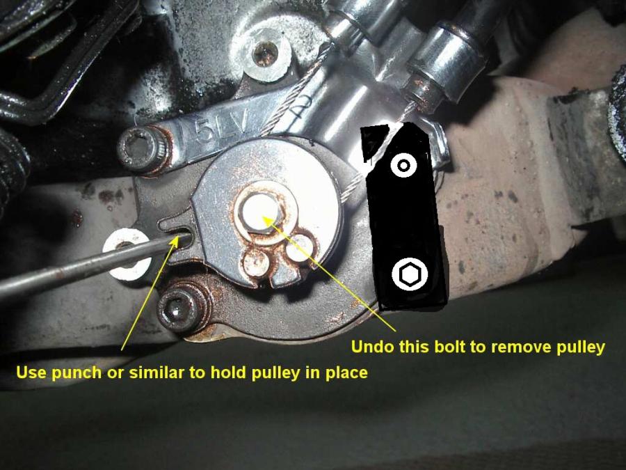

Here's a quick diagram of what' I've done (thanks to cartestsoftware's website for the picture!).
Rivet top
Cover allen bolt below.
Black bit is the metal bar!
