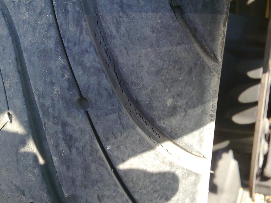

Hello Foccer's, am after some opinions on my tyres. Bought last summer less than 10 months ago and covered about 4K. PR3's. I noticed today that the rear is starting to perish in the grooves. The front is fine and there is still plenty of tread on the back but it has started to develop cracks. This can't be right surely. Would this affect my MOT ? and  what do you think  my chances are of getting it replaced ?  Maybe there are some tyre experts on here who can tell me what would cause this. Thanks. Wink

I would contact the manufacturer with those pics and see what they say. If they are cracking like that then they will have lost some flexibility in the tyre and therefore could compromise grip. It doesn't look that bad but I'd be wanting to get them changed.

Yep, still got the receipt and am on good terms with my local Watlings where I got them from so hopefully wont be a problem. I'm just  intrigued as to what would cause this. I always check my pressures, haven't contaminated it in any way but did have a blast around  last year where they got very hot but they are designed to do that, aren't they ?

Interesting, but have my doubts as to what caused that. Smoking his rear tyre or continuously locking it up maybe when you look at the wear on the tyre. Mine however is an  entirely different type of defect. I will start at the tyre fitters on Monday I think. See what they have to say about it.
Re: Perishing tyres - mcsuffolk - 06-04-13
Worth speaking to tyre dealer, but what was the date of manufacture on the tyre?
I've seen this sort of thing before and tyre manufacturer said it was because the tyre had passed its six year life. Until that point I didn't realise tyres has "best before" dates..... Apparently it's something to do with chemical breakdown inside the compound...... Hence all tyres have a date mark on the sidewall..... It is normally a week number (2 digits) followed by a year (2 digits) and normally appears slightly different moulding from the size etc.....  So may be something like 4209..... Week 42 of 2009
Re: Perishing tyres - dBfazer600 - 06-04-13
I had this on my car tyres which were mitchellin. It came after a harsh winter. I will not use Michelin for any vehicle as they they were only 2 years old with 3k on. Car got steering wobble around MPH so be careful if its the same type of thing.
Be interesting to see what the fitter and mich have to say about it though.

It could just have been a bad batch... It's not unheard of.
Maybe with the hard use on a trackday and the higher temps etc then if it does have a defect then it has been highlighted whereas with normal road use it may have gone unnoticed for longer.
Like I said in my first comment, best to get in touch with manufacturer. They'll probably replace it, especially seeing as it's fairly new. They may be glad to get it back to do tests on it to make sure things like this don't happen. Useful info for them too.

Checked the date stamp and it read 1411 which I take it to be week 14 2011 so well within its shelf life. Front was 1112.
Re: Perishing tyres - dazza - 10-04-13
Update for those that are interested. Not good news, looks like I'm going to have to fork out for a new set of tyres. On closer examination the front is also slightly cracked which has ruled out it being a bad batch as they are completely different year codes.  Spoke to the Michelin rep and had them looked at by a fitter who is experienced in bike tyres and both are baffled by it and haven't seen it before with these. So, they are going to be sent away for examination but in the mean time I have to stump up for replacements. I asked if as a goodwill gesture they would meet me half way with the cost but was met with company policy and any gesture would be admitting liability. However once they have been examined a goodwill gesture or a full reimbursement can be made depending on what they find. My confidence in them and Michelin as you can imagine has took a dive and now am unsure what would be best to replace them with.  Any suggestions ?
