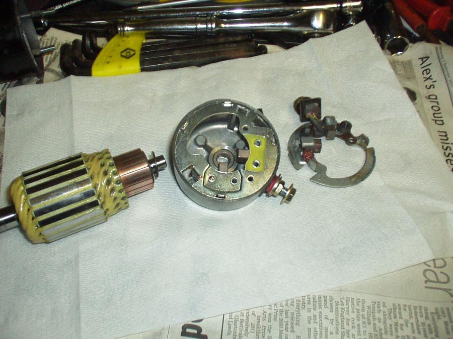

Got another evening out on the bike last night (well from 11:30pm onwards), have had the starter give me jip a couple of times and had to rock the bike backwards to nodge it so that it will work, so I had bought a starter brush plate kit a while ago, this included o-rings, bushes and oil seal. Decided while the carbs are off, it's ultra easy to get to so now is the time.
Removed, stripped, found brushes not too badly worn but one of them sticky, probably a clean up would sort it but I had the new plate :rolleyes , gave everything a clean fitted new plate, used new lip seal & o-rings and put back together with a bit of silicone grease. Did not use new bushes, the rear one felt fine ( :lol ), and the one at the drive end is a roller bearing on mine.

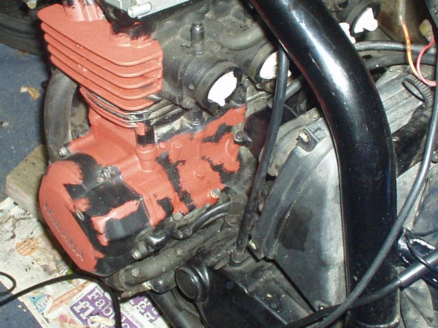

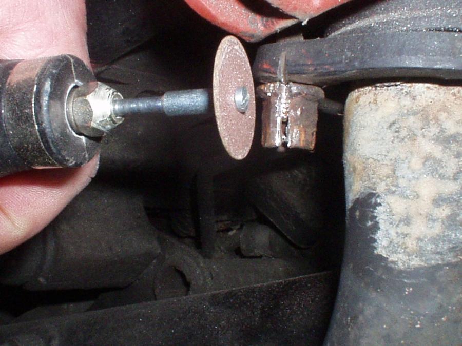

At the weekend I decided while I have the rad off it's the time to sort my exhaust studs,  seen a few posts about this and bean absolutely dreading it.  Been soaking in plus gas since i started the other bits, tried undoing one that would be relatively easy to drill out, did not like the feel of it  :eek !!!!  Tried a nut splitter, but what had looked like a washer was a flange and part of the nut, so tool could not be held straight to cut the thickest bit, so that was that  :rolleyes .  Had seen that Tilts had cut his with a Dremel, decided this was the way to go - cut deep into the clamp plate to get through the flange part, fiddly on some the 600 has an extra member across the frame, used a flex drive to get at the worst. Small cold chissel to crack the last of the thread and to start Knocking them round. Worked well, just fiddly, all off stainless steel nuts on with a bit of copper slip  Big Grin  already for a stainless exhaust .... soon
Re: Got Committed - Buzz - 04-04-13
Good work, I've got to do mine soon so am assessing the best way like you...
1) Did you dremel both sides of the nut?
2) Did you damage the threads on the screw underneath at all? I'd worry about getting those SS nuts back on after taking a gouge of of the thread.
3) Was a good whack with the chisel in the gap enough to split the nut and remaining thread?
I guess you could've used the Dremel to get through the flange on either side then use a nut splitter?
Sounds like the way I'm going to go anyway, looks like a lot more work but much safer than snapping studs...something which I'm guaranteed to do!
Re: Got Committed - Ebme Geek - 04-04-13
No, I only cut down one side of the nut, really impressed with the dremel cut off wheels, but they are brittle, shattered one getting it into the gap before I turned the drill on. I did tweak the mandrel to get the disc running as true as I could. And I used a flex drive to get at the more awkward ones.
I found dont cut to mad keep lifting the wheel and you start to see the threads appear and you can still attack the bits you are not there on yet.
Choose where you cut down the nut so that you can get a chisel in with room for a hammer at an angle so that you are both splitting the nut and driving it undone at the same time 45˚ sort of thing, I found as the last bit cracks they start to undo easily, once you have 1/8 to 1/4 of a turn on them they come off with a socket and extension by hand (no ratchet)
Have the chisel reasonable sharp, not a razer but not round ended either, just enough so it grips in the metal.
I did catch a couple, thread damage was minimal with no burs, so quick swipe with brass wire brush and ss nuts went on with no problem.  Big Grin

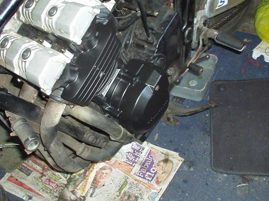

Update for the last couple of nights, got back out to the shed again, cleaned up some of the worst of the flaking engine paint, and primed it up with special metals primer, that was enough back in the house rum'n'coke and then crashed  :z .
Last night back out, had to warm the engine up with a fan heater, ( really need new garage door, one that I can close!! ) before I could start spraying it black again. In between coats gave the carbs a good external clean up and lubed movey bits ready to go back on bike. Third coat done, prep to crash out with a rum  :lol ....  :z
Sh1t that shed get cold but, Fealing Like I am getting there now, should be running soon  Smile , I am getting desperate,

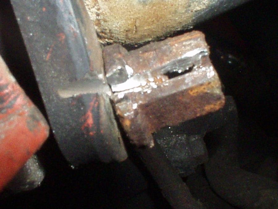

  Well, I went out to the bike on saturday to get the carbs back on, and spotted the corrosion I had forgotten on the cast pipe spigot of the water pump, looked like a point for leakage in the near future, so get it sorted now! Pipes off, took the steel pipe next to it off to give better access, clean up the spigot, clean the inside of the rubber hose, smear of silicone grease on both, pipe back on. Dam! I should have given it some paint, oh well degrease the exposed bit and give it some. Never know the sealing part might last longer that way rather than bubbling under the paint.  Wink .  Could not help myself cleaned and sprayed the steal pipe aswell.

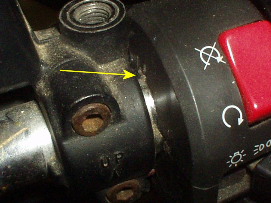

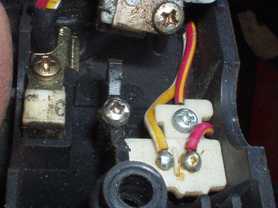

Back to the carbs, I thought while I am at it I will lube the choke and throttle cables, that took me to the handle bars and I remembered the way the switches swivel when you use the choke or hit the starter really hacks me off. I don't know what the history of the bars is, but the plastic lugs in both switch assemblies had either been sheared off or removed, and the holes in the bars did not line up. On the right hand side I cut a bit of stud and glued it into an existing hole in the handlebar, and filed a notch in the side of the switch assy. On the left where the lug had been I put a self tapping screw, drilled a new hole in the handlebar. Sounds simple enough but both sides took stupid amount of time. Greased up the choke cable with one of those clamp on tools and can of chain lube, then got that side back together.

Another session in the garage last night,
Tighten carb & air box clamps + bracket, fit pain in butt rubber cover and tank bracket,
water deflector under tank,
radiator, harness junction box, thermostat housing, coils and pump assy,
fill up coolant,
Still had clutch cable detached at top from doing switches, so decided to grease it now rather than get forgotten for eternity. All went well until I pushed sheath back and it came un-hooked at the bottom  :rolleyes , so sprocket cover off to sort, dropped peg off cleaned & greased gear linkage including  main pivot,
3am by then, but I was determined I was going to have it running, grabbed the fuel tank & put it on backwards over the seat area on a good bed of rags.
Primed up the fuel, the pump only runs for something like 5 secs then stops without the engine running, so turned the ignition off and then back on again untill its clicks slowed down and stoped, carbs full now.
Fired up easy but noticed a coolant leak, one of the hose clamps had gone tight on it's thread but not clamping tight  enough on the pipe, tried bit of lube and tighten it, oh-er, but no play Wink , so found another clip, sorted.
Fired it up again no probs, kept an eye on coolant level, bit of smoke from the plus-gas I had used on the exhausts, well quite a lot actually  :o
But Happy at that  Big Grin .  So rum 'n' coke time and then crash out  :z    work in the morning
