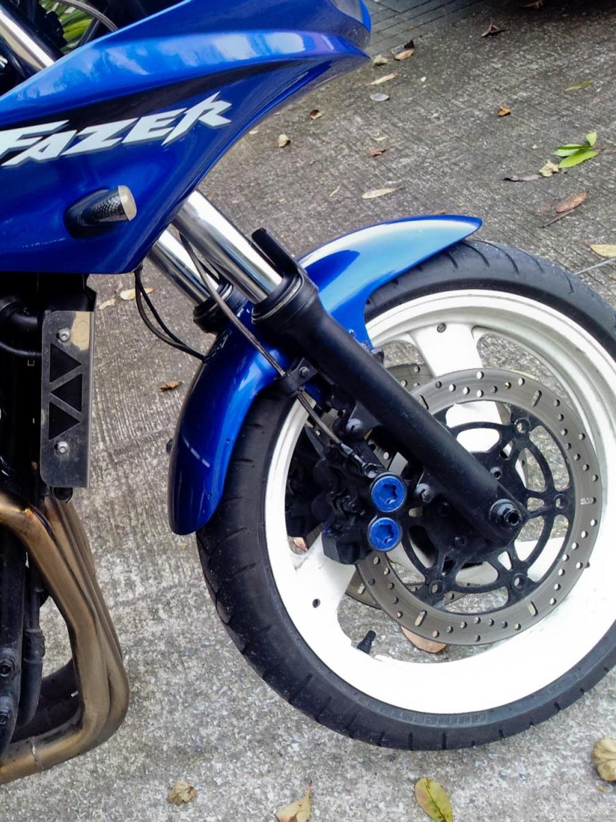

I did mine about a week ago. I did my inner brake disc and caliper too as well as the Blue Spot. I didn't bother with Primer or Laquer. Its still glossy enuff and its simple to touch up if it gets chipped ect.
I just took off the wheel and did the forks on the bike. I gave the forks a rub of 600 grade sandpaper first. It probably would be best to use a primer but I couldn't be ar*ed. Just be careful putting the wheel back on and that the speedo is correctly installed or you can damage the unit.
Re: Front Fork Respray....... - packie - 31-01-13

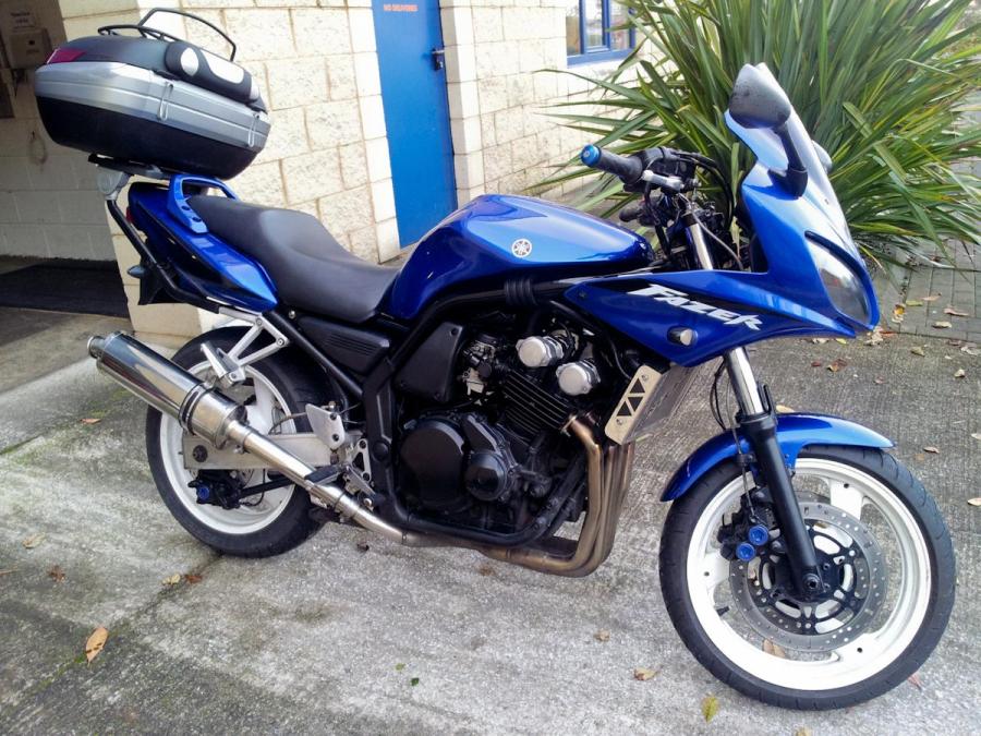

Oh....thats dirt on the fork leg in case you think it looks a bit rough and tatty. The forks came up as it they were professionally done. I can post a photo of them clean tomorrow if you want. I prefer the black job to the silver originals.
I was going to do those two outer cam covers in Blue....wadda ya think? I suppose if I don't like it, I cud always polish them back to metal again.
This might be a better photo. This is with no primer/Laquer and after a week and a half of stormy weather and Irish pot holed roads!

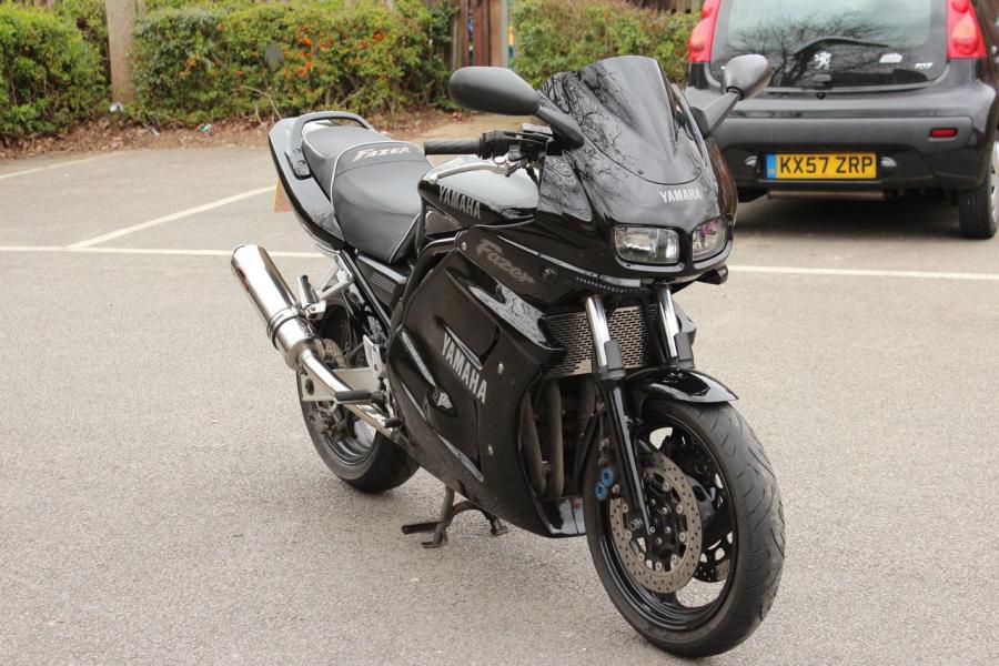

Love the fairing lowers btw, who makes those and what sorts price? wouldnt mind a set for my gen 1 thou
Budgie
Re: Front Fork Respray....... - fazerblue - 02-02-13
:lol Yep you are right I should check before I press the send button I got my lowers from M&P cost about £120 worth checking their site to see if they do them for the thou.
