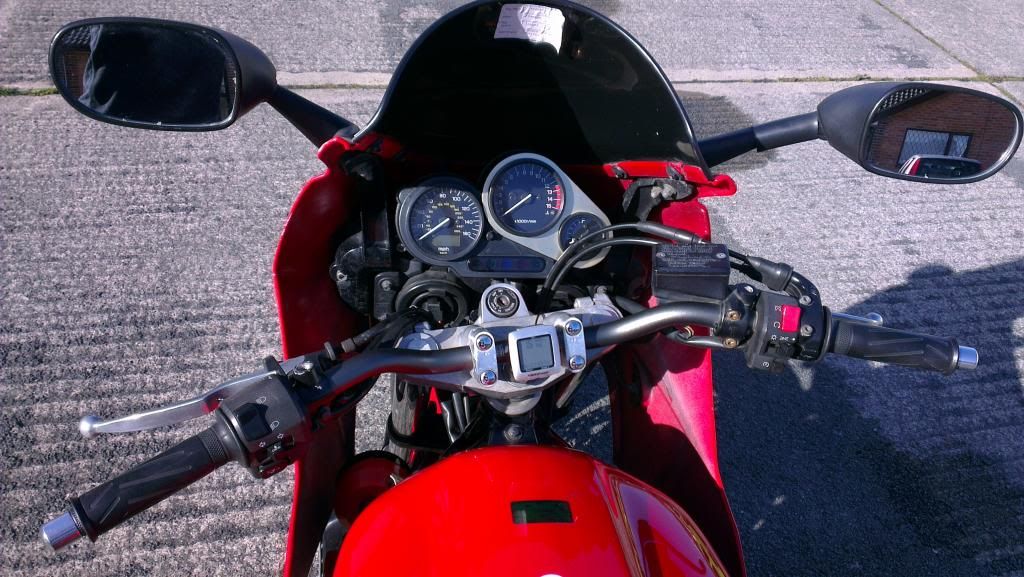

Re: Handlebars - trudd - 20-01-13 Doesn't really answer the question but I posted a picture in the following thread that shows the difference in sweep angle of my Renthals. http://foc-u.co.uk/index.php/topic,5853.msg51627.html#msg51627 Re: Handlebars - wezdavo - 20-01-13 (20-01-13, 09:37 PM)trudd link Wrote: Doesn't really answer the question but I posted a picture in the following thread that shows the difference in sweep angle of my Renthals. I take it the 754's or of a similar height to the oe bars? Re: Handlebars - trudd - 20-01-13 Yes, pretty close. Re: Handlebars - wezdavo - 20-01-13 (20-01-13, 08:55 PM)stevierst link Wrote: +1 for the 758's, or ultra lows as they're also known. miles better than standard bars for the FZS 600 :b Thanks mate, got any pics?? Re: Handlebars - kebab19 - 21-01-13 Renthal 758's mentioned on the old site, mostly as fitted to the 1000 but then the fairing's the same as the foxeye 600 even if the risers arent: http://fazerowners.yuku.com/topic/33138/RENTHAL-ULTRA-LOW-BARS-758#.UP0HqvLfUoE http://fazerowners.yuku.com/reply/234834/758s#reply-234834 http://fazerowners.yuku.com/topic/14391/renthal-758-advice#.UP0JIvLfUoE http://fazerowners.yuku.com/reply/115248/flatter-bars#reply-115248 http://fazerowners.yuku.com/reply/50807/bigger-handlebars#reply-50807 Someone else preferred Renthal 754s instead: http://fazerowners.yuku.com/reply/269183/Renthal-Low-better-than-Ultra-Low-Just-Different#reply-269183 I had Rental 789 'streetfighter' bars with brace fitted to my old 600 but they fouled the RHS fairing on fill lock Re: Handlebars - stevierst - 21-01-13 I had a set of 790's that also fouled the fairing badly on full lock, it's a shame, because they were perfect for me on my Tiger 1050. Here's a pic of my old red Fazer with ultra lows fitted. ![]() I rolled them quite far back to make them cosy, and filed off most of the switchgear lugs so they still gripped the bars. I think mine 'just' touched on left lock, but then, my fairing wasn't exactly straight! :lol Re: Handlebars - wezdavo - 21-01-13 Thanks everyone Got the renthal 758 on order
