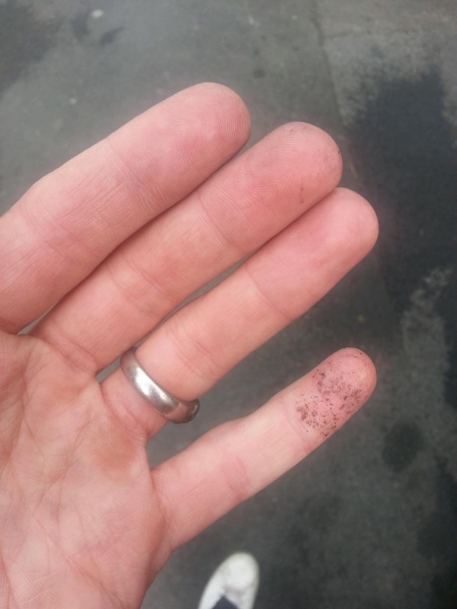

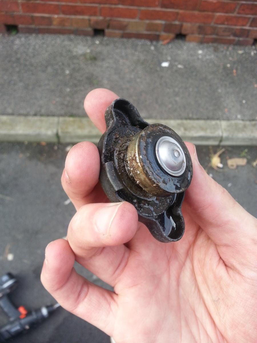

There was, however crap in the water (thats a technical term!) which I've tried to get photos off in the two pictures below. Could that be some kind of additive that was in the water rather than bits of head gasket?

Dirt on the cap maybe Rad Seal or something similar?

When the engine first over heated it could have loosened all sorts of crap which may be what you are now seeing. If you run the engine with the pressure cap off and see loads of bubbles in the water, that would indicate the head gasket has blown. Darrsi's suggestion for locating the source of the leaks sounds good. Otherwise a short ride might reveal where the water is coming from. If after a short ride the plastic tank has considerable more water in, then again it could be the head gasket due to the system becoming over pressurised.

cheers for responding Darrsi, it may have been rad seal, not sure. I didn't think of checking the oil window for water... I'll do that in the morning when I have some light to work with!

The crud on your radiator cap could well be an emulsion of coolant and dirty oil and it COULD result from a head gasket failure but its worth checking the pump first.
