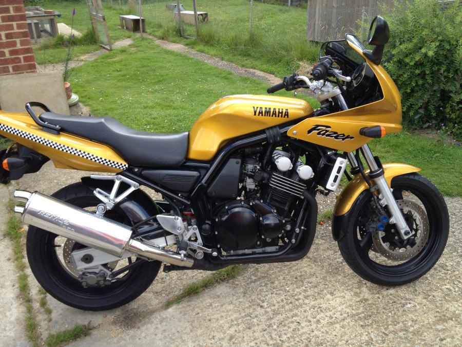

Uncomfortable Bike - derildo - 14-08-12 Has anyone ever bought a bike that they just did not get on with? I have a '00 FZS600 which I bought from the guy who bought it brand new, he only managed to put 3.5k on it in 12 years. so I was chuffed to bits when it came up for sale as it is in really lovely condition. However every time I ride it I cannot wait to get back home and stick it back in the garage. I feel that it cants me forward and puts all the weight on my wrists and after a while my hands start to go to sleep. Also I find the seat / footpeg distance too short so that my legs are bent up. As far as I can tell the bike is standard, forks have not been dropped in the yokes and the dogbones on the rear suspension are standard length: 135mm I tried renthal low bars and that improved it a bit, I went for an 80 mile ride and after 30 odd miles, same problem with my wrists and me arse joined in! Total misery! :'( I next tried renthal highs, back to square one. I have had Bandit 600s, a ZRX1200R, Bulldog, Freewind and Breva 750 in recent years and I cannot recall ever being so uncomfortable. I know I could go on and get the seat refoamed and all that but I have had enough and will be putting the bike up for sale. Its such a shame cos its a fantastic bike, handling, brakes, engine etc. Just does not seem to have been built for me: 5' 10" with 29" inside leg!!! Re: Uncomfortable Bike - GringoRojo - 14-08-12 ?? have you compared it side by side with another one? what fairing does it have - square lights or foxeye? and 3.5 K in 12 years? jees, that's not even run in and I'd wonder what it's like inside no matter how polished it is. Re: Uncomfortable Bike - Lazarus - 14-08-12 have you tried rolling the bars to another position - i did that with mine and it makes it a little more comfortable for me Re: Uncomfortable Bike - markbubble - 14-08-12 i find my fazer mega comfy(its a 98 model)i had a suzi rf600 that was ace but totally did my back and wrists in so had to sell due to bad back,almost gave up on biking but was recomended the fazer which wasnt my ideal looking bike at 1st(love the look now)and i love not only the comfort but the ride handling,fuel econmy etc etc as already mentioned try twisting the bars around,different grips(surprise how much this can help wrists/hands) you might be able to get risers etc for bars and pegs etc Re: Uncomfortable Bike - MEM62 - 14-08-12 There is no way a bike of that type / design should be placing a lot of weight on your wrists. Have a look at the suspension - if you have a manual return all settings to standard and see if that makes a difference. Re: Uncomfortable Bike - locksmith - 14-08-12 (14-08-12, 04:16 PM)MEM62 link Wrote: There is no way a bike of that type / design should be placing a lot of weight on your wrists. Have a look at the suspension - if you have a manual return all settings to standard and see if that makes a difference.I'm with MEM, hasn't had rearsets fitted maybe? Post a nice side on picture for a better understanding. Re: Uncomfortable Bike - rustyrider - 14-08-12 I'm 5' 10" but with a 32" inside leg and, since I rotated the bars back towards me a little, can honestly say that the Mk1 Fazer is the most comfortable bike I've ever ridden. Your bars may simply be set too far forward if it is putting your weight on your wrists. Rotate them back until they trap your thumbs on the tank on full lock then move them forward a touch. Re: Uncomfortable Bike - Grahamm - 14-08-12 (14-08-12, 01:41 PM)derildo link Wrote: Has anyone ever bought a bike that they just did not get on with? This site might be of use to you. You put in the bike you want and your measurements and it will show you whether it's the right fit for you. Re: Uncomfortable Bike - locksmith - 14-08-12 What a cool site Graham, thanks for sharing! If you add more than 1 bike and use the scroll wheel on the mouse it morphs between the seating positions so you can see the differences. Re: Uncomfortable Bike - derildo - 14-08-12 Thanks for the replies.......... As far as I can tell the bike is bog standard, I enclose a photo, see what you think. The rear suspension is set to the fourth from top on the preload collar. When I got the bike one or more of the pilots was gummed up. Put it into Bike Moto in Pompey who removed/cleaned/replaced the carbs and fitted a new set of plugs. They said it was a good'un. I will have a go at moving the bars back to see if that help...... Don't suppose you would recommend Apehangers? cheers all Re: Uncomfortable Bike - derildo - 14-08-12 Grahamm Thanks for that link, have compared the Fazer with bikes I have owned in the past and can see that the Fazer does make me lean forward more. Perhaps the lean angle is getting more critical for me at my age wiv me aching joints................ Re: Uncomfortable Bike - manuel32 - 14-08-12 The bars are very high compared to other styles of bikes so should be the comfyist bike ever,,have you tried a race rep, then you will see weight forward. It looks like a nice bike to ride, cant see any other being better. Re: Uncomfortable Bike - His Dudeness - 14-08-12 cruiser style could be the way to go to get the weight off your wrists Re: Uncomfortable Bike - rustyrider - 14-08-12 Those bars are much further forward than mine. Try tilting them back. Re: Uncomfortable Bike - goldfazer - 14-08-12 I tilted my bars fwd a bit and had some extra foam put in the seat as I found the legs a bit cramped. May help you. Re: Uncomfortable Bike - CRH - 14-08-12 i had the very same problem with mine!! ime also 6ft and 29inch leg!!...what i did ( and it appears to have sorted it)...is to add bar risers 25mm and rotate bars forward slighly!!!....what a difference thats made
