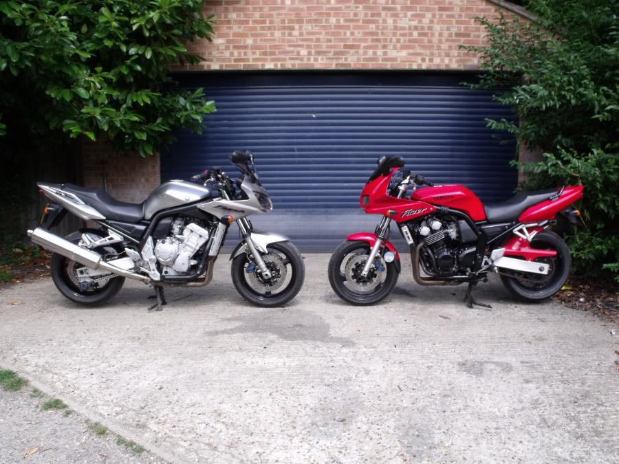

Re: Considering changing mk1 600 for a 1000? - red98 - 12-08-12
lots of help there.........but everyones missing the main difference......................ones red the other silver
Re: Considering changing mk1 600 for a 1000? - CRH - 12-08-12
:rolleyes ............boasting are we red?.....your garage door in better nick than my thou!!!!.... :'(
(12-08-12, 02:40 PM)CRH link Wrote: :rolleyes ............boasting are we red?.....your garage door in better nick than my thou!!!!.... :'(
i wish....my neighbours garage,mines just a single  :\
