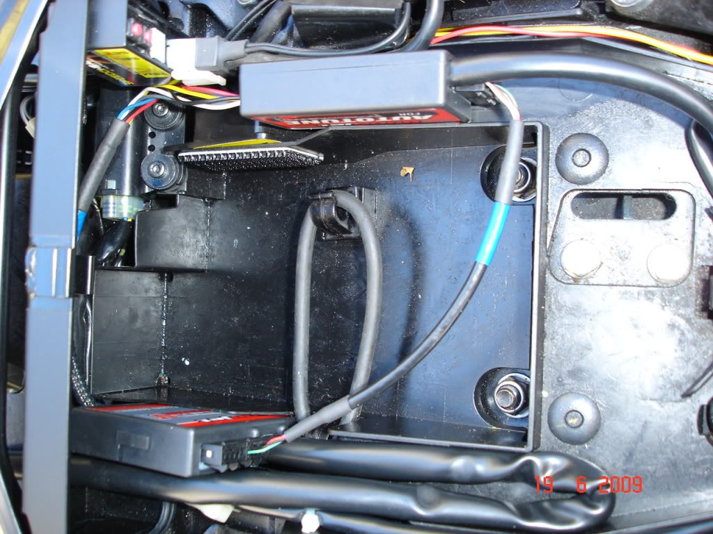

Re: Power commander 3 were to put it ? and a question - chaparral02 - 12-08-12
(08-08-12, 07:42 PM)wfbroddy link Wrote: ....Any ideas ??
Do what i did and sell the PC3 and buy the smaller PC-V
Picture of my PC-V + Autotune + Speedo healer fitted under rear seat ...
[Image: DSC00368.jpg]
