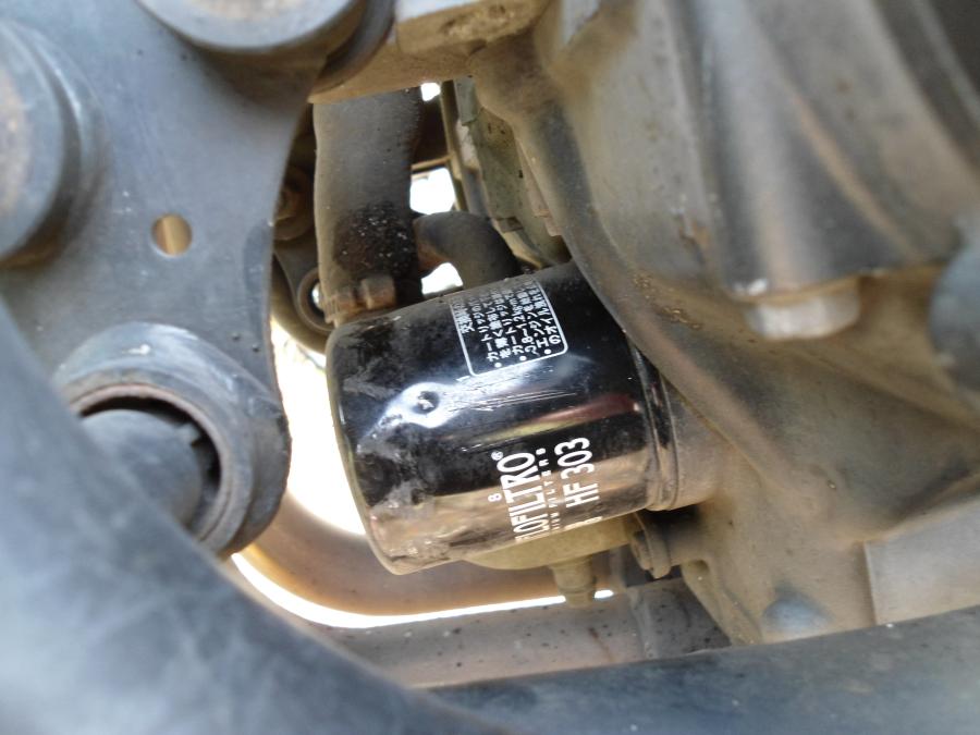

Hello peeps, recently whilst doing an oil change and using the correct removal tool it rounded off the end of the filter. Am wondering whether I should have let it cool down more before trying to remove it or the obvious and not nip it up so tight :\  but the damage has been done now so has anyone also had this problem and how did you get round it ? Please don't tell me to stick a screwdriver in it.

first oil change on my bike about 4 years ago had the same problem. Resolved with a chain tool. It doesn't get put on so tight now!!!
Re: oil filter rounded off - richfzs - 31-07-12
aye, chain whip is the answer. its a feck on, not a lot of space to work in, but possible (or at least it is on the 600). Certainly better than a screwdriver through it!!

A fussy but effective method that I've used:- Drill two 6-8mm opposing holes in the hexagonal rim of your 'removal tool' and bash it back on to the filter. Next, get a pointy screwdriver thing and bash two holes in the filter through the holes in the removal tool, a sharp tap with a hammer does it. Next, the clever bit, screw two short fat wood screws through the holes, I used a couple that I found at the bottom of my cabinet, I'm sorry I don't know the sizes, obviously make sure the screwheads are grubbed up against the removal tools rim. Re-insert driver and lean on that breaker bar.
If that doesn't work for you and the filter seems to be just twisting and mangling up, use the screwdriver method.
Re: oil filter rounded off - solorider - 31-07-12
mine was very tight and i used a screwdriver and hit it on the lip where the filter screws on and it unscrewed with no issues
Re: oil filter rounded off - misterjayb1 - 31-07-12
The newer wide strap type on half inch drive seem to work well.. Once filter is knact going the screwdriver route you strugglin.. Had chain type rip thru a stubborn filter too.. Yes do it with engine warm..  Smile
Re: oil filter rounded off - tex - 31-07-12
There is a hard centre in side where the thread is, i ripped it open and used molegrips!
Re: oil filter rounded off - BMCfaz - 31-07-12
What's wrong with a screwdriver? Are you planning to re-use the filter?
I've used a chain-type wrench before, and it can make as much mess as a screwdriver!
If it's a frequent problem and you don't like the total destruction methods of removal, try the K&N filter with the nut on the end, no more filter wrenches needed.

If it's being stubborn a  big pair of water pump pliers usually does the job for me.

I use a bit of old grey plastic fall pipe, it's a tight fit just push it on and grip with both hands and unscrew it.
If it slipped, which it never has I would put some self tapping screws through it into the filter.

Easiest way - no tools needed.  First clean the filter with white spirit or similar just to get the oil and grease off the outside. Next wrap a couple of loops of masking tape around it, then twist the masking tape around so that the sticky side is now facing out and continue to wrap it around. Finish by twisting the tape back around and sticking it to itself.
The filter should be removable by hand now due to the grip afforded by the sticky tape.  Probably works with duck tape too.  Smile
Re: oil filter rounded off - red98 - 07-08-12
ive got quite a few filter removal tools but the best is a chain type wrench with no chain  :eek  instead it has an 1" wide nylon webbing,wider than a chain so wont dig in and tear the filter  Wink ....never let me down,and good in tight spaces...cheap too...............oh and...fits on a 1/2 drive entension and ratchet  Smile
