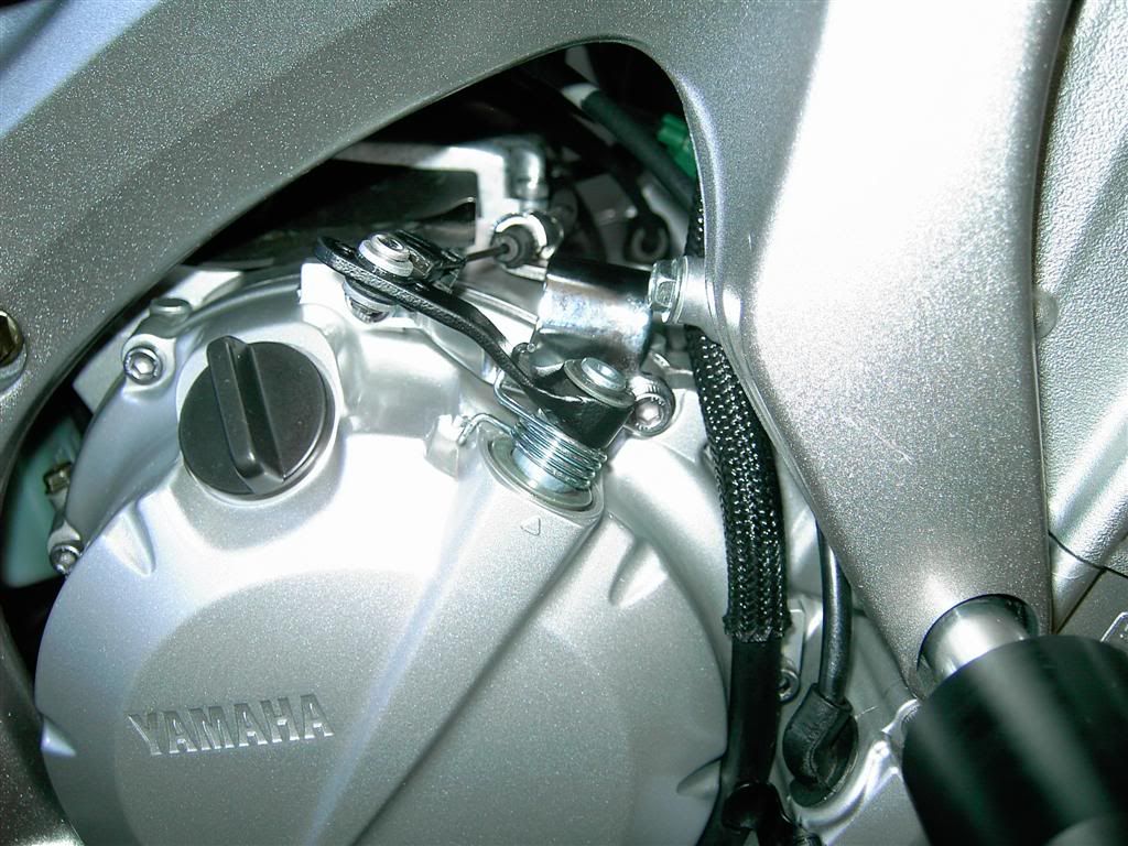

killernoodle - ddtwelve - 25-07-12 Been looking on the fz6-forum.com and bonemans site and im wanting the clutch slave lever mod does anyone know if anyone does it over here or if killernoodle is still doing them cheers david Re: killernoodle - Grahamm - 26-07-12 An interesting mod, despite my best efforts I still occasionally have problems with the clutch being a bit "snatchy". According to this thread I've just found, it seems the guy is doing them, although rather than take bits off your bike to send to him (and thus being without a bike) others have suggested buying new parts, shipping them to him for the mod, then he sends them back to you to fit. He says: Quote:The primary purpose of the lever is to make the clutch pull of the bike longer for a smoother engagement and less lever force required to disengage the clutch. This prevents stalling at lights, jerking between shifts, etc. It also makes your left hand happy from the reduced tension on the shifter lever. The bike generally becomes easier to ride, even easier to drag race. There's more details Here's a pic of what it is if you've not seen it... ![]() Re: killernoodle - ddtwelve - 26-07-12 Surely someone on here knows how to cut and weld a few bits of metal together

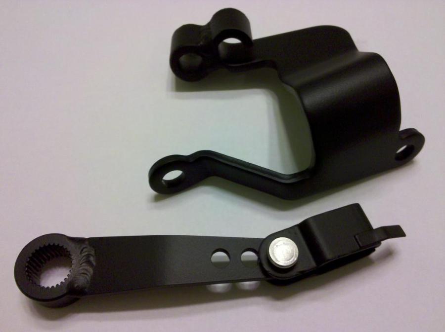

Re: killernoodle - chris.biker - 27-07-12 What is that needs doing. Re: killernoodle - ddtwelve - 28-07-12 as you can see from grahams post there is a new black extended slave arm , also on the cable route bracket there is a new cable holder will put pics up when i can Re: killernoodle - chris.biker - 28-07-12 So its a piece of tube added to the cables sleeve end bracket and the clutch operating arm lengthened. If that is the case no problem, is the idea you would send me the parts to modify. Re: killernoodle - ddtwelve - 28-07-12 yep can order the parts from ajsutton about £25 send it to you

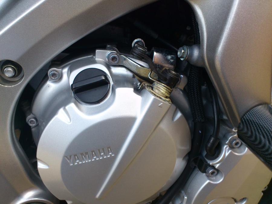

Re: killernoodle - ddtwelve - 30-07-12 here a pic of my clutch slave unit to get a judge of sizes Re: killernoodle - ddtwelve - 30-07-12 :rollin oops might as well post it hehe |
