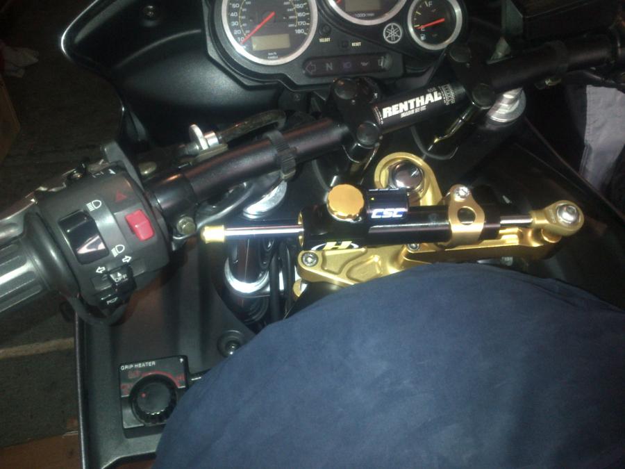

just tried fitting a Hyperpro steering damper and found it wont fit - the piston rod makes contact with the flat handlebars as you turn left. Question: is there a mounting kit that sits lower than the one pictured (there's plenty of room i think - the one supplied was the Hyperpro SD Mounting Kit) or is the only solution higher bars?
or only turning right... (thought I'd get that in, saving you the agg.)
cheers!
S
Re: Hyperpro steering damper won't fit - Tmation - 13-07-12
Obviously designed to work with the standard bars. You could fit some bar raisers from someone like SW Motech, lots of choice here http://www.motohaus.com/acatalog/Handlebar_Risers_Equipment.html

Suspension sorted by HM here in Kent and I still regularly get more than just a '..little twitch...'. Having fitted a steering damper to my SD earlier in the year and noticed the difference I'm convinced it's worth the agg trying it on the gen 1.
Incidentally, although this is hardly reason on its own, the Marshalls had them fitted on their Fazers at the IoM this year.
Pretty sure I'll try the bar riser route - although 37 quid seems a little salty for (essentially) a couple of spacers(??)

Hi there is a fitting guide on pats motorcycle page re hyperpro damper iirc he had clearence issues also. You look like you have renthal 658 flat bars to me on your photo? . The damper even with standard bars fouled the switches .

'need', I guess, is to some extent subjective? I'm sure I don't need a damper on my FZS but, having fitted one to my SD and found it improved things, felt it was worth trying. Preference rather than need if that makes sense?
Thanks for the replies tho - I've the bar risers on order, will let you know how I get on...
Re: Hyperpro steering damper won't fit - steeeve66 - 18-07-12
(17-07-12, 09:01 PM)jackojet link Wrote:Hi there is a fitting guide on pats motorcycle page re hyperpro damper iirc he had clearence issues also. You look like you have renthal 658 flat bars to me on your photo? . The damper even with standard bars fouled the switches
Yes, the bars are the 658s, I mocked up (out of wood) some 30mm risers to see if it cleared ok and it does (just) so some 30mm risers from sw motech are on order. Will have to wait and see if the extra height makes having flat bars kind of pointless, if it does then maybe some smaller risers with the 758 bars may work better.

i'll keep you posted but, if like me you want to keep the 658's, it's no easy task (if you've already bought the Hyperpro). On order are some bar risers which, i think, will give clearance but might defeat the point of having flat bars - you may as well, presumably, just put 758's on?
the other route is to machine off some of the spacer holding the eyelet part of the damper and creating a new stem nut bracket. more cost...
