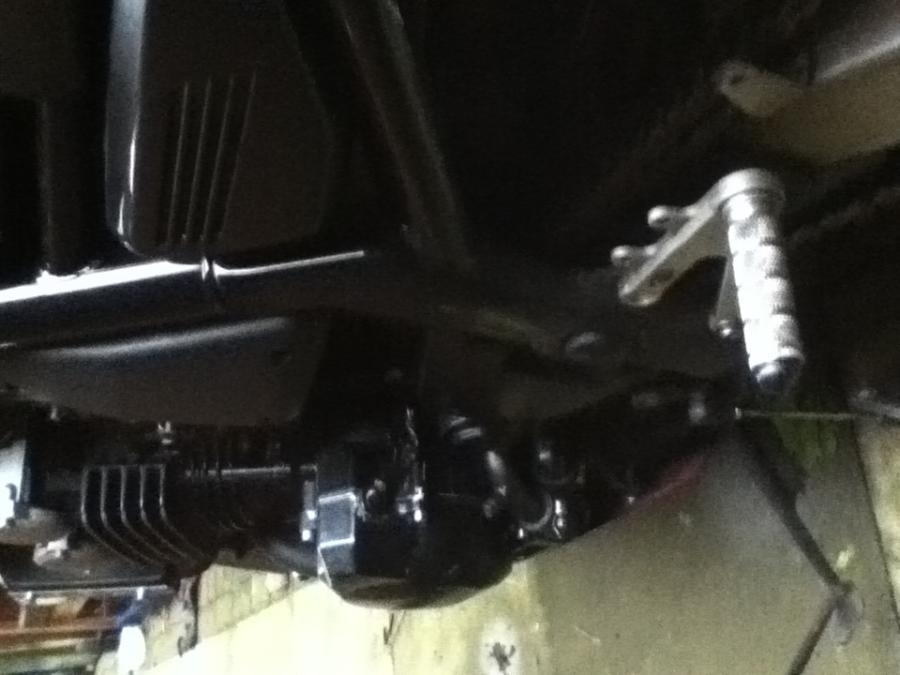

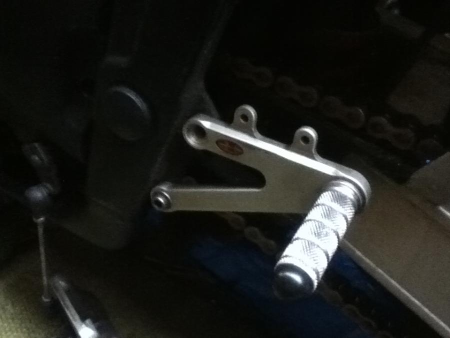

I made my own the 30x5 MS strip came from B&Q
They raise the footrests up 20mm and back10mm
https://dl.dropbox.com/u/70564722/img022.jpg
https://dl.dropbox.com/u/70564722/rearsets1.jpg
I used 8mm x 20mm cap head bolts to hold the footrests with a std washer between the Brk and the footest to give enough clearance for the head of Fazer bolts holding the Brk to the bike.
Edit :- In the photo I hadn't made the gearlink extension just moved the lever around the splines.
Heres a link to an earlier post :- http://foc-u.co.uk/index.php?topic=3007.msg24310#msg24310
ATB YFM

Well, thanks to YFM's very helpful drawing, I've successfully made and fitted the riser plates and they feel great, although I still might get rearsets in the future when funds allow for an even racier position.
I was going to post pictures of them but my footrest hangers look horrible!  :lol

Re: Rear sets - Ben600 - 18-07-12
just to add to this thread, I am in the process of adapting my SES rearsets from one of my Ducati's to fit the FZS. the bolt holes are only 2mm out, so a tiny amount of filing is needed Smile  they may be an option for you too?
I will let you know, with pics... Smile it hasn't been too hard making them fit.
I just now need to dig out my shift lever, as I much prefer 'race pattern' gear shift Smile
FYI: these are what I am using, however it is possible that the ones designed for other yamahas may fit easier still? http://www.sesraceproducts.com/ducati-583-fixed-rear-set-rsd006-x-215-p.asp
Re: Rear sets - YamFazMan - 20-07-12
Hi
With the Ducati rearsets fitted have you pushed the bike off the centerstand.
I seem to recall the lever that you put your foot on when operating the centerstand with my mod fitted came quite close to the footrest
and the Ducati ones look a lot further back and may clash with the centerstand foot lever.
ATB YFM
Re: Rear sets - andy352299 - 20-07-12
simular for me
the centre stand foot operating bit is very close to the gear change linkage.
