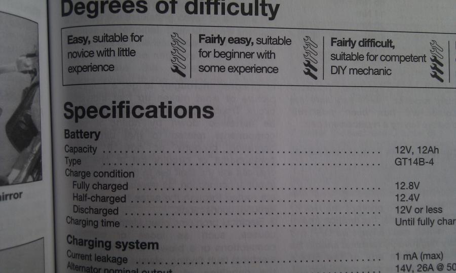

What battery do I need for a 2002 Fazer 1000?? Looking online some shopes are selling CT12B-4 and some are selling CT14B-4, both claiming to be correct. The battery I've just removed from my bike because it died unexpectedly was a CT12B-4.
Re: What battery? - know your limitations - 18-05-12
Both Haynes and Owner's Manual say GT14B-4, 12V, 12Ah
Don't know what the difference, if any, would be between "GT and "CT"  :\
Photo is from Haynes
Hope this helps

(18-05-12, 05:12 PM)know your limitations link Wrote: Both Haynes and Owner's Manual say GT14B-4, 12V, 12Ah
Hope this helps
The 'CT' & 'GT' are manufacturer specific codes nothing to worry about really. Ive just ordered a YUASA battery yesterday which would be O.E.M and that is a YT14B-4.
Im at home now & dont have my battery book to hand but I would say the '12' one would be too small at a guess (possibly physically & electricaly).
