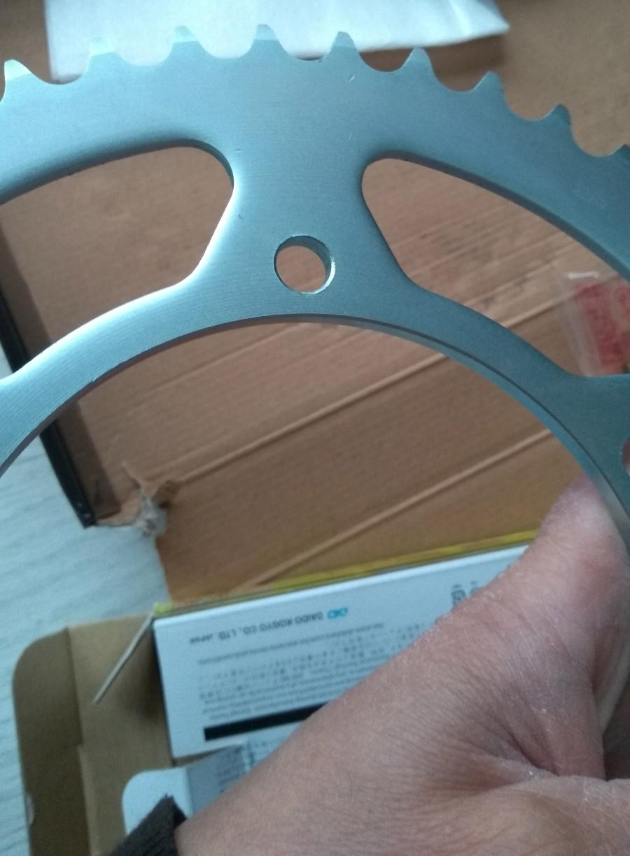

Re: New Chain Time = Sprockets too ? - fazersharp - 06-05-19

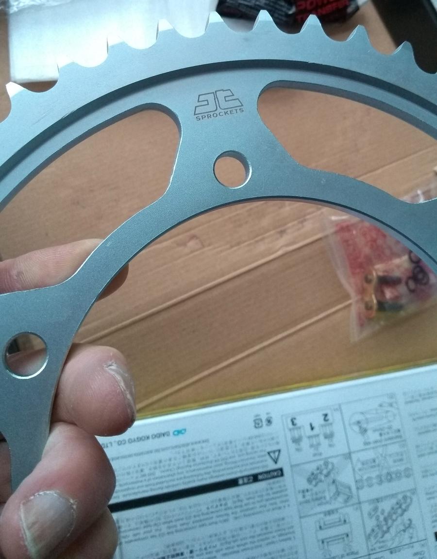

The rear sprocket is handed but 95% sure that the milled face faces out and the smooth face faces in to the wheel but just wanted to double check.Photos here
Re: New Chain Time = Sprockets too ? - bandit - 06-05-19
(06-05-19, 08:09 PM)fazersharp link Wrote: The rear sprocket is handed but 95% sure that the milled face faces out and the smooth face faces in to the wheel but just wanted to double check.Photos here
I think it's top pick with JT stamped on it faces out.
Re: New Chain Time = Sprockets too ? - robbo - 07-05-19
+1 Deffo
Re: New Chain Time = Sprockets too ? - fazersharp - 07-05-19
Yes it does look like the OEM one when looked at that way round.

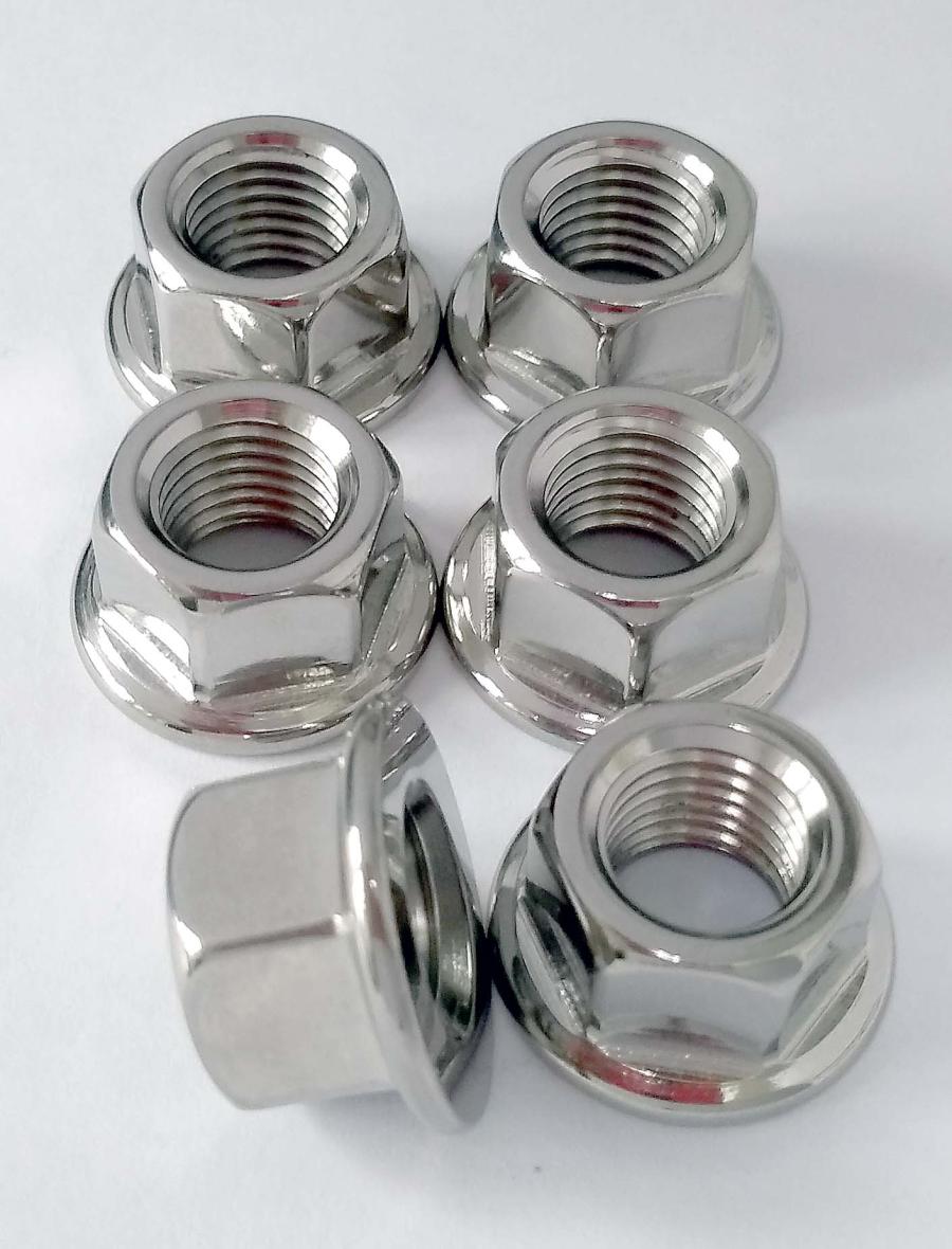

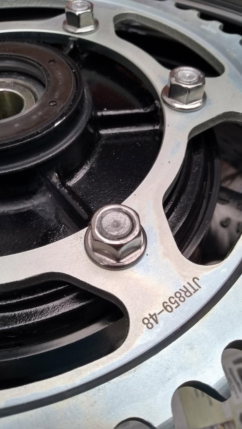

New sprocket and stainless nuts on. I couldn't help myself but to paint the ends of the sprocket studs.
