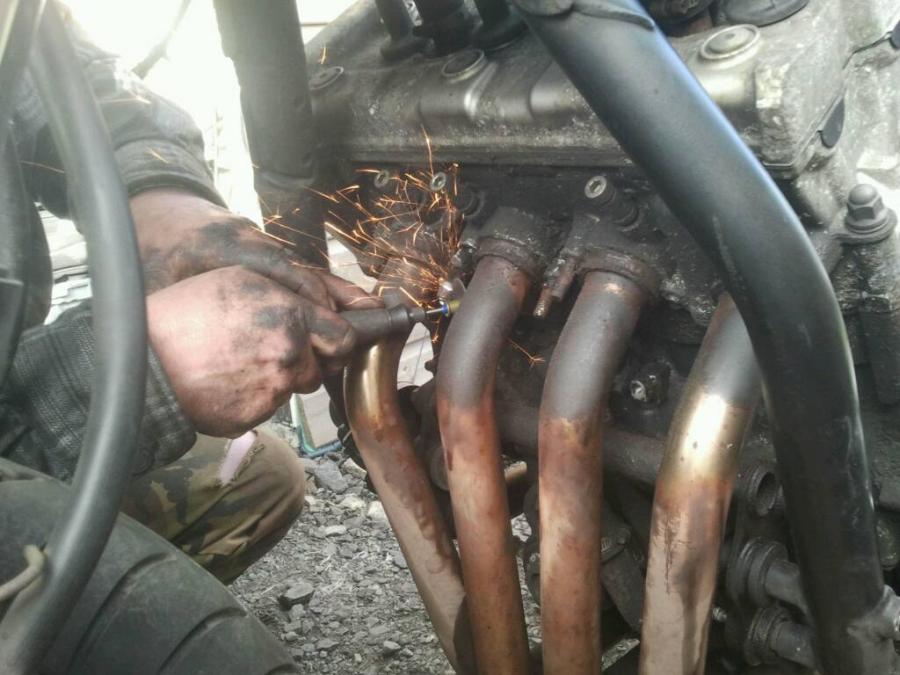

we've been having fun today, got all the nuts off though..
Re: Exhaust Studs - Dead Eye - 27-02-13
Looks like you are having as much fun as I did when this all began... Thankfully that sort of drama wasn't required, the buggers just fell off so damn easily - the metal studs had obviously warped and the material had become useless
Re: Exhaust Studs - Tilts - 27-02-13
studs seem ok, we just used the dremell to cut groves into manky nuts, plenty of gt85, old screwdriver and copper hammer, and tapped them loose, took all afternoon, but all nuts off, now we need to try and get the headers out of the head without damaging the head...  going to take mine off and replace.with decent stainless nuts, before they start to corrode.
