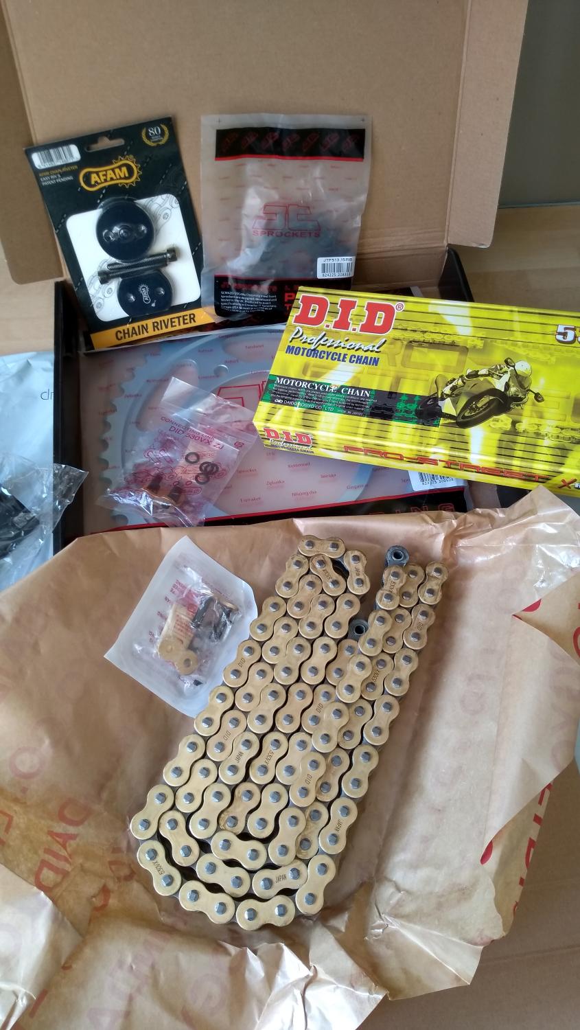

Here it is. less than 24 hours after ordering. Good service so far from Bike Torque Racing. In place of the tin of gunge lube I asked for an extra link so if I get it wrong I have another chance.

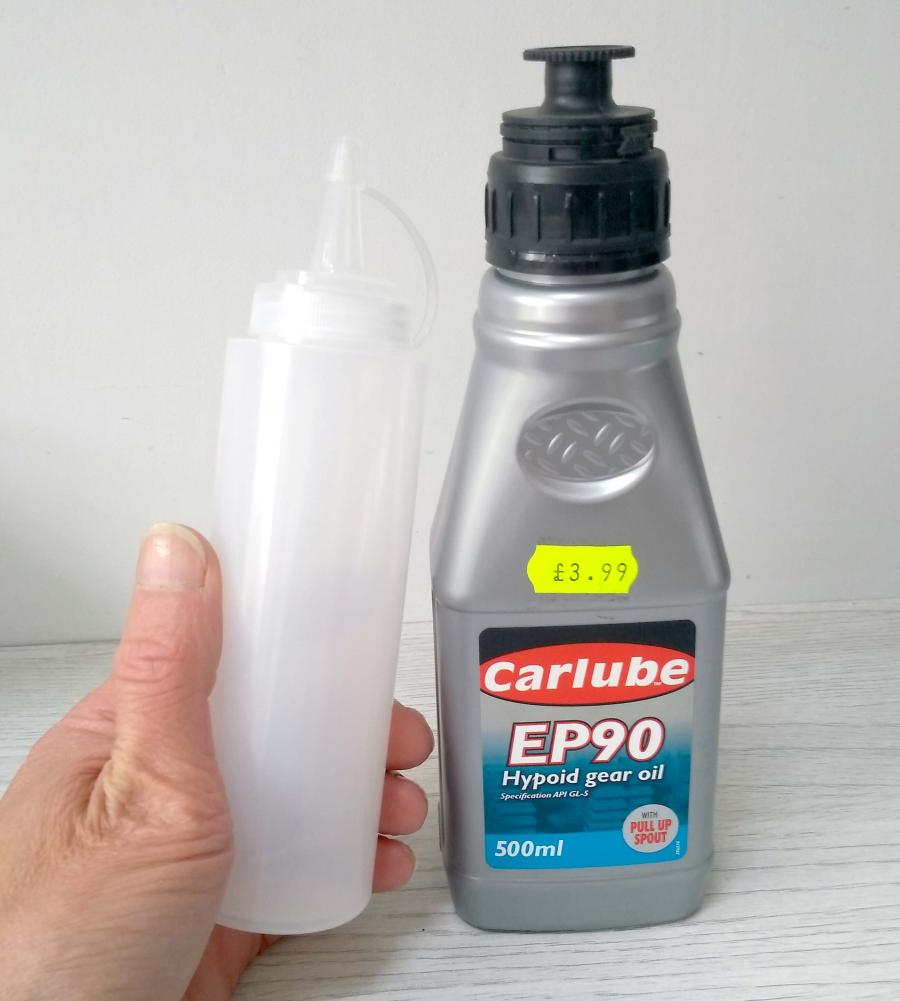

Got this lube from a local motor factors thought the smaller bottle will still last me years. Also got a small squeeze source bottle to apply to the chain. £1.09p
The oil says EP90 and GL-5 - so is that thicker than 80-90 Gl-4
My thumb is double jointed by the way  Big Grin
Re: New Chain Time = Sprockets too ? - Dynspud - 01-05-19
Good explanation of the different grades here:-
https://en.m.wikipedia.org/wiki/Gear_oil
Scroll down a bit to the API section.
Re: New Chain Time = Sprockets too ? - fazersharp - 01-05-19
Useful / interesting.
"GL-5 has a lower coefficient of friction due to the higher concentration of EP additives over GL-4, and thus synchros can not engage as effectively."
The the higher concentration of EP additives is not going to harm my o (x) rings is it ?

(01-05-19, 09:44 PM)unfazed link Wrote: If you do go the DID chain route buy from a reputable source as there are fakes cropping up and are difficult to tell apart until they break of are worn out in 2000 mile.
Its in my post a couple of posts back #103 with a picture
