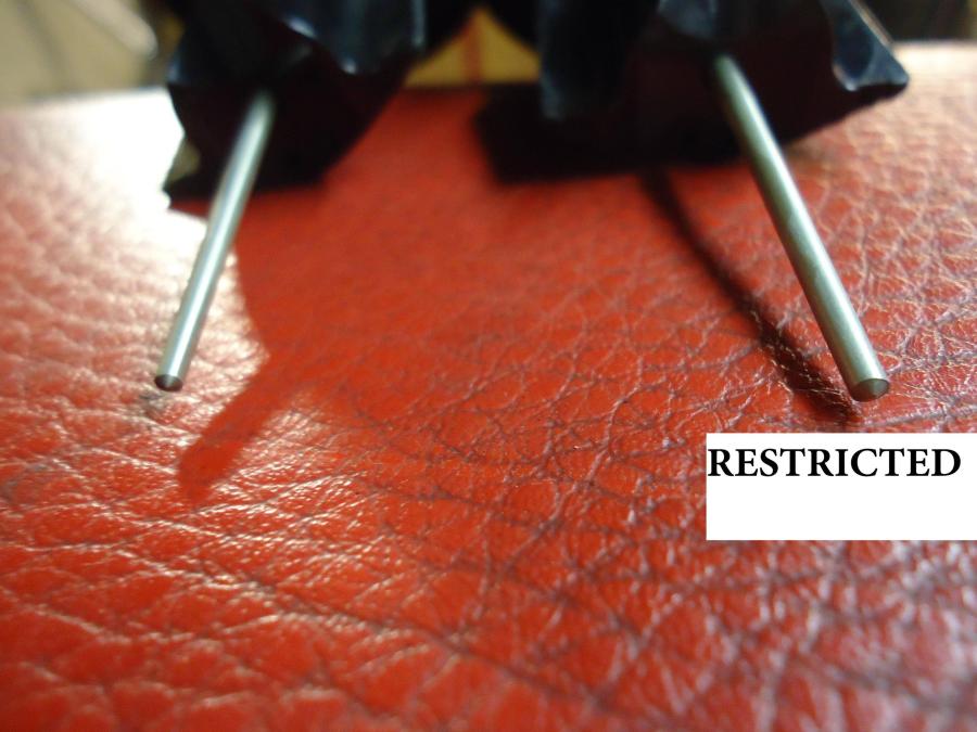

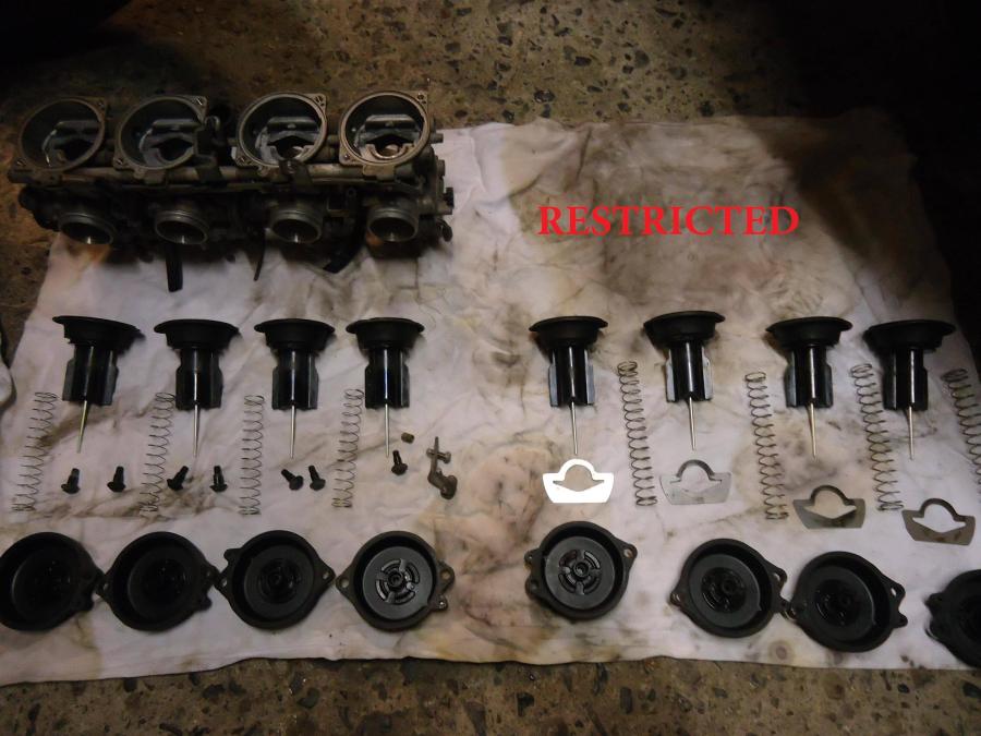

Re: Restricted??? - unfazed - 05-03-15 Remove the Air filter, hold the throttle open full, using a mirror and small torch/light look in to see if there are restrictors in the inlets. If there are no washers in the inlets remove the tops of the carbs to see if a yamaha restrictor kit is/was fitted. See pic Re: Restricted??? - Punkstig - 05-03-15 Riding around below 6k rpm, what's that all about? Re: Restricted??? - Silverlegacy - 05-03-15 Bike been dynod so definitely not restricted. Nice I get the bike up to 6k it started to feel strained and a bit vibey. So tried to keep it below and just shift up as I hit 6k . Not ideal but bike runs really smooth that way, just not overly nippy. After reading stories of people getting there's jetted and either being worse or doing nothing I don't think I want to spend £300 getting it sorted. So just trying to see what else I can do, wanted a new exhaust but heard it could lean the bike out even more which might be bad news. Might try adjusting carb needles one notch and see if it makes any difference? Re: Restricted??? - unfazed - 05-03-15 Check the charging, a slightly over charging regulator can cause similar symptoms Re: Restricted??? - Silverlegacy - 05-03-15 (05-03-15, 10:47 PM)unfazed link Wrote: Check the charging, a slightly over charging regulator can cause similar symptoms Not sure how to check this as not overly technical? Although I have read through a old thread and that was the problem, so might very well be? I'm pretty sure I read somewhere about engine charging the battery at certain revs? Although I don't know the technical details sorry. Bit of a tech noob on here, so appreciate everyone's knowledge and patience. Re: Restricted??? - Punkstig - 06-03-15 (05-03-15, 10:32 PM)Silverlegacy link Wrote: Nice I get the bike up to 6k it started to feel strained and a bit vibey. So tried to keep it below and just shift up as I hit 6k . Not ideal but bike runs really smooth that way, just not overly nippy. The power comes in after 6k, riding it below that and it'll never be overly nippy no matter how much you spend on Carb setups, air filters and exhausts! Re: Restricted??? - rhinoeli - 06-03-15 I would certainly suspect something in the carbs: - leaky diaphragms - one or more jets blocked - float level too low Sooner or later you'll have to take the carbs out, check them, clean them... Other thoughts: - fuel filter blocked? - fuel pump? - TPS? Re: Restricted??? - Silverlegacy - 06-03-15 If I can work out that issue between 6-7 k then hopefully it will give me an incentive to ride it more for fun rather than just commute, it's one of the only bikes I've owned I've not used of a weekend for rides out. Might look further into this regulator thing? I did notice something with the lights and lights on the clocks getting slightly dimmer when it was still dark around 7am, probably more so the lights on the clocks, although it has got an extra temp gauge and a analogue clock fitted to it drawing power? although doubt these are high usage items? Re: Restricted??? - Silverlegacy - 06-03-15 (06-03-15, 09:01 AM)rhinoeli link Wrote: I would certainly suspect something in the carbs: Ive tried to check as much as i can, carb rubbers not leaking, although not cleaning carbs yet as might be a bit beyond me to be honest. I fad fuel filter off, blew it out and cleaned it and its ok, not sure about fuel pump but seems ok? Ive adjusted TPS when i did my carb sync and its fine. Starting to wonder now after reading through Red98's Stutter thread as to whether it might have anything to do with the regulator? although symptoms seems similar, ive probably not done a very good job of putting them into words. Re: Restricted??? - rhinoeli - 06-03-15 (06-03-15, 11:45 AM)Silverlegacy link Wrote: carb rubbers not leaking, although not cleaning carbs yet as might be a bit beyond me to be honest. I am talking about the diaphragms inside the carbs, not the inlet rubbers. |
