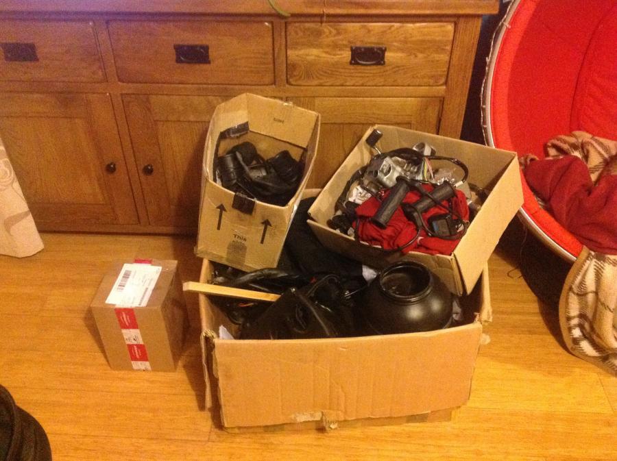

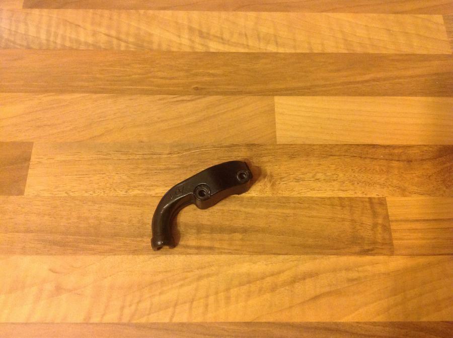

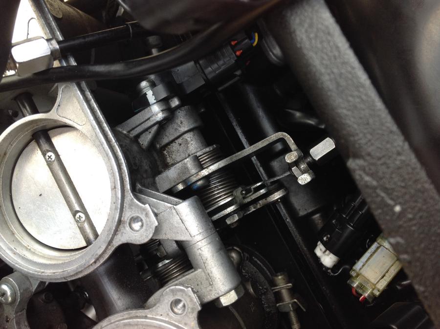

Re: Sprucing up the old FZ1 - noggythenog - 27-02-15 YES!!!!! Ya foccin dancer! Woop woop! From this pile o 600 gumpf...eventually comes the half of the housing that i need......where was it.....hidden inside the bloody airbox :rolleyes . Just gotta hope that it is the same piece which it looks to be and redeem my earlier stupidity. Re: Sprucing up the old FZ1 - slimwilly - 28-02-15 You may already have this but here it is anyway http://www.manualslib.com/manual/611157/Yamaha-Fz1-S.html#manual Complete FZ1s gen 2 Manual Re: Sprucing up the old FZ1 - noggythenog - 28-02-15 (28-02-15, 09:52 AM)slimwilly link Wrote: You may already have this but here it is anyway Cheers Slim :thumbup Re: Sprucing up the old FZ1 - noggythenog - 28-02-15 Not much progress today Thought my 600 throttle housing was the same but it wasnt so had to venture on ebay...16 foccin quid for my troubles.....that's what i get for not owning torque wrenches. Sorted out getting rid of the extra messy wiring from the front end from gps and grips etc, cut off the cable tidy bracket on the left side for extra cable clearance on full lock and then started looking at the front tank bolts (sides).......particularly annoying spinny bracket thingies and i can line up 1 side but then the other side is too far out to sit on its bracket so it slides down...most annoying.....i settled with a folded up cloth between the tank and airbox to act as a spacer but although it works perfectly well it looks a tad bodgy so ill maybe get some official looking black sponge glued on or something. It was foccing cold and windy and then it started raining so i abandoned everything and went to the shops for some Bevvy instead ![]() Re: Sprucing up the old FZ1 - nick crisp - 28-02-15 Do you really need a torque wrench for a couple of throttle housing bolts? Do you have pigs tits for fingers? :lol Re: Sprucing up the old FZ1 - noggythenog - 28-02-15 (28-02-15, 07:12 PM)nick crisp link Wrote: Do you really need a torque wrench for a couple of throttle housing bolts? Do you have pigs tits for fingers? :lol It would appear that i do :\ ....didnt want it being too loose Maybe it was just brittle...brittle bike syndrome :\ Re: Sprucing up the old FZ1 - slimwilly - 28-02-15 I won't suck on any pigs tits anymore :o Makes me feel sick :lol Re: Sprucing up the old FZ1 - noggythenog - 20-03-15 Some new goodies have arrived in noggy HQ All the gear, no idea springs to mind :lol Re: Sprucing up the old FZ1 - brooker81 - 21-03-15 Oooohhh. Nice Re: Sprucing up the old FZ1 - Falcon 269 - 21-03-15 Beware the torque wrench. Seriously, it'll give you a false sense of security if you don't have any feel for what is right and what is too tight. Too tight as in 'oh, shit, it's stripped the thread'. Small fasteners require a light touch. Never use more than a light grip and tighten with fingers, maybe some wrist but never elbow or arm. If you're using a spanner or wrench, hold it close to the working parts, not out at the end where torque effort is magnified. It's all about feel and mechanical empathy, Grasshopper. ![]() Re: Sprucing up the old FZ1 - noggythenog - 21-03-15 (21-03-15, 08:53 AM)Falcon 269 link Wrote: Beware the torque wrench. Seriously, it'll give you a false sense of security if you don't have any feel for what is right and what is too tight. Too tight as in 'oh, shit, it's stripped the thread'. It runs in the family to be too harsh with tightening, my old man was a fitter/turner back in the day and was used to more larger stuff, his yam mechanic mate told him he'd be cheaper long term coming to him rather than breaking everything he touches :lol ......seems im the same.....i just have a fear of stuff coming undone at speed so ive now got a small range wrench and a high range for the bigger jobs. Stunning day today i hope to get some stuff done on the bike fingers crossed. Cheers for the tips mr Falcon, may seem obvious to some but thats the kind of help i need since im an office jockey by trade. 8) Re: Sprucing up the old FZ1 - noggythenog - 21-03-15 Bit of a foc around today. Took me ages just to figure out how to get my snapped throttle cable off......the bottom cable is so awkward at the throttle body side...i had to do it from the right hand side but the gubbings for it was the opposite side an basically shrouded by stuff, no room to move or see....eventually poked it out but ill need some divine powers to get the new one back on again....the cable was frayed in roughly the same place that the other one snapped...not quite sure if that is age and wear & tear or if it has been stretched. I then attacked these connectors with contact cleaner & dielectric grease. Took my rear fender off and was gonna replace it with my carbon one but then i noticed that the small brake cable hose and another one could do with a lick of paint so ill do that first. Basically wasted allot o time with that bloody throttle cable though. Re: Sprucing up the old FZ1 - noggythenog - 21-03-15 Gratuitous pic :b Also can anyone confirm that even if i have to buy a special gadget that i can still oil my throttle cable perfectly easily when it is all connected up???....i just cant be arsed pissing about wasting time trying to figure out oiling it now on the cheap so if i can manage to fit the cable to orrow by some miracle then ill splash out for an oiling tool another time. Re: Sprucing up the old FZ1 - noggythenog - 22-03-15 I have had the biggest ballache going today. Spent a long time just trying to feed the new throttle cables through the space behind the radiator, blind as usual of course. Then it was time to get the cables onto the throttle body pulley. A whole day later, sore fingers, a walk on the beach with the dog to stop me pouring petrol over the bike & sparking it up & i think i've got somewhere. Im not sure though, i cant quite believe that it is done but i wanted to come inside for the night with positive feelings. The top cable was ok to do....ish....still lots of bending the cable end round on itself to slip into the nick before going into the hole, still finger achingly fiddly. The bottom one is a device straight from satans arse hole. 100 times i must have tried it, honestly my finger tips are stinging just typing on my ipad. Say one thing about me say im bloody stubborn & i honestly dont know how i managed it in the end (thats why i cant quite believe i have done it). The pics show how tight it is, you cant really move your hand due to the frame crossmember above it. You extend the wire as much as poss & then basically fumble in the dark like some kind of evil fairground prize game. The end went in the hole loads of times but wasnt inside the nick which incidentally you couldnt actually see either so as soon as you moved it would jump out of the hole again. The space also isnt big enough to get a finger down inside so you cant really just push it in from behind. Evil evil evil evil evil Next to do is connect up throttle grip side & then learn how to adjust the cables, only then will i believe. Re: Sprucing up the old FZ1 - noggythenog - 22-03-15 Done..........i hope :\ Re: Sprucing up the old FZ1 - taylor - 22-03-15 nice one noggy well done, looks like a lot of head work. :eek Re: Sprucing up the old FZ1 - noggythenog - 23-03-15 Easier job today, fitted this petrol cap, a bit OTT but o well.......think ill get some black bolts for it to dumb it down a bit ![]() Re: Sprucing up the old FZ1 - nick crisp - 23-03-15 Noggy, can I make a small suggestion? Why not have your second thoughts before you buy stuff? Just an idea... :lol Re: Sprucing up the old FZ1 - noggythenog - 23-03-15 (23-03-15, 07:00 PM)nick crisp link Wrote: Noggy, can I make a small suggestion? Why not have your second thoughts before you buy stuff? Nick this isnt actually a petrol cap...its a teaching aid.......it has tought me that i need a black one with a silver inner and gold bolts :lol .......this one will get relegated to the bits for future bikes or the noggy shop :rolleyes Re: Sprucing up the old FZ1 - nick crisp - 23-03-15 It's a steep ol' learning curve ain't it :rolleyes Safer to just not buy anything and be a cheapskate like me :lol |
