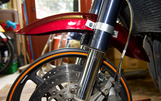

Day 48 - 27-7-14 - Had a go at making some brackets to mount the front mudguard (from a Kawasaki ZRX1200) to the fork tubes. Seemed to work OK however I am doubtful that they would stay
in place once on the move and I'd worry about the mudguard dropping onto the tyre. As I need to protect the fork tubes from damage I need to make some protectors for them anyway, so I think I'll combine the
two into one item. The protector parts will follow the same design as the mudguard a sort of boxy shape with rounded edges so the whole thing works together.

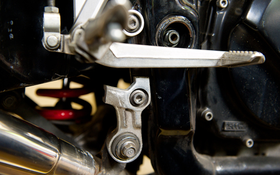

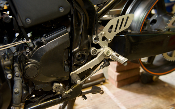

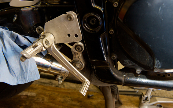

I've temporarily fitted the GSXR-1000 K6 footrests using the existing mounting points on the frame, with the lower hole of the footrests in the top hole of the frame mount. The top hole is held in place with
cable ties and is just for a shakedown run of the new front and rear ends. This makes the footrests about 20mm higher than standard and also moves them forward slightly, which will be kinder to my knees!
You may remember I came to this solution as the other positions I tried hit the swing arm.
[Image: RubyRacer-102-s.jpg]
[Image: RubyRacer-103-s.jpg]

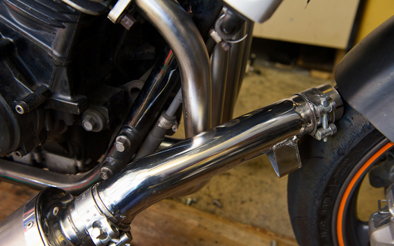

I cut the exhaust mounting bracket from the OE footrest. Not quite sure how I'm going to solve that problem. I may file down this part to make it look nice, or fabricate something myself. Still mulling that
one over in my head.
[Image: RubyRacer-104-s.jpg]

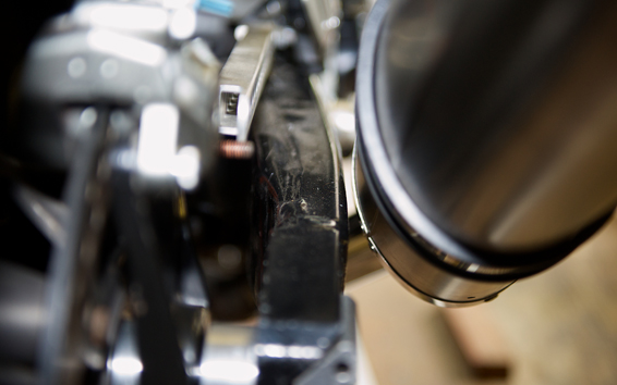

The clearance between the silencer and the swing arm is a little close, so not too sure if that is OK or not.
[Image: RubyRacer-105-s.jpg]

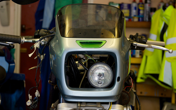

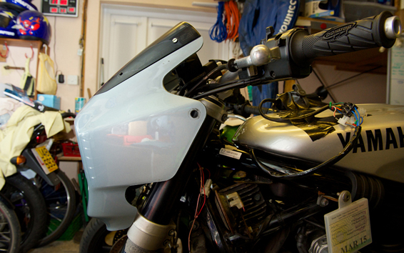

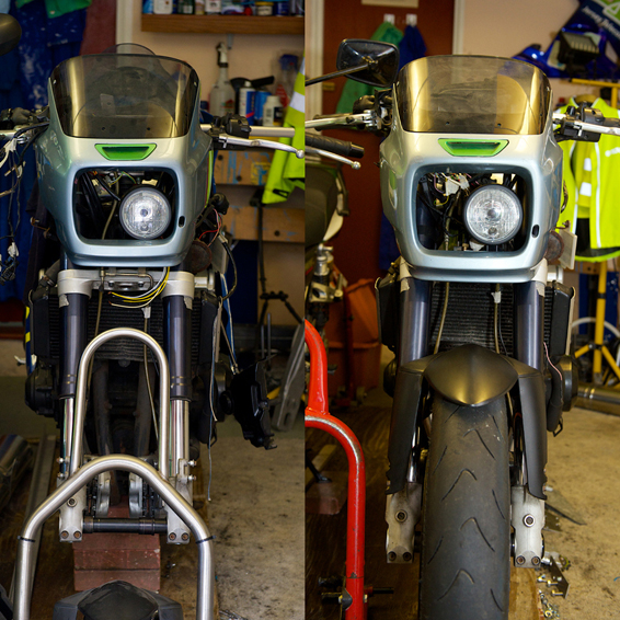

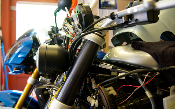

Day 49 - 7-8-14 - Made a bracket to mount the headlight. It's the smallest conventional bulbed light I could find and is only 90mm in diameter. Unfortunately it's a little deeper than I would like.
[Image: RubyRacer-107-s.jpg]
I had hoped to fit one light that would work with either the ZRX fairing or the number board.  It's fine with the ZRX fairing as you can see, unfortunately it would make the number board sit too far away
from the forks to look right. So I may have to look again at a light from a B Whiz scooter.
[Image: RubyRacer-108-s.jpg]

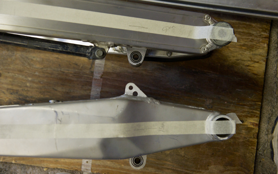

Day 50 - 9-8-14 - Finally got the rear wheel spacers sorted and everything is in line. So time to get the tyres back on and the bike rolling again. Took her outside to have a look at things.
Unfortunately the back end sits very low. Took a couple of minutes to realise I needed to change the length of the dog bone links on the shock absorber. But why?
[Image: RubyRacer-109-s.jpg]
I was sure the swing arm was the same dimensions as the OE one. I still had the OE and knackered EXUP swing arm so I compared them closely. I could see that the EXUP linkage mounting holes were
lower than the OE ones and when I did a rough measure it was lower by about 23mm.
[Image: RubyRacer-110-s.jpg]
The bolt hole centres of the standard dog bones are 140mm apart, so I knew I needed to make some shorter ones. I can't remember where I got the figure from, but I went for 115mm between linkage
bolt hole centres. This raised the rear although when on the centre stand the rear wheel sat on the ground. So I thought this was too low.
[Image: RubyRacer-111-s.jpg]
Tried again with a distance between linkage bolt hole centres of 130mm. This looked too low again. However with the new forks the front end may be riding a little higher than standard.
[Image: RubyRacer-112-s.jpg]
Day 51 - 17-8-14 - It was obviously somewhere between 115mm and 130mm. I tried to work it out mathematically using measurements between the three holes for the linkage and came up
with a figure of 127.5mm. I decided to round that down to 125mm. The rear tyre only just touches the floor, so I'm getting closer. I'll try 120mm next. I should have taken a measurement of the seat height
before ripping the standard bike apart. Too late now. Looking on line and the Fazers seat height is quoted as 790mm, so I'll see how close I can get to that.
As I was using the standard dog bone when fitting the rear sets the swing arm was too high and hitting the rear sets easily. Now that I am close to getting the swing arm at the right height it will hopefully
mean I have a bit more room to play with with the foot rests and so I might be able to revisit my plan for adjustable rear sets.
Pic below is with the 120mm dog bone.

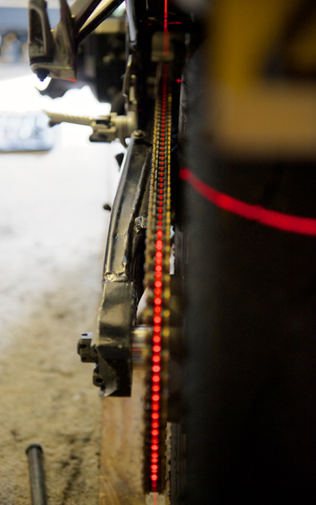

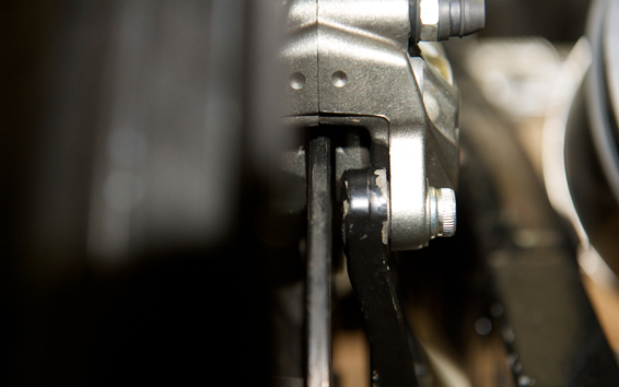

Whilst I still had my mates laser (thanks Shaun, will return it soon!) I double checked the chain run. All seems good there.
[Image: RubyRacer-115-s.jpg]

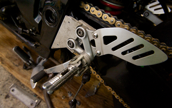

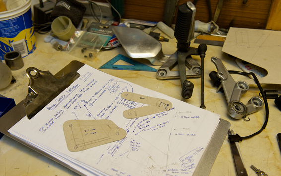

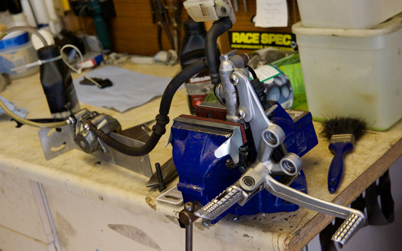

Had another look at making adapter plates for my Suzuki rear sets. After much head scratching came up with a design. So will have a go at making them.
Day 54 - 22-10-14 - This was my idea for a different mounting bracket for the rear sets. I was trying to hide the mounting point on the frame to make it look like part of the frame. The bolts attach from
the back side of the frame, screw into the frame and then into the bracket. This is not an ideal solution as the head of the bolt doesn't pull the bracket towards the frame. Rather that job is being done by the thread.
Anyway even though it's just a very rough mock up I didn't like the look of it. Next!
[Image: RubyRacer-117-s.jpg]
Day 55 - 2-11-14 - Another idea came to me. Make my own brackets and attach the Suzuki foot pegs and levers to them. So I designed this.
[Image: RubyRacer-118-s.jpg]
[Image: RubyRacer-119-s.jpg]
I've also dismissed that idea as I don't have a milling machine (thinking about getting one though!) and I doubt I could get the kind of perfect finish I like. I thought back to my original brief to have the bike suitable
for racing. Ground clearance is important so the ability to change the position of the foot pegs for road or track appeals. As the OE Suzuki foot rests are almost in the right position I thought some aftermarket rear
sets would do the job.
I used to race a 2005 Suzuki GSX-R1000 and that was fitted with ProMach rear sets. They were very strong and I liked the design, so I set about trying to find some on that well known internet based auction site.
Not much on there, however I found a full set in very good condition and the furthest forward position was right where I needed the foot rest to be, with option of moving them up and back. Perfect. Not so perfect
was the price. Suffice to say I paid a bit over the odds. Preferable to relying on some unknown quality, cheap versions from China though. Plus after checking with ProMach direct I can still get spares.

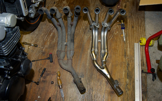

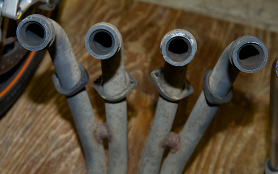

I decided at the outset to do this build in stages to try and avoid getting too far in and finding things wouldn't work how I wanted. Stage one was to get the front and rear ends fitted. I've done that now, so stage two
is to fit Venom (by Motad) header pipes, new silencer and individual pod filters on the carbs and get it running properly, or certainly in the ball park before proper setting up on a dyno. Stage three is when the angle
grinder comes out and the transformation proper starts.

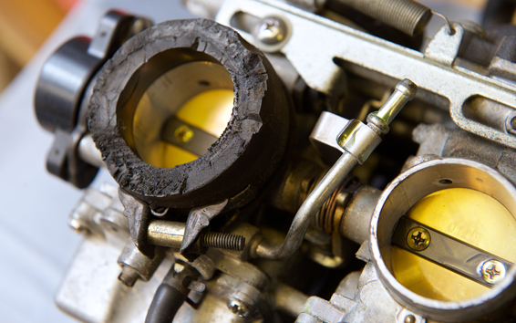

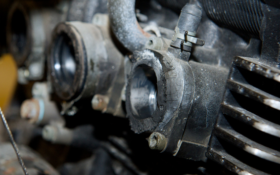

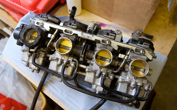

So the carbs had to come out so I could fit different jetting and to check what size jets to order. There's always one nut, bolt or screw that causes an issue isn't there? It was the last of the Jubilee type clips on the
carb rubbers (engine side) to throw a spanner in the works. The screw holding the rubber tight to the carb would not budge and in the end I rounded off the screw head trying. Doh! All these intake rubbers were
perished so I was going to replace them anyway and had already picked up some second hand ones. Nothing for it but to resort to brute force and ignorance. Where's my hack saw? I just cut through the rubber
and after much jiggling got the carbs free.

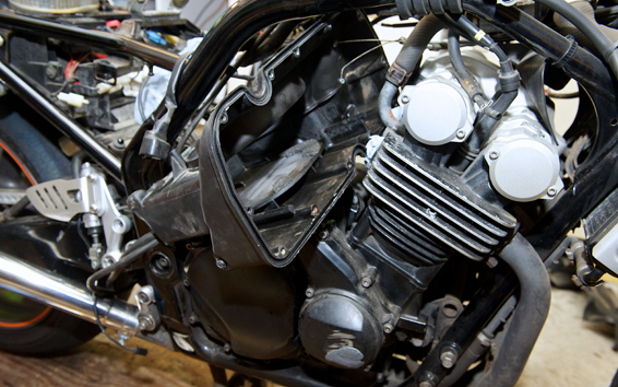

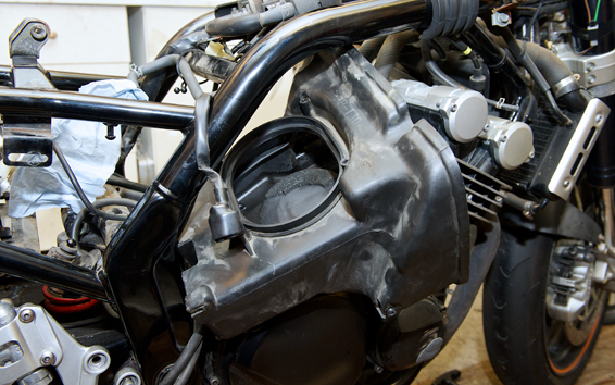

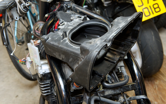

Now to remove the airbox. Pretty sure I've read on the Fazer forum that you have to remove the engine to get the air box out. The engine will be out at some point, but not yet thanks very much. It did indeed look
like a non starter. However I noticed the front of the air box could be removed. So I did that and pulled the air box forward. My that is tight. Tried various angles of air box, but it looked like it was staying put. One last
try. I pushed the air box upwards and forward as much as possible and was able to get the rear right side to go in front of the frame rail. It was very tight and would probably scratch the frame
(it'll be powder coated eventually), but I managed to yank it out. So it can be done. Result.

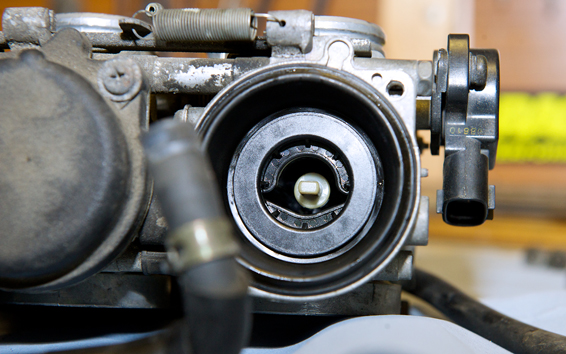

Tried to get at the slide needle as I'll need to change the height of it, however I wasn't sure how to remove this white plastic bit that sits at the top of the needle. Anybody any ideas please? I didn't want to get
tough on it in case I broke it.

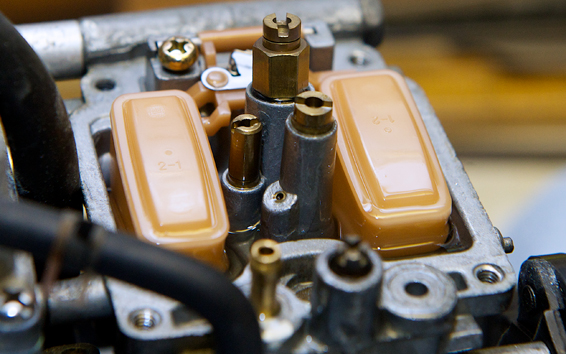

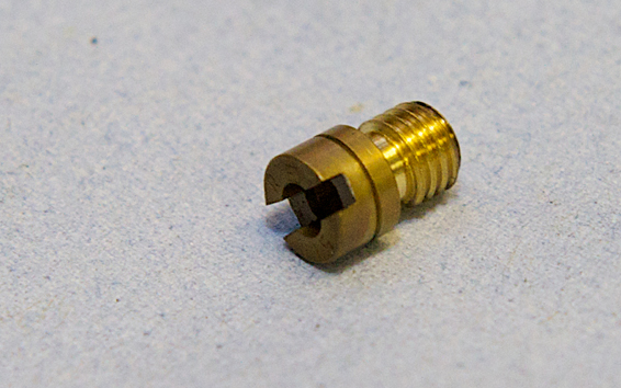

The main jets are Mikuni number N102221 size, with 115 size fitted in all the carbs. I haven't got any experience with carbs, but I managed to get some information on new jetting from someone on the Fazer
forum who had got pod filters fitted. He had taken his bike to a dyno for set up and they fitted 125 mains in the outer carbs and 127.5 in the middle carbs, with all four needles moved to fourth groove down.
[Image: RubyRacer-128-s.jpg]
[Image: RubyRacer-129-s.jpg]

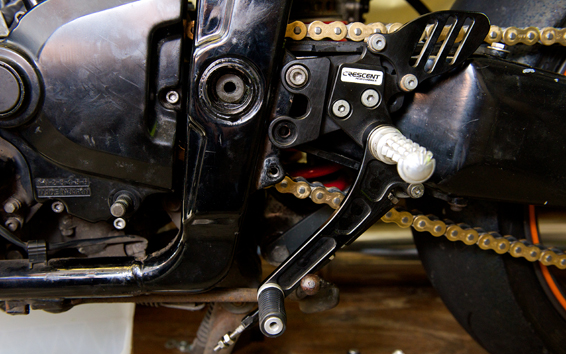

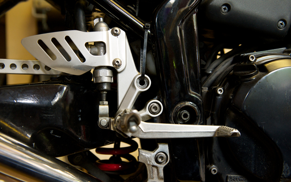

My ProMach rear sets arrived so I quickly mounted them. I didn't have time to check properly, but it looks like they are going to work. Happy with that.
[Image: RubyRacer-130-s.jpg]
The credit card got hammered today as I ordered parts to progress with the build. The exhaust is ordered from Motad. They are making another batch of 25 which should be done by 20 November 2014, so I
should get it the following week. Four pod filters with chrome covers (K&N part number RC-1824), the bigger mains jets, float bowl screws and  intake jubilee clip are on the way.

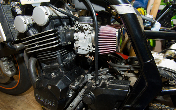

Day 58 - 19-11-14 - Worked on the carbs today and fitted the bigger main jets and moved the clip on the main needle down to the fourth (bottom) groove. Also had a good look at the new Pro Mach
rear sets I bought and they will do a perfect job. Took some time to get the gear shift linkage to the right length as I didn't want to go mad a make it too short.
Spent quite a bit of time just looking at the bike and working out where I'm going to package everything. It's going to be tight! Main things I'm working on are the ignition switch, steering damper, battery, relays,
fuses, starter solenoid and Igniter box (ECU).
Because I'm using the ignition mount holes to mount my clocks and there's no space left for the ignition barrel, I am thinking of relocating the ignition to the front of the top frame tubes just in front of the leading
edge of the fuel tank, or sunken into it. Going to be a bit of a clash as that's about the only place I can fit a steering damper (Ducati 916 stylee). However looking at the different mounts available it should be doable.
Just have to work out which other bike model I'll need.

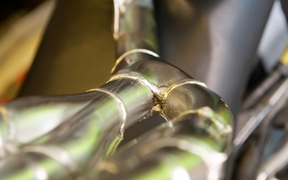

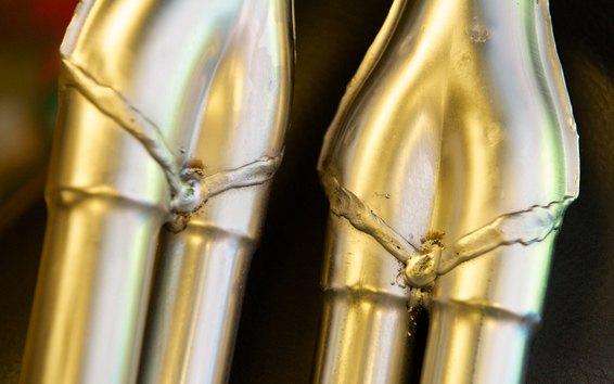

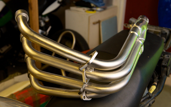

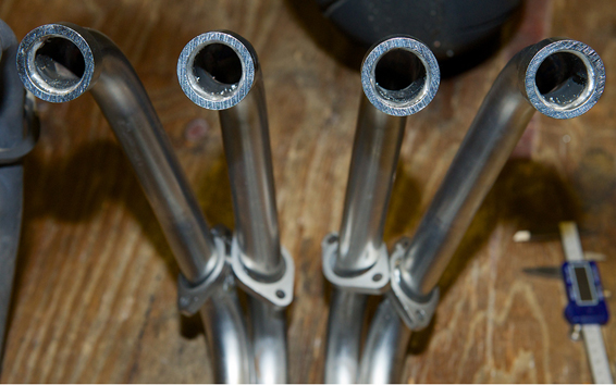

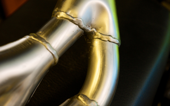

Day 59 - 22-11-14 - My new Venom system arrived from Motad. I have to say I'm not overly impressed with it. The stainless steel finish is nowhere near mirror like, more of a bare aluminium type finish.
Which on it's own is OK, but clashes with the mirror finish link pipe I have. If you get one of these systems I'd recommend getting the Venom can to go with it so it all looks the same. To be fair I'm pretty sure they
have been built down to a price to compare with the cheep stuff coming out of China so it's maybe harsh for me to have a pop at the quality, it's just that being made in England I expected better.
[Image: RubyRacer-133-s.jpg]
The welding is rough and there is quite a bit of splatter which wasn't removed before plating. To be fair it's mostly in areas you won't see, like inside the header pipes and under the engine. I may get it ceramic
coated once the build is finished. They also sent me the wrong size exhaust gaskets (too big), however once I had advised them of this they sent the correct size which arrived the next day.
[Image: RubyRacer-134-s.jpg]
[Image: RubyRacer-135-s.jpg]
[Image: RubyRacer-136-s.jpg]
[Image: RubyRacer-137-s.jpg]
Day 60 - 25-11-14 - Got the pod filters fitted and the carbs back on.
[Image: RubyRacer-138-s.jpg]
The Venom system has a slightly bigger internal diameter than the standard system, so hopefully that will let it breathe easier.
[Image: RubyRacer-139-s.jpg]

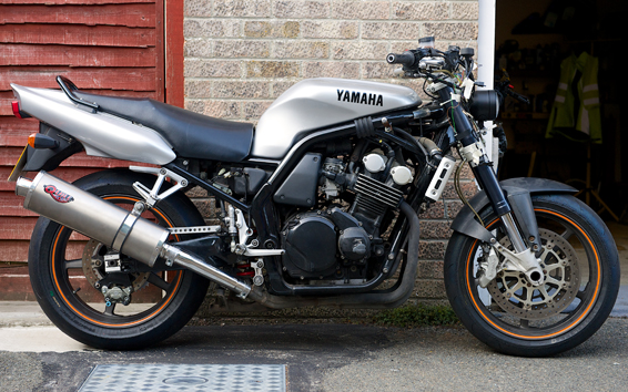

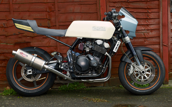

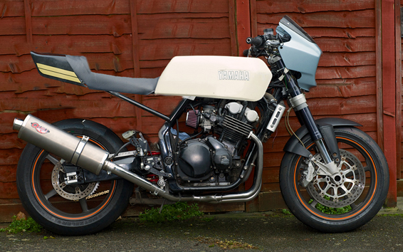

Did some photos of the bike so I could do another mock up of the tail, fuel tank and fairing set up I want to use, so I could see if I can achieve the look I'm after. Below is my original mock up and below that my
latest mock up.
[Image: RubyRacerMockUp-s.jpg]
[Image: RubyRacer-142-s.jpg]
It's looking like I'm on the right track. However I don't like where I have the fairing sited as I feel it's too high and the tail, fuel tank and fairing don't flow into each other nicely. So I hit Photoshop again and
moved the fairing down. That looks better.
[Image: RubyRacer-143-s.jpg]
Day 61 - 30-11-14 - I've relocated the fairing in the lower position for real and feel it looks better as it covers the bottom yoke now. However it may move up a little as I haven't finalised it's position yet,
but it will be very close to where it is now. Moving it down means I had to move the headlight down too. In photo below the picture on the left is original position of the fairing, on the right the latest location.
[Image: RubyRacer-144-s.jpg]
[Image: RubyRacer-146-s.jpg]

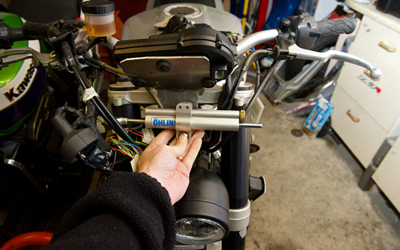

This has had a benefit in another area, namely the location of the steering damper. Previously I'd thought about mounting it in front of the fuel tank, although I really didn't want to put it there as I think they
should be hidden from view. I realised I could mount it in front of the headstock by welding a bracket to the upper area of the headstock and then mounting the other end to the top yoke using the bolt hole conveniently
located at the front of the yoke, or by using a fork clamp with a threaded hole for mounting of a steering damper.
[Image: RubyRacer-147-s.jpg]
With the headlight mounted lower I realised I can use the original fairing subframe mount holes on the headstock instead and making a bolt on bracket to fit. So that's probably the next job.
I managed to test ride the bike with the new exhaust and carb set up. It's definitely perkier off the throttle and the jetting doesn't seem to be too far out, certainly above 5,000rpm it flies. Below that there is just a
slight wooliness so I think one of the other jets needs changing. According to the instructions which came with the pod filters I need to change the primary main jet. It also states that when using CV carbs that you shouldn't
change the needle height from standard. So when I fit the new primary main jets I'll put the needle clips back to their original position on the third groove down.
