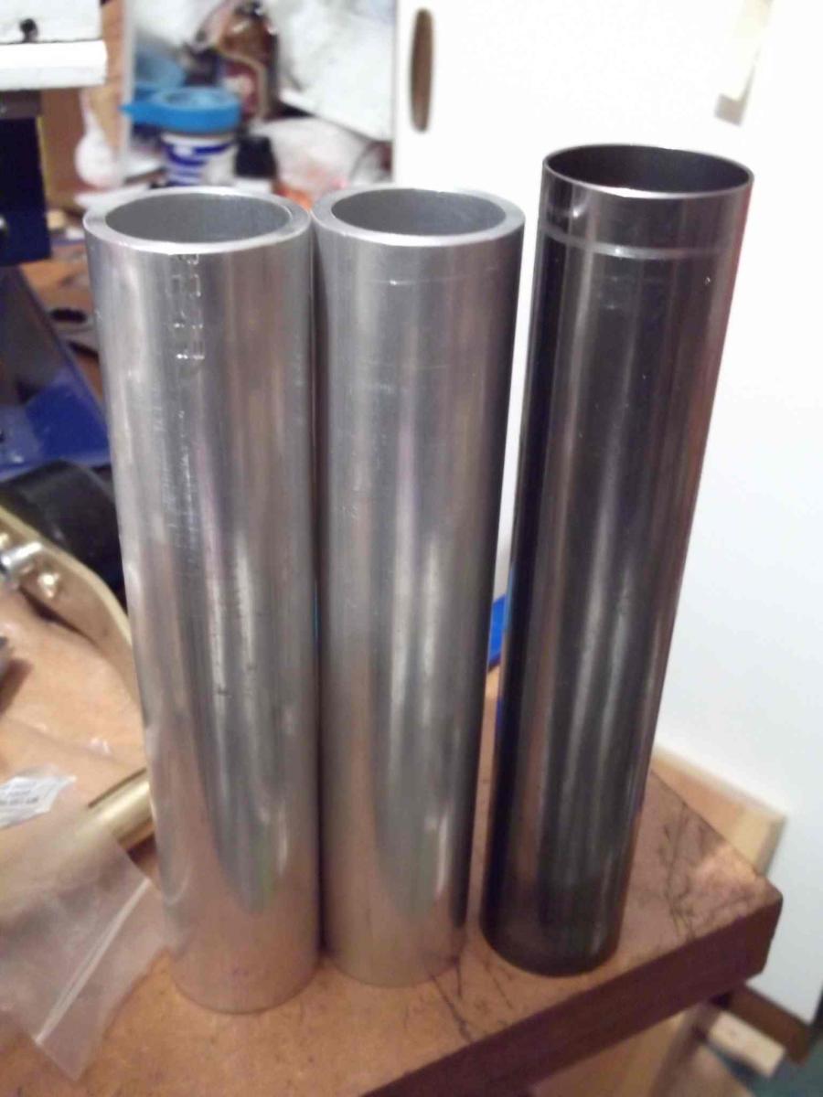

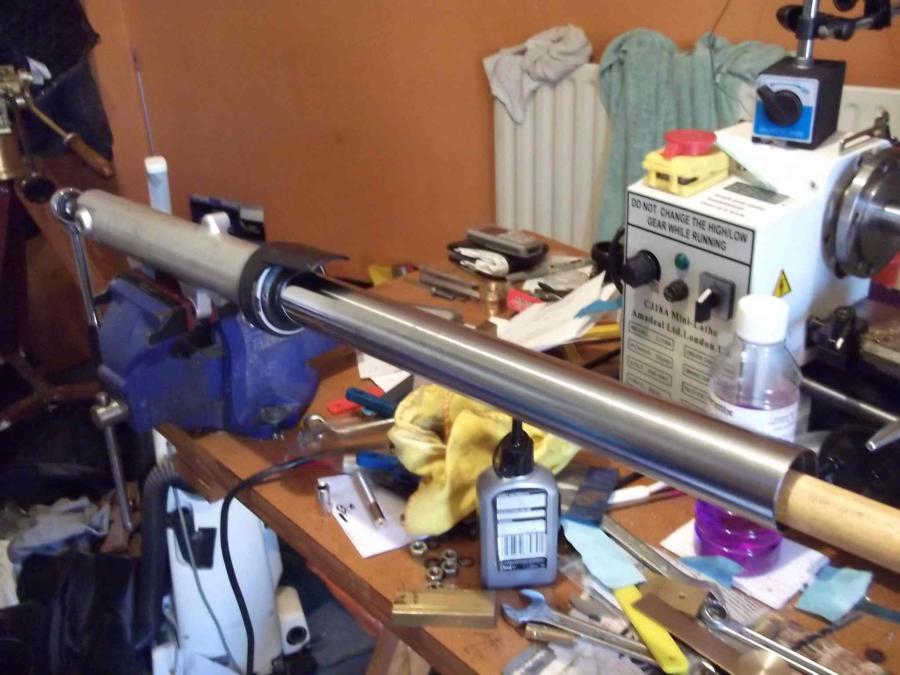

Re: Installation thread for Debrix fork cartridge emulators - Group buyers - 69oldskool - 20-10-13 Yes Kebab, I had to push down on fork cap to install,03 bike, guess that's one done. Gona sleep on the fork seal/bush replacement,luckily off work this week. Re: Installation thread for Debrix fork cartridge emulators - Group buyers - Dead Eye - 20-10-13 (20-10-13, 09:02 PM)69oldskool link Wrote: I now know what jams & why~,now freed up, just got to work out how i'm gona get the bush & oil seal back in without a suitable driver. :o You can make your own driver for the cost of about £3-5 Get some PVC waste pipe about the same size as the fork leg and some jubilee clips. Cut two lengths of the PVC pipe and then cut them length ways on one side. Put one over the the fork inner (stanchion) towards the bottom (but leave some travel), then the other over the first piece (best to have the slits on opposite sides to each other). Ensure that he outer piece of pipe is slightly lower (5-10mm) than the inner one and then use the jubilee clip to clamp them to the fork inner. You can now use this as a driver for the seals If my explanation is a load of crap then check out the video (skip to 15:50) created by Delboy's Garage as he explains it and shows you want to do I just used jubilee clips instead of the thing that he uses http://www.youtube.com/watch?feature=player_detailpage&v=vrmYJgcGX30#t=950 Re: Installation thread for Debrix fork cartridge emulators - Group buyers - 69oldskool - 21-10-13 Neat! thanks deadeye. Re: Installation thread for Debrix fork cartridge emulators - Group buyers - 69oldskool - 21-10-13 Thanks to the input of FOCU'rs now got two completed fork legs Cheers!Still to affix back on bike, hopefully tomorrow & then a( most likely wet) test ride & give some initial impressions & current settings details. Re: Installation thread for Debrix fork cartridge emulators - Group buyers - Robbus - 22-10-13 (21-10-13, 06:37 PM)69oldskool link Wrote: Thanks to the input of FOCU'rs now got two completed fork legs When you get them back on, could you let me know what the distance is between the seals on the bottom of the yoke please (front wheel of the deck)? Trying to figure out if I've lost some travel as I've only got 120mm between seal and yoke on my Foxeye :\ Cheers, Rob Re: Installation thread for Debrix fork cartridge emulators - Group buyers - 69oldskool - 22-10-13 I'll get back to you later on that Robbus~bikes still on my m8's drive~ sounds wrong though.I had bout 100mm from yoke marks to top of chip guard off bike. If it makes you any happier i've now got a non working speedo, :o lugs have snapped on rotor, a mystery as fine when took off & missing when i came to put back. Just wondering if JB weld will fix. Anyway initial results. I'd just like to point out i'm no gp rider. settings: valve preload 2.5 turns, spacers shortened by 8mm, (actually i found it easier to make some new ones up out of 1/8" wall ali tube, so this will affect air chamber vol) oil 15w jmc brand~ never heard of it, must be el cheapo. oil level 130mm Damper rods 4x 8mm holes per rod. Springs~fairly sure they're standard. Preload adjusters backed right off, expecting to dial in a little once a few miles clocked up. I weigh 72kg,least last time i looked. Didn't go very far as it's mighty damp in Lincs today! Deliberately aimed at all manhole covers~something i normally avoid even in the dry. I didn't even know i was going over them without looking Roundabout felt good,maybe better? as in the dry before mod. Forks feel firmer, yet less jarry & defo less bouncy. Perfect? probably not~ a few tweaks @ a later date, not zip tied yet~ a more scientific approach for next ride Bottom line, Very impressed, best £40 i spent on the bike!!, even factoring in £ a new speedo rotor,& a few, ahem :o difficulties along the way. So thanks very much to Jeff for organising it all & the others that helped get me(eventually) to the end. Re: Installation thread for Debrix fork cartridge emulators - Group buyers - 69oldskool - 22-10-13 Robbus, wheel on deck (c/stand) but no weight on wheel as such i've got 145mm bottom of yolk to top of oil seal. I'm Still wondering if foxeye's only got 100mm travel?~ the damper rods are shorter, so top of rod sits lower in stanchion, so less travel before bottoms out, no? Or have i missed something. Re: Installation thread for Debrix fork cartridge emulators - Group buyers - Robbus - 22-10-13 Thanks mate, that's a similar figure to the one Jeff gave me for his boxeye so I guess there's something up with my install despite everything fitting back together apparently right, d'oh! Ah well, should have a new set of springs to fit this weekend so will have a chance to muck around with things again and see if I can find my lost inch! Cheers, Rob Re: Installation thread for Debrix fork cartridge emulators - Group buyers - wezdavo - 22-10-13 (22-10-13, 02:26 PM)69oldskool link Wrote: Robbus, wheel on deck (c/stand) but no weight on wheel as such i've got 145mm bottom of yolk to top of oil seal. 120mm of travel mate.. Front suspension:
