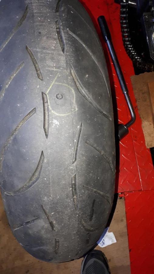

I went to wheel the bike out of the garage this morning and it felt heavy.
There was a screw in the rear tyre, and totally flat.
Plugged it for now, and checked it at lunch time and there's no leaks.

(30-09-19, 03:15 PM)darrsi link Wrote: [quote author=unfazed link=topic=6412.msg303021#msg303021 date=1569850249]
[/quote]Pumped it pushed it out of the garage pushed out the 600, pushed the 1000 back in and went off on the 600 to watch a car rally. Big Grin
Tyre is only 600 miles old, will take it off later and use a mushroom patch to fix it permanently.

(30-09-19, 03:15 PM)darrsi link Wrote: Plugged it for now, and checked it at lunch time and there's no leaks.
It's still worth getting it checked properly, there may be damage inside the carcass that you don't know about.

Mushroomed it, now to rebalance it and put it back on.
