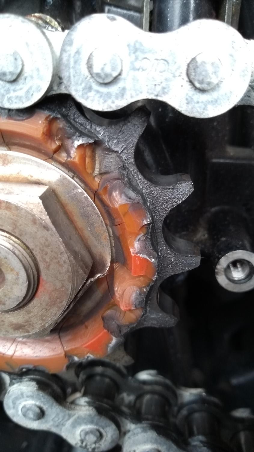

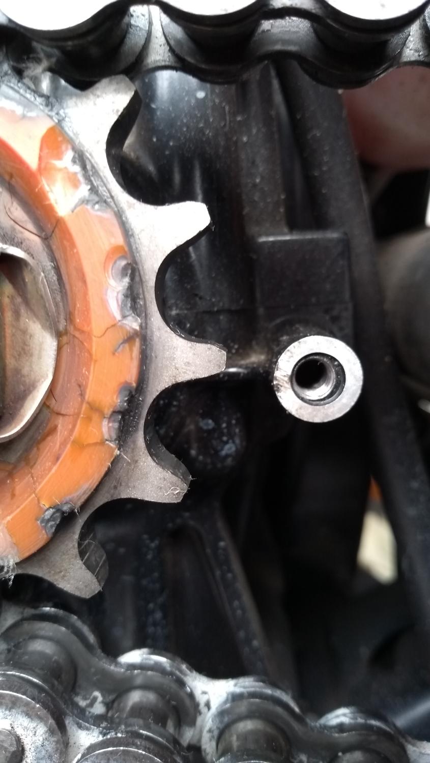

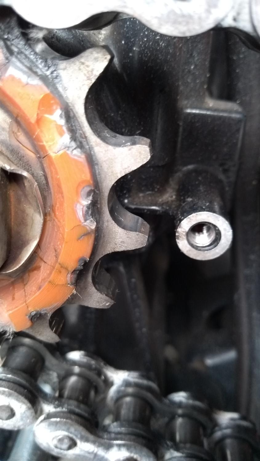

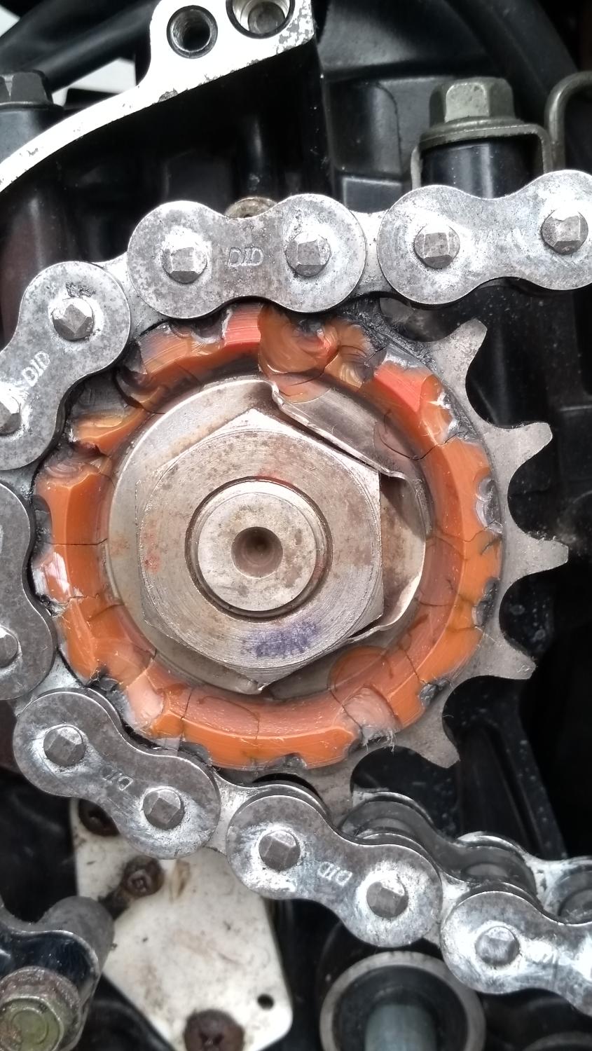

Had the cover off for some pictures and the metal looks fine to me but the plastic damper is really breaking up - bits of it stuck in the lube gunge.
