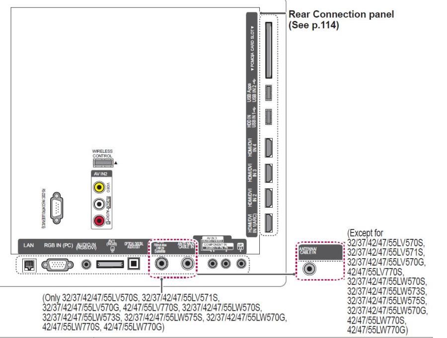

Re: Focer font of knowledge AV experts - fazersharp - 07-01-18
Although page 12 the manual shows the bottom section of inputs facing to the back they are infact pointing down like this the picture from the manaual below is what I have on my tv
[Image: index.php?action=dlattach;topic=23629.0;...1359;image]
This close up of the manual shows the AV 3 input in question and tells me it is aduid/ video and if you follow the arrow around it points to the socket I am using.

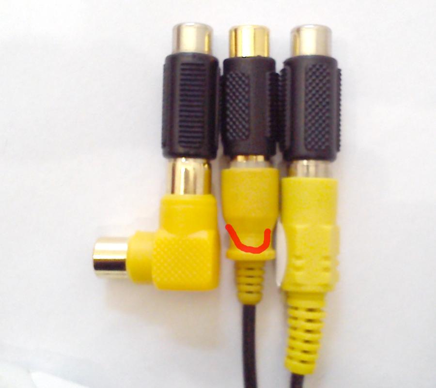

Re: Focer font of knowledge AV experts - fazersharp - 08-01-18
Here is some comparison pictures of a standard straight and 90 degree and the one I am actually using and still hits the tv mount I have plugged them into adapters to reproduce them being plugged into to tv socket so you can see side by side.
Yes shortest is the 90 degree but the one I am using is the middle one and I have paired back as much plastic as I dare down to the red mark and as that you can see that it is a lot shorter than a 90 degree adapter. Also the 90 degree adapter has quite a big and solid square block and the one I have paired down is to a thin point
Re: Focer font of knowledge AV experts - BBROWN1664 - 08-01-18
The final solution then will be to get a new tv bracket that gives more space for cables behind the TV :pokefun
